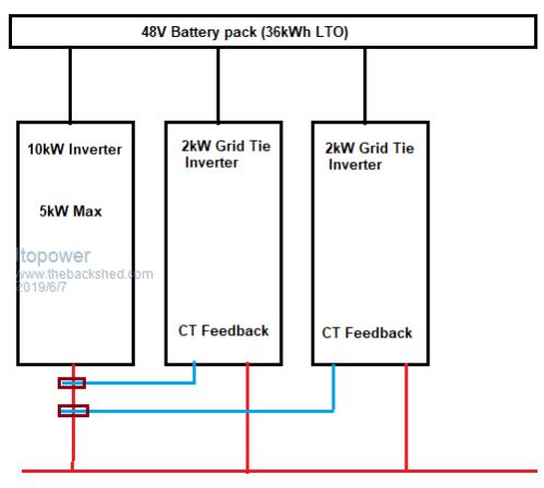

ltopower
Joined: 08/03/2019
Posts: 64
Posted: 05:24pm 06 Jun 2019
Wow, very impressed with the capacitor setup. I think it is the first home power pack I have seen with that many supercaps.
You say each is 350F and by the looks of it you have around 588 caps, so at 2.7V charge you have about 330Wh of capacity ?
What voltage range do you run the capacitors over ?
Another option for getting 10kW output is to use a standard inverter build and then attach one or more grid tie inverters that has a CT and feedback (typically used for a zero export setup)
So you end up with :
OZ Inverter --CT------------ House / demand
2kW Grid Tie Inverter ---|
The Oz would handle the initial switching load change and then the grid tie units would then add supply and back off the Oz Inverter to handle the faster changes.
This is the setup that I intend to have for the house, using a 10kW inverter to only ever supply 5kW and the other 2x2kW units providing an overall continuous capacity of 11kW.
ltopower
Joined: 08/03/2019
Posts: 64
Posted: 05:30pm 06 Jun 2019
Here is a rough outline.... the text did not qork quite as intended..
