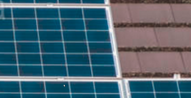

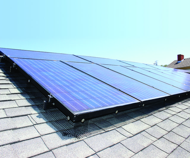

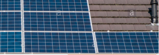

Boppa
Joined: 08/11/2016
Posts: 816
Posted: 03:22am 11 Jun 2019
If the panels are mounted 'vertical, they might be, but I have noticed many are mounted 'horizontally'- I suspect because they can use three rails per two rows of panels instead of four
They were like these
rather than like these (which your 1/3 &2/3 mounts are commonly used with) and do provide an air path between the panel and the rail
As the rail sits on the actual frames of the panels (one rail shares both the top and bottom panel edges, with several bolts between the two panels and a 'washer'/aluminium fitting on top of the two panels) there is no airpath over them, and at the ends you could feel a stream of distinctly hotter air coming from the lower edge of the rails
(here's a blurry closeup of the clamps between the panels, mouse pointer is pointing at one)
Edited by Boppa 2019-06-12
