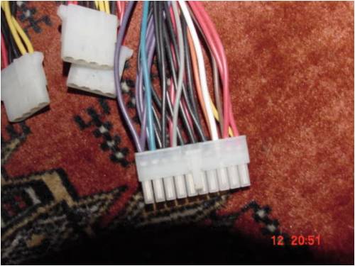

I'm lost. How come you people have green wires on your atx, and I dont?
mine looks like this:
The greenish looking wire is actually blue. On all of my atx ones the grey is the turn on wire.
Is your green in the same pin location? (forth from the left)? ie purple, blue,black,grey.......
mystified
........oztules

Different power supply manufacturers use different colour codes. When I was experimenting with modifying PC PSUs I quickly found out one can not rely on the colours of the wires. Clones, IBMs, Compaqs,... all seem to have slight differences to the colour coding.
The safest way is to open up the PSU and look at the printed descriptions on the circuit board as to what each colour wire does.
From memory, I think in your case the grey wire is on (or near) the location of the turn-on wire. It might however also be the white one. If in doubt google for the pinouts of the connector. The websites I've found in the past with the pinouts also gave colour-codings of the wire, but I quickly learned these were at best only applicable to some PSUs.
Even the +5 and +12V wires have different standards (rather: no standard ?). Most clones use yellow=+12V, red=+5V. But I've seen white and blue used for them too.

Thanks Dinges, I have no problem knowing what wires to use on the ones I have, but all 11 ATX I do have, all have the same wiring colours. not a green to be seen.
I was gobsmacked when everyone else has green and I didn't. Thought the island had been cut loose from the rest of the world.
Just to prove everyone else is correct and all my supplies are weird,
http://en.wikipedia.org/wiki/Computer_power_supply
clearly shows a green where my grey is. I have 4 violet, they have 1 etc etc. Mine are totally different.
anyway, now I know..... no more advice on which lead does what from me any more.
