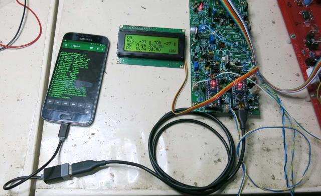

Also, be aware that connecting the laptop to nano2 and opening the Arduino terminal
will usually cause nano2 to reboot. This takes a few seconds before it can respond.
The LCD shows whats happening. I like using a laptop to do this comms since it is isolated from ground. Mark has found that using a PC, while that PC was powered by the running inverter can give poor results when setting the calibration values.
Ground loops probably.
When I am setting the calibration values or the temperature settings, I only connect to nano2 when the inverter is not running. Then once the terminal is up and I have the menu (press ? to get it) I start the inverter.

And since there can be ground loop issues, that upset calibration,
if you have an Android based phone, you can do this:
Use the phone as a terminal. This is isolated and so it is ideal
for accurate calibration.
Just get a $4 USB OTG cable to suit the phone. My Samsung Galaxy S7 needed
a micro USB type. The terminal app is free.
It works really well.

Now, to answer another question:
No, I do not reccommend you use the Android phone to program the nanos.
I have read poor reviews of the Android Arduino programmer software.
But, by all means use the terminal program and a USB On The Go cable to configure
already programmed nanos. I do this and it works perfectly.

When using the Android mobile phone and cable to connect, one thing to keep in mind is to ensure the terminal app is using the same baud rate as the nano expects.
Ensure the comms settings are 115200, 8 bits, no parity and 1 stop bit.
I use the app "Serial USB Terminal", by Kai Morich
