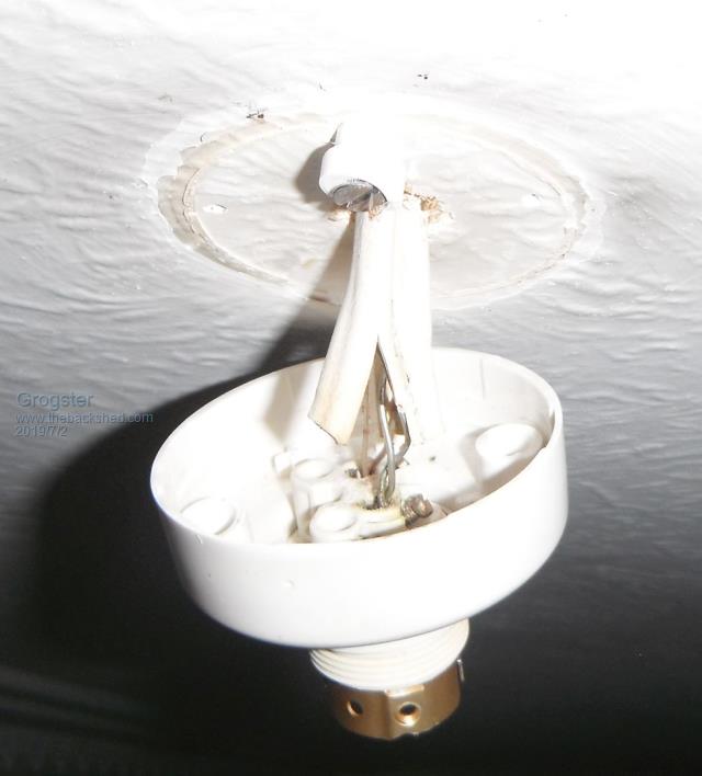

I pulled a ceiling rose off my house today to find out why it was loose - it was broken, but as I pulled the rose down a little, all the insulation fell off the cables, and the wires are now bare.
This house was built in the early 60's, and they have used that old rubber cable for most of the runs, so now not only do I have to replace the ceiling rose, but I have to replace the cable runs too. Grrrr.....
...and being a fuse-protected panel, there are only two fuses for the whole house, so this stuff has probably been looped @%#! everywhere....
Both lighting fuses will remain out until I can fix this, as I don't want bad cables and/or exposed live wiring floating around the place. I will have to make sure I bring in a few lamps I can run from the wall sockets for the next few nights!
Oh well. Win some, lose some. At least with it being my house, I can do the work myself and not have to pay an electrician. The outside light has the same issue, but I have been ignoring it. I will probably pull in a new feed to there too, so I can then fit it with a motion detector arrangement - I have been wanting to do that for a while, but was put off by the fact I knew I would have to pull in new cable.
I don't really want to think about all the 2.5 T&E feeding the various outlets that is probably also that rubber 1960's stuff.... I won't be pulling off any power outlets to find out at this stage.
At least if I fix the lighting runs, I can then have lights to see to fix the others if I need to. Priorities!

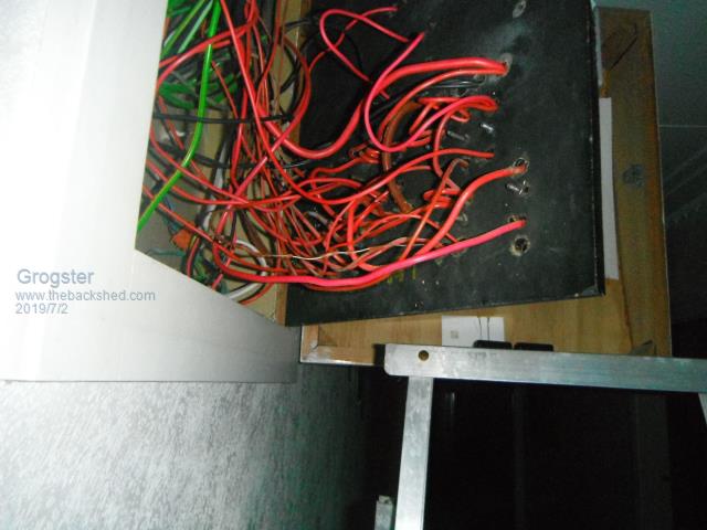

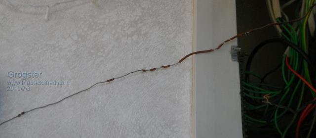

While tracing the cables tonight, I have found that they have looped it to all the lighting in the house, except the rear two rooms, which are on the 2nd fuse. The rear two rooms were added on when I was just a nipper(very young boy), so I guess they elected to put another fuse in for those rooms. I still remember dad building those extra rooms, but I was probably only 7-ish at the time.
Anyway, just gently bending the phase around in the back of the main panel to see where it was feed from, a whole heap of insulation fell off that wire too, so that is a completely bare phase now, so the main outgoing supply past the fuse will also have to be ripped out and replaced. I am toying with the idea of just rewiring the entire place - as mentioned, it can all be done in a day with a helper, and can all be fitted off the next day. Could do it all in a weekend.
They have used 1mm twin for all the lighting circuits. No earth circuit. You can still get plain old twin, but it costs more then 1mm T&E, so I will run that. My only concern is that if they have made the holes in the dwangs a little on the small side, trying to pull in multiple T&E cables might not fit thought the holes that were drilled way back when the house was being built. Hope not....
The old rubber cables will make excellent draw-wires to pull the new stuff in, so there is that!

Here is another image from the back of the main panel:
Note the red phase wire about the middle of the image, where all the insulation has broken off. This is the outgoing phase to the lighting circuit. Not good.
I suppose that TECHNICALLY, you would have to open this main panel to be exposed to this, but still..... Grogster is NOT happy. I will correct this.
In this installation, the incoming phase is on the top of the fuse carrier, and the outgoing(load) is on the lower wires. Has been like this since I was a nipper. So that means that the bare wire phase as shown in this photo is the outgoing(load) side of the fuse, and the fuses are removed at present, so it is...safe enough for now...
I will be replacing this feed and probably most of the others.

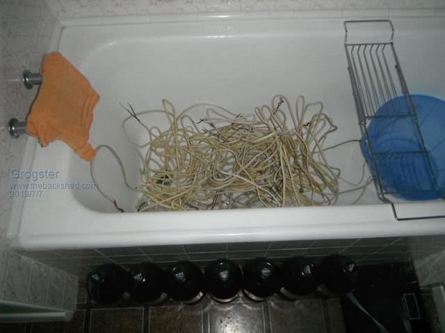

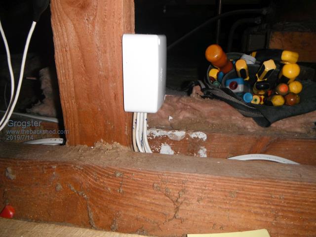

Here is the old cable, liberated from the switchboard:
Not really a lot of insulation left on that one......

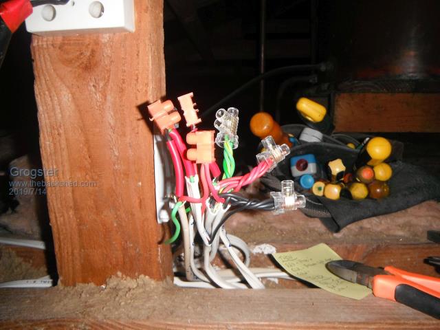

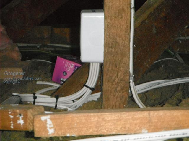

The work has started, and I have pulled in a few new cable runs today after work. It will take a while, as I can really only do this after work each day, with the exception of the weekend, when I could rally the troops.
EDIT: I have also elected to replace the old fuse carriers with MCB's for the two lighting circuits as I do this.Edited by Grogster 2019-07-04
