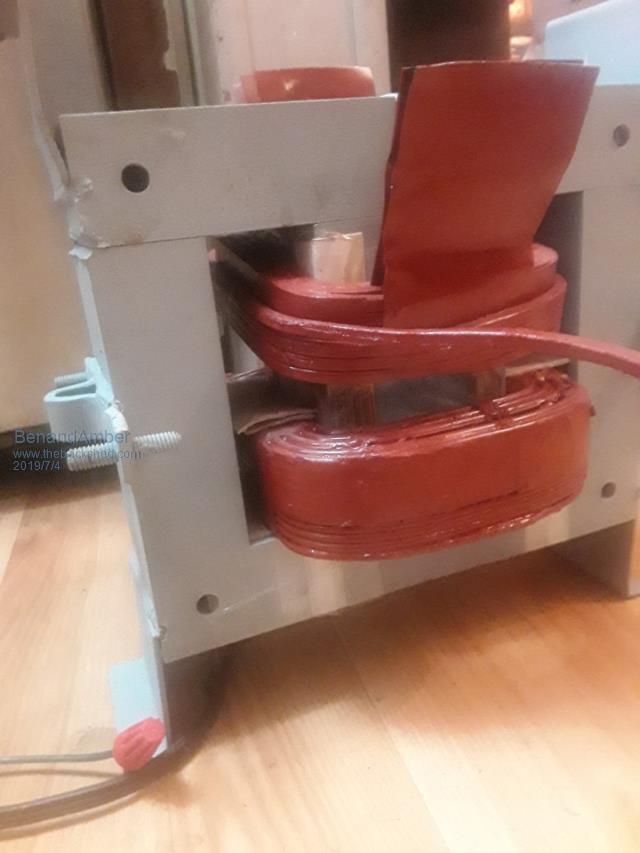

I am in need of a high amperage power supply
It would be much easier to use than to try to hook 4 batteries up in series to test inverters
It would be awesome to be able to control current of this power supply
Power supply would at least need to be able to put out 40 amps
And it would be nice if the power supply could give out different voltages so it would be more useful
This Transformer weighs almost 70 lb this is the Transformer
I would like to use to make a power supply
I will be rewinding the secondary lower voltage side so I can put in as many taps as necessary
I would really appreciate help on this
I know I'm not the only one that would like to have a high amperage Transformer based adjustable power supplyEdited by BenandAmber 2019-07-05

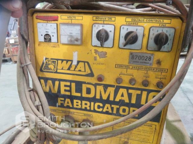

Try and find an old transformer MIG welder.
This is a picture from the internet, but you will see it has two switches that give 27 different primary voltage tappings on the transformer. Output voltages might as a guess be in the 16v to 55v dc range.

I'm pretty sure that this Transformer came out of an old stick welder
I have some big switches to switch two different taps of the Transformer
I was hoping I could build some kind of DC to DC to DC Buck converter to use on the output of this Transformer
And maybe have three or four different tabs four different voltages
that I could switch to make it closer to the voltage I would be needing and then Buck it on down to the exact voltage and current
Or you something like a High amperage dimmer circuit on the input of the Transformer and then have a really good filter on the output
If it is possible to do it that way
I still wouldn't have any way to control the current
If nothing else I would want to build a very smooth DC voltage output
that would be good for all devices no matter how sensitive
And then just put a bunch of TAPS for different voltages on the secondary
I know some of you are probably pulling your hair out
I'm trying to figure out the cheapest easiest best way with what I've already got laying aroundEdited by BenandAmber 2019-07-05

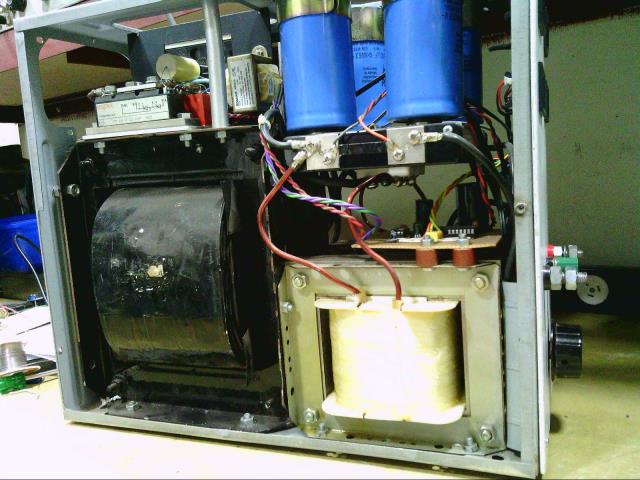

That is not so easy. For high amperage you will need very big capacitors to filter the ripple. Capacitors the size you saw in the picture of my warpinverter...
Before you get carried away and end up spending much money, build a smaller power supply and see the the effect of the capacitor at the output.
Of course, to *see* that you need an oscilloscope.
And then you need to know how to use an oscilloscope
Best stop dreaming about building big things and learn first how they work and how to use the equipment required to test them. You'll get nowhere without that knowledge, no matter how many questions you ask here.

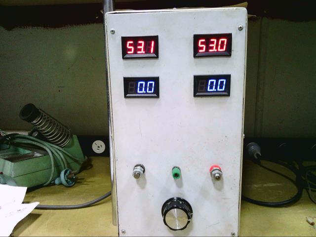

I have had a few goes at different times building really big dc power supplies, and none of them ended up being really nice or easy to use.
The simplest is probably just a big transformer, bridge rectifier, choke and electrolytics. Then adjust the voltage to the primary of the transformer either by phase control with a couple of SCRs, or better still a large variac.
No voltage regulation and no current limit. When overloaded it just pops the circuit breaker on the main power board.
I built it into an old computer case, zero to +/- 50v at about 20 amps continuous. Its ultra crude and very ugly, but can be useful sometimes for a bit of rough dc power.
