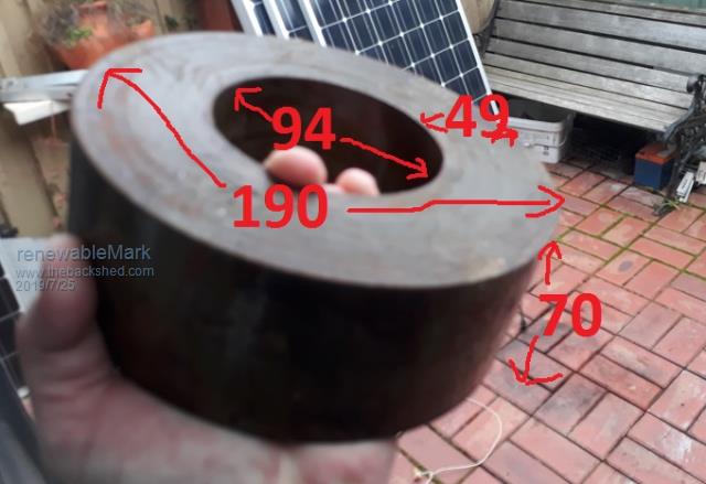

Hey guys,
my HF inverter in the van went pop so will build a small Mad power board run by the nano control board.
Highest load will be a small microwave, which is 1800w I think.
Would prefer not to have a start up procedure, just want to turn it on without the need to charge caps.
I have seen Poida's little bench one do that easily time and time again.
That unit has small caps on it though. Maybe it will need to have only 2 fitted?
Also the torroid will need to be wound differently to normal Ozinverters.
So blank canvas, any suggestions on how this should get wound?
Cheers Caveman Mark

So, I seem to remember the Ozinverter likes a nominal 16v primary for a battery voltage of 24v. ??
I would wonder if going for a low Flux density (1T at 16v) would result in a more reliable unit. Again ??
1T @ 16v
So I make that a turns ratio of 15
Np = 21 turns of 50mm2
Ns = 315 turns of 2.5mm2
1.4T @ 16v
Np = 15 turns of 50mm2
Ns = 225 turns of 2.5mm2
But I've never built a OzInverter so I'm probably wrong
Nice to see what others come up with.
Andrew
Posted: 02:17am 25 Jul 2019
Cross sectional area 49 x 70 = 34.3 cm sq
Using our trusty flux calculator
https://www.daycounter.com/Calculators/Max-Flux-Density-Calculator.phtml
230v
.00005 Mhz (four zeros)
300 turns
34.3 cm sq
Result 10,068 gauss (1.0068 Teslas in metric)
1800w = 230v x 7.8 amps
At 4amps per mm sq, we need 1.96mm sq wire
1.6mm diameter wire = 2.0mm sq, so 300 turns of that for our secondary.
Hole diameter 94mm circumference about 295mm
In theory 184 turns on first layer and 178 on second layer.
Should be possible to fit on 300 turns if you do two full laps of the core.
Primary would be 18 or 19 turns of 32mm sq, giving a ratio of about 16:1 which should work down to about 20v dc or so.
Posted: 02:28am 25 Jul 2019
Yup,
You beat me to the draw Andrew.
Slight differences I designed for 230v you for 240v
Primary turns depend on how low you plan to push your battery voltage.
Andrew prefers 1.8mm wire which is going to be better, and it should also fit better with two laps around the core.
Thicker primary would be better to, if it will fit.

Thanks guys, I do have a lot of 1.8mm that could be used.

Well that makes it easy with just one secondary, I'll have to mylar the crap out of it before overlapping.

It ended up using 1.8mm diameter, that's 2.5mm2, so good for 10amps.
That will be way more than enough as the van usually runs some CFL's and a small tv, occasional micro.
Thankfully it has a gas oven and cooktop and heating is with a diesel unit, so it will get a very easy life.
300 secondary windings and 19 primary
