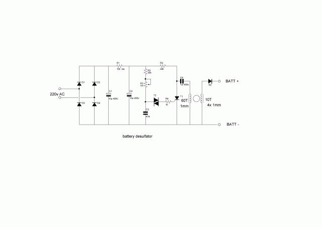

I have been playing around with battery desulfators for a while now with limited successes but i noticed that when you use AC power in series with a capacitor and diode it begins to work then reaches a sticking point, where the battery voltage stops climbing back up.
But if you lift one of the terminals and cause it to spark a few times all of a sudden the voltage climbs up again so i came up with the idea of using a strobe circuit where a capacitor discharges into a transformer from high voltage
to lower voltage high current into the battery so far looks good i am testing on a battery that had zero volts and is now at 4.6v will keep you posted.

Hi dom44,
First post. Welcome to the Forum.
Please tell me that you haven't got the negative of the rectified mains connected to the battery negative as shown in the diagram. (Unless of course, you are using an isolating transformer for the 220 VAC).
You need to have electrical isolation between the two.
Brian
ChopperP
dom44
Joined: 26/04/2017
Posts: 1
Posted: 12:15am 31 Jul 2019
my mistake you are right should not be connected
