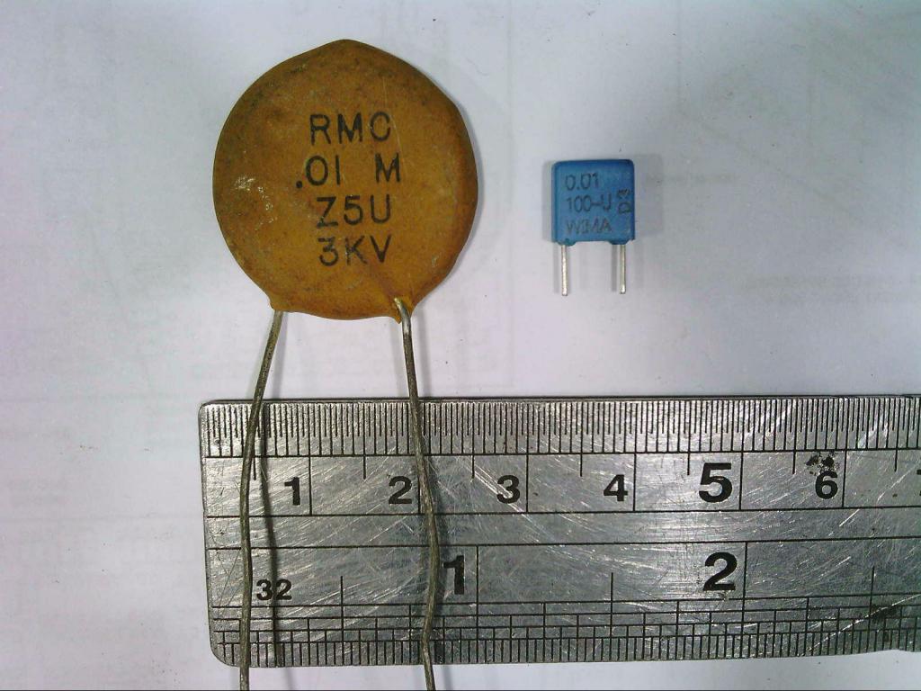

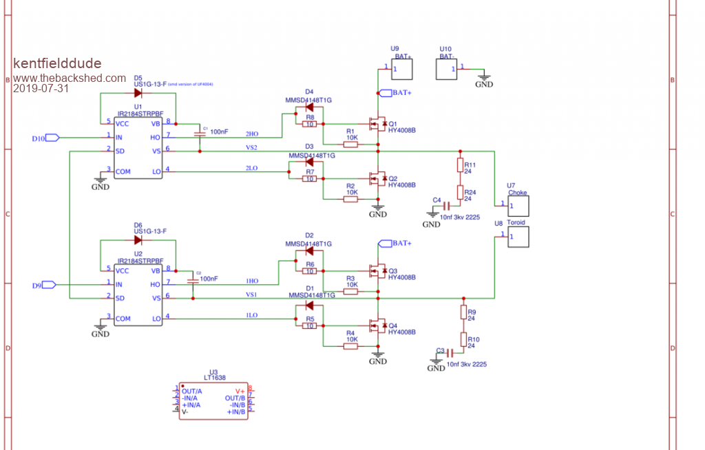

Hello. I am designing a small inverter for testing and experimentation. I have a few questions regarding the design. Do the 10nf snubber capacitors need to be rated at 3Kv? will 1Kv rating be okay?. Also I am not sure where the other two snubber assembly's go. I Still need to add the large caps and the Voltage feedback.

Snubbers for the inverter mosfets may not be required at all and if required are not generic in that as everyone's inverter is different then so would be the snubbers.
I would fire it up at a lower voltage and low power, then use a scope to look at the wave forms across each of the 4 mosfets for voltage spikes that would require snubbing.
See this article for calculating suitable values Snubber Calc

[quote]Do the 10nf snubber capacitors need to be rated at 3Kv? will 1Kv rating be okay?[/quote]
Just as Mike says, the snubbers are a kind of tuning tool to soak up any nasty switching spikes or ringing. Probably not needed, and the values will be determined experimentally.
The thing is, these snubber capacitors may have to carry fairly high peak currents, and so the type of capacitor is just as important as the actual value.
By specifying a 3Kv ceramic disc capacitor, it will be a quite large and robust capacitor having low dialectric losses and also capable of high peak current. It will never see anything like 3Kv, but it would be ideal for the job.
Something like a small rectangular 10nF 100v plastic dialectric cap would have the same capacitance, and probably sufficient voltage rating, but it will be a small fragile wimpy little part, and may fail fairly quickly if forced to carry very narrow current spikes of several amps repetitively in a very high power circuit.

Ok thanks. Can someone tell me where the two other snubbers should be connected

  kentfielddude said  Ok thanks. Can someone tell me where the two other snubbers should be connected
Source\Drain, all mosfets in the bridge.

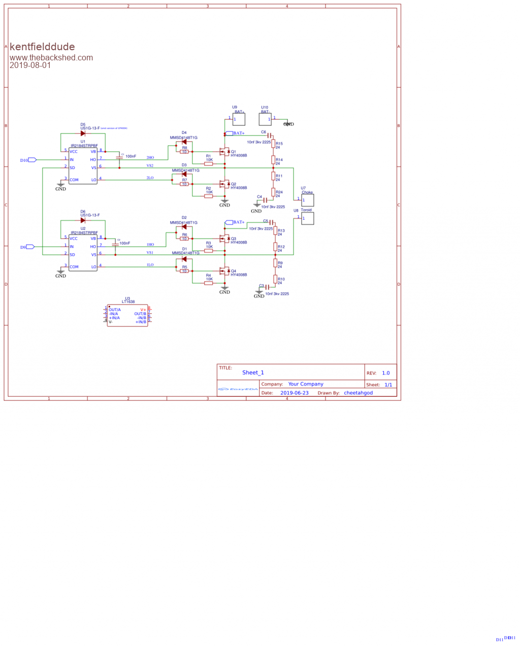

Like this?

Correct. only use if required.
Those Caps, C1, C2 will be too low a value, I would use 1 x 0.1uf chip ceramic parallel with a 10uf low esr electrolytic in their place, or if running the upper mosfets off isolated psu's use same 0.1uf chip ceramic parallel with a 1uf polypropylene cap.

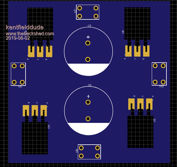

this is what I'm thinking the layout going to look like
Do you think 63V rating caps will be okay for a 48V inverter?

I can fit the 100v 10000uf caps so I will do that

Are you going to use heatsinks for the mosfets?
kentfielddude
Joined: 09/05/2019
Posts: 121
Posted: 08:26pm 01 Aug 2019
Yeah. Mosfet will sit slightly below the board on a heatsink
