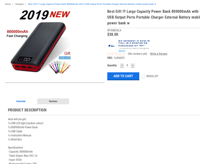

Not directly related to this thread, but why don't you buy one of these batteries instead, third of the price...
800Ahrs for only $38!!!
Bargain!!!!
Keep your UPS running for days!!!!
Edited 2019-10-08 20:52 by Boppa

Got to love Chinese marketing? advertising/ promotional complete and utter bullsh*t.
They love to attach big numbers to anything with absolute ZERO regard for their actual relevance to the product or truth.
There is SO much fake crap on fleabay it's beyond a joke.  18650 batteries are another one. Panasonic who is a leading manufacturer can only get about 3.8 I think it is Ah out of that size cell. Seen Chinese sellers advertising their cells as being 10 and 12 Ah.
Small portable stereos have enough power to out do a rock concert at Wembley stadium, Pocket torches have beams that would outdo the finest WWII searchlights, Small pumps can empty a swimming pool in minutes, petrol pumps could drain a major Dam in an hour and 80mm  computer fans in a housing you put on your air inlet in your car can give it 10PSI and 200Hp boostwhile getting 56% better fuel economy. OF course that fan is $129 Bucks!
Must be a lot of people on mind altering Drugs in china!
Or con men.
Edited 2019-10-09 00:40 by Davo99

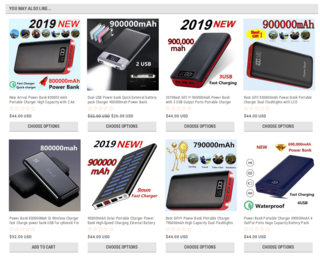

Even better- 900Ahrs!!!
Soon we will be able to run the entire world off a single USB powerbank!!!
