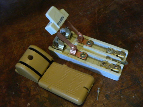

A lot of people seem to be using those old horror movie Knife Switches, big and open design, and look good too.
like this one from Otherpower.com:
http://www.forcefieldmagnets.com/catalog/product_info.php?cP ath=24&products_id=194
Here you would use one phase to both terminals on one end of the switch, and the other two phases to each of the two terminals at the other end. When the switch closes it shorts all three phases together, braking the mill. (wind permitting)
But remember, it must be installed between the windmill and the rectifier or molten metal will go everywhere it you try this across the batteries.
