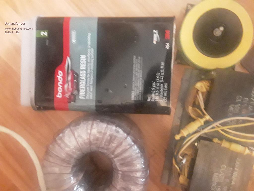

I use automotive clear fiberglass resin with the hardener that comes with it
I also use  fiberglass cloth along with it
I paid around 60 bucks for a gallon of it
I used it to epoxy Transformer core's together
I also use it over the wires on every layer
The chokes and Transformers I have made are completely silent
Although this has worked graet for me I would recommend you research it before you use it
I don't know the lifespan of the product and life expectancy with the heat of a transformer
I had already bought this for another project and had it on hand so I used it
I also used it after I epoxyed magnets on a rotor of a 3-phase motor
I would definitely recommend using the fiber glass cloth with it it gives it a lot more strength

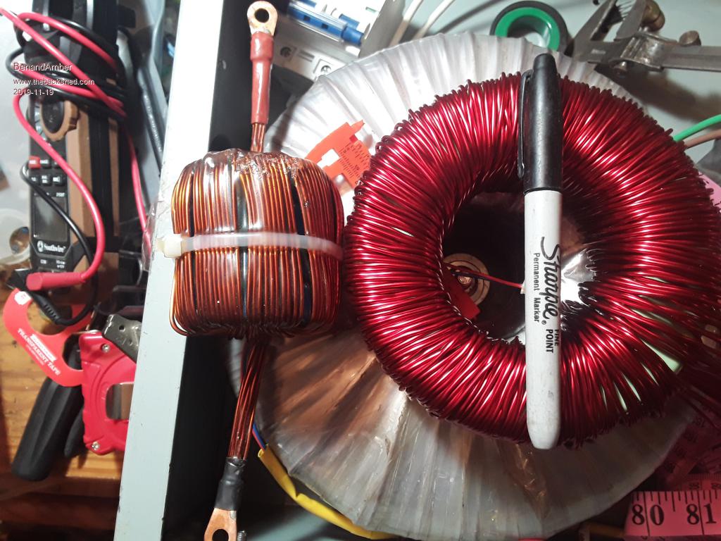

I epoxyed both of these chokes with this type of resin
Both are completely silent
The smaller one on the left shows you what they look like after being epoxied
The larger one on the right got epoxy before I used it in my big inverter
I do not use the fiberglass cloth when coating the wires
Only when bonding things together

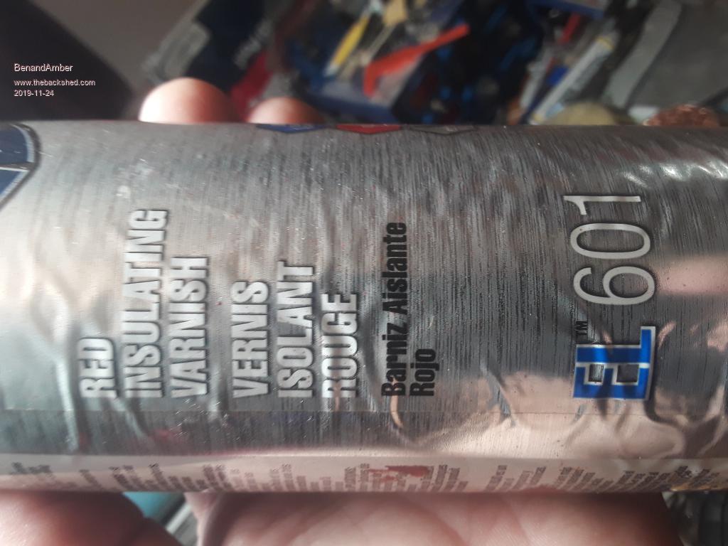

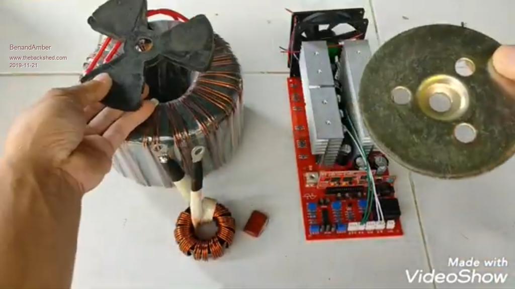

BenandAmber
Joined: 16/02/2019
Posts: 961
Posted: 05:23pm 20 Nov 2019
Seen this online thought it was a good idea
By the way after you fiberglass resin a Transformer I wouldn't think there would be any hope of getting it back apart
I honestly think you would be lucky to save the core
I haven't noticed any shrinking problems the one inverter has been running continuously for quite a few months now
But who knows a very legit concern

Thanks BenandAmber. The star shaped washer is what I had in mind  ...  3 or 4 fingers  ...  and cut the metal disc much the same. Will allow at least a bit more air through.
And then address the bottom in a similar fashion so can get some flow through. Will add more height to the assembly, but would be interesting to see how it compares temperature wise.
Regarding rewinding an already epoxied transformer  ...  I agree  ...  I think I'd cut my losses, hacksaw through the windings and start again.

BenandAmber
Joined: 16/02/2019
Posts: 961
Posted: 05:45pm 23 Nov 2019
New enamel wire is very expensive
if there's any way possible to save your old that's the best route to go
You can buy spray cans of the Transformer wire enamel
you can respray your own wire before you use it
I have one Transformer here that I used uncoated wire
sprayed it with the Transformer  wire enamel spray
then as I wrapped it brushed on the fiberglass resin
I honestly think it will last as long as I do

  BenandAmber said  New enamel wire is very expensive
One sees lots of good ideas here but, unfortunately, also bad ideas. The above post comes into the bad idea category IMO.
I have seen how the wire makers apply the enamel to the copper wire in a factory and, believe me, there is not a man standing next to a big spool of copper wire with a can of that above spray in his hand.
Instead, its a complicated arrangement of enamel baths and drying  ovens where the wire passes through from its bare copper stage to be fully enameled.
The above mentioned spray is intended to repair scratches on copper wire that is *already wound in place* It is *not* tough enough to withstand the mechanical stresses applied when winding the wire around a former or core.
Using that product to repair damaged wire, strung between trees as suggested in an earlier post, is very like using a can of spray on rubber to repair the thread on worn tires.
If you want to play Russian roulette - its your choice - but think about the consequences before recommending something quite unsuitable here.
