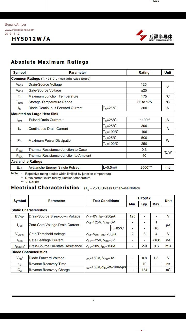

I just came across these mosfets
A few of you probably already checked these out
The reason I was looking was for those cheap little Chinese inverter boards
The ones that come with only four mosfets
The one that poida helped me with is still running perfect
These little boards are only thirty bucks on eBay
It would be nice to be able to up their output
I've even thought about putting two mosfet  in each single mosfet holes
I think this could be done by turning them around facing the opposite direction and putting them up through the bottom of the board
I don't know if this would work with only one resistor and diode for two mosfets
Thank all you guys in advance for your thoughts and discussions on this subject

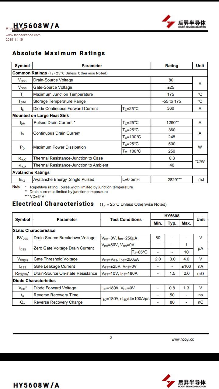

AU $22.42 | Aoweziic  2019+ 100% new imported original  HY5608W HY5608 TO-247 FET 80V 360A
https://s.click.aliexpress.com/e/ELtWNyNK
Costs about the same, and rds on is lower, not sure about current handling without real world use. But if datasheet is to go by, good alternative to hy4008s... didn't think that possible lol.

What do you think about putting two mosfets in the same holes
Second ones sticking out the back side of the board flipped in the other direction so the pens matchup
Do you think it would work  using the same resistor and diode for two mosfets
Those little boards are made in such a way it would be pretty easy to stick them in from the bottom and add a second heat sink

I think oztules stated earlier in one of his threads, 1 hy4008 per leg will do 2kw all day with a decent fan on it.. so it should be possible.  As for doubling them, try it .. im unsure of the technical side of things, but these things are tough...

Hi Ben, Paralleling your mosfets in the same holes may result in some minor explosions as the power is increased. Two gate inputs sharing a common drive resistor is not recommended, no way will they be matched enough to turn on evenly at the same time, the driver chip is going to get more stress switching the higher load capacitance of the combined gates. Circuit layout and drive becomes more critical as the number of parallel devices increase.
However by all means try it, get same branded mosfets of known spec if possible, bolt them in close proximity to each other on the same heat sink, so thermally they heat up at the same rate. Blow some cooling air over the driver chips.

Noneyabussiness thanks for your reply 2000 Watts with 4 mosfets
I knew the hy4008 could do it for short periods of time
Good information to know that thay can do it all day
What mosfet do you guys think would give  the most wattage and use only 4 mosfets
How does the hy5608 or others compared to the hy 4008
