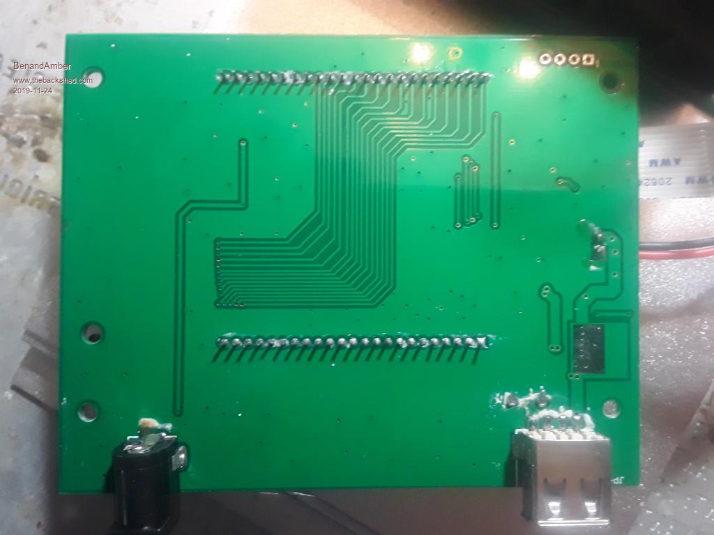

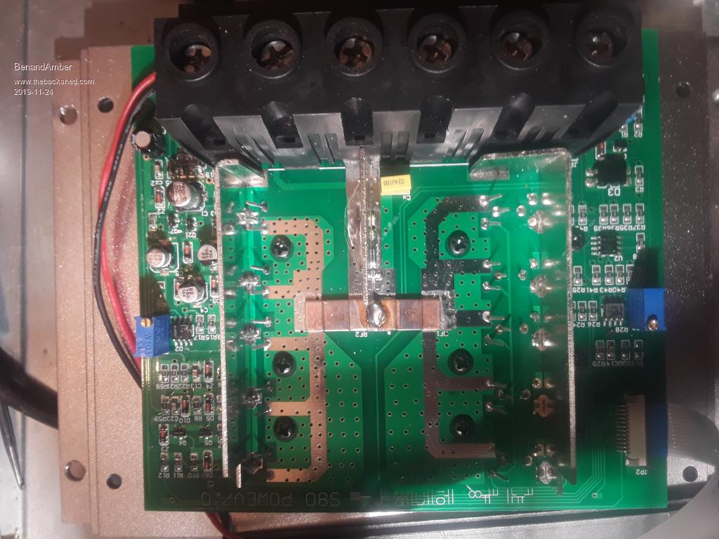

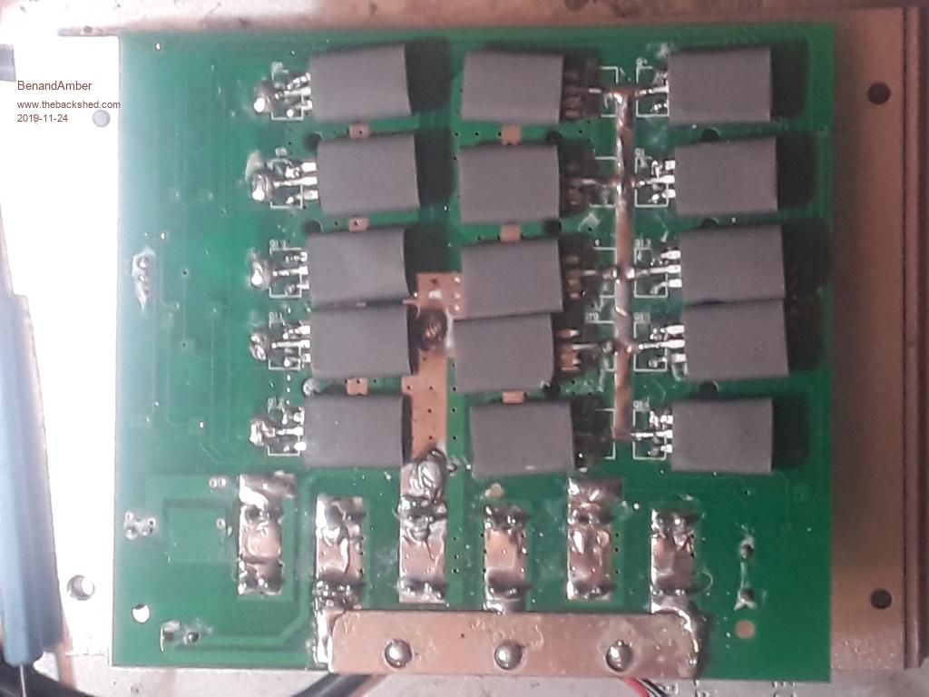

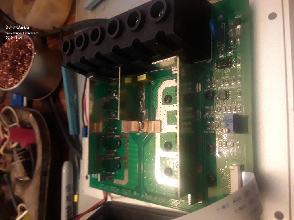

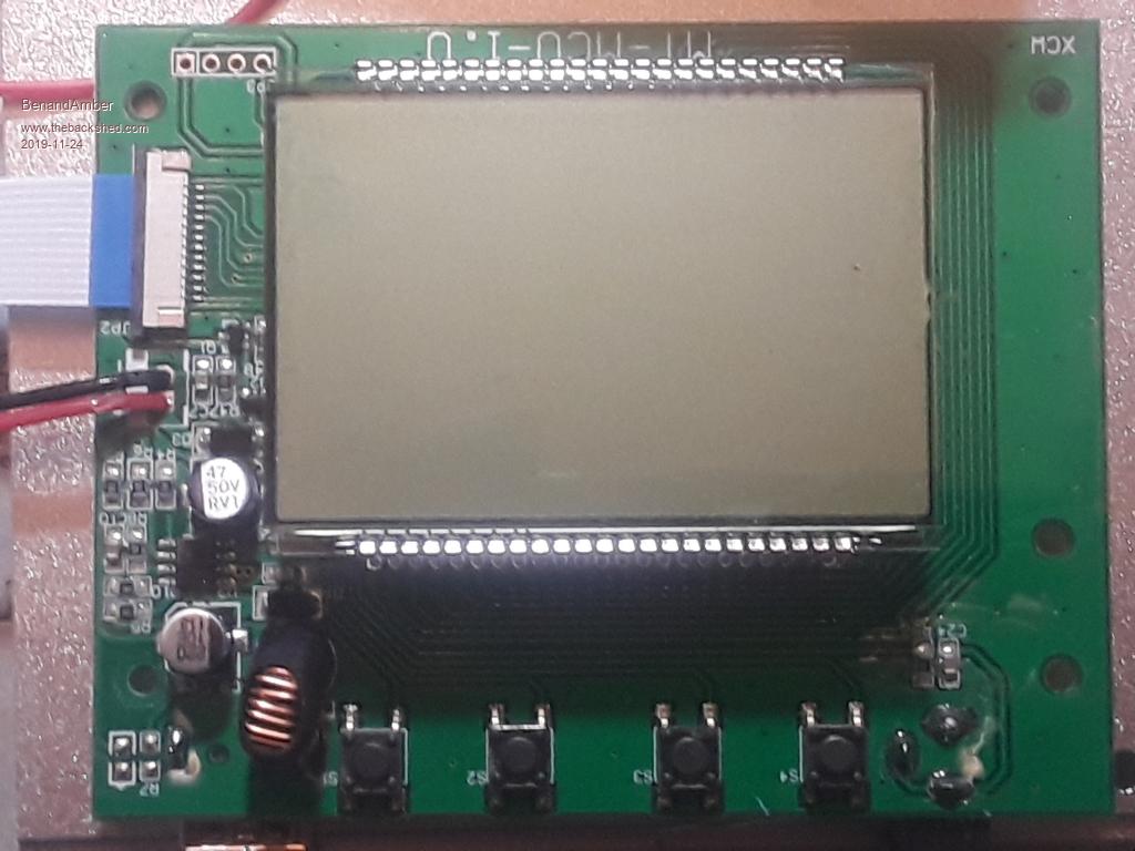

Curiosity got the best of me
I just had to take it apart
So all of you experts can pick it apart lol

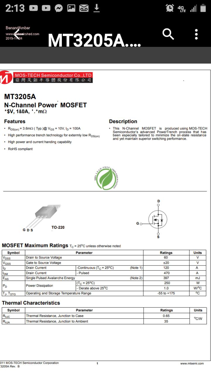

All 15 mosfets are the same mt3205a

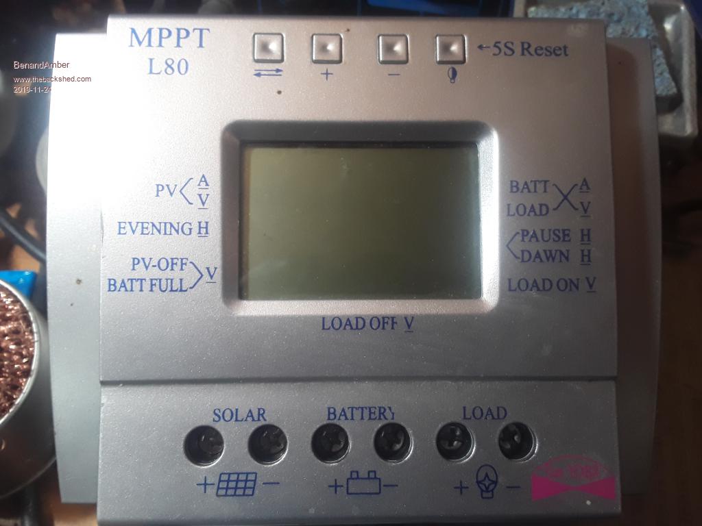

I purchased it off eBay it was on sale for around eighty bucks
I used it down at the bus for about a year
After that my buddy of mine used to it for about a year
The only real complaints I have are
not knowing the highest voltage solar panels that can be used
and it's a little bit complicated to program
I'm actually a little bit impressed with it
fake or not it doesn't really good job
Posted: 08:57pm 23 Nov 2019
The mosfets are rated for only 60v maximum, so that would probably be the highest open circuit panel voltage.

I didn't even know what MPPT was when I bought that charge controller
A friend of mine had a couple of solar panels for sale and needed the money so I bought them
Later I realized I needed to charge controller
Bought the one above and it's been working ever since
It said it was 80 amps but I've only used it on 300 watts of solar so who knows
