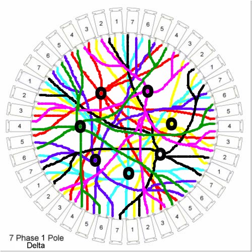

gill would u pls draw a 7p1pole delta
i donīt get it^^
Gill
Joined: 11/11/2006
Posts: 669
Posted: 01:07pm 07 Aug 2008

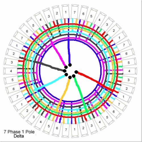

OK indextorslabor,
Here's the wiring you asked for. See I told you it would be a pretty picture. Well maybe not so pretty but certainly colourful.
At first it may just seem like a bunch of lines, but when looked at carefully, a pattern will emerge.
out 1 to in 3 makes phase a
out 3 to in 5 makes phase b
out 5 to in 7 makes phase c
out 7 to in 2 makes phase d
out 2 to in 4 makes phase e
out 4 to in 6 makes phase f
out 6 to in 1 makes phase g
See how you go with that.

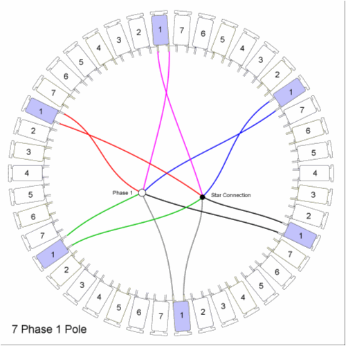

PS. Personally, I would not go with this arrangement because of the liklihood of high circulating harmonic currents. I would use Inde. This is where each pole number is independently rectified then parrelled with all the other phases DC. Use schottky diodes to minnimise the extra diode losses.
Gill EDIT:
This is the same thing but a more organised layout
Edited by Gill 2008-08-18

well actually itīs pretty simple, but i donīt really understand the polarisation of the poles?? to me it looks like the phases would shortcut itself because of the coils polarisation?? hmm however, i did not pay attention to the circulatin currents.. ur right, itīs not the best arrangement^^
i going to think it over again.
