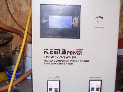

Hi dwyer, This one off eBay has been powering my house for the last 7 months, and apart from some chip creep, and a relay that wants to work its way out of its socket every now and again causing it to charge the batteries but not supply power to the ac side,all easy fixed, it has run well, it is also a charger, I have it set at 25 amp, but will go to 30 amp @48v
cost $1395 delivered to adelaide.
had one of those 24v 3500w "made for the military" lasted half a day, spat the dummy with a Weller 40w 240v soldering iron pluged in, lights go on but no power is there, pulled and replaced all 10 fuses, still no joy.
BTW, I have 4x4ft 38w fluro's running off the 48v inverter, condensers removed, with no problems.
