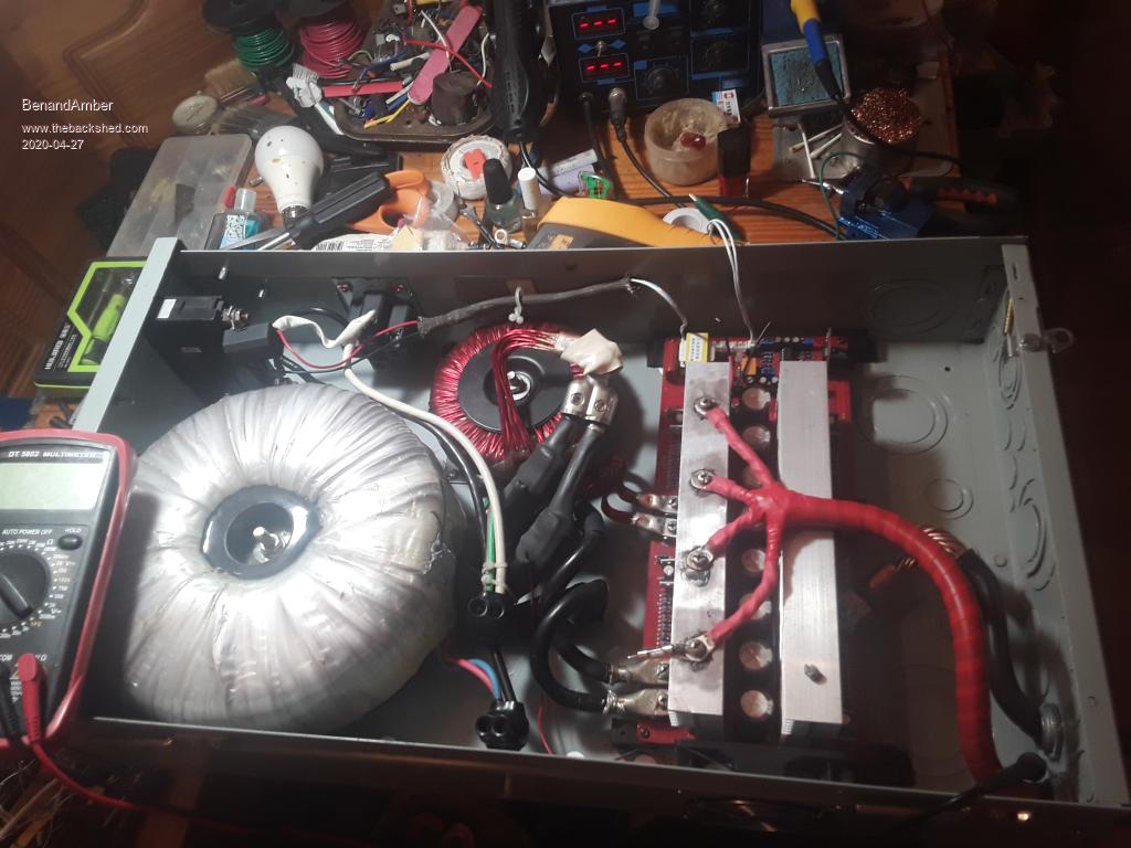

I would like to have Wi-Fi on my large china board inverter
It would be nice to be able to turn it off and on from my phone
I would also like to see battery voltage ac voltage and watts being used used

I have a powerjack inverter a could and probably will buy Sean's wi fi board for
I would like to be able to use the big China board inverter all you guys helped me with
I have dogs so I have to be able to  monitor my inverter when not at bus

Hi Ben,
I also think ubuntu is what will be best for you with an old laptop.
As for data/control of inverter over wifi...
If it was me, we would get a watt meter from china, that sends out pulses 1 pulse per watt hour. That will tell us the power the inverter is producing.
And an ESP32 based microcontroller. Now we have wifi and the Arduino software can program it.
hook up the inverter output through the watt meter, two wires to the ESP32 and give it 5V power.
Switching on/off of the inverter will be done with a MOSFET, driven by the 3.3V logic output of the ESP32. The inverter on/off is a 12V DC input, referenced to battery ground (negative) Any logic level MOSFET will do.
The software will count the watt meter pulses and record how many per minute.
This will give us power output and we can keep a running total of this and get energy delivered too. One digital output will control the inverter on/off.
There is plenty of memory in the ESP32 for a simple web based interface, to be accessed by the mobile phone. (both the ESP32 AND the phone need to be connected to a wifi modem or something)
