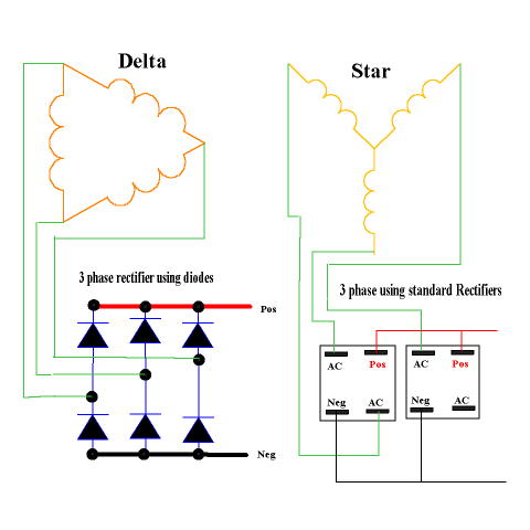

Yes you can use the bridges as rectifiers or spend a few dollars on some 35A 350v bridges. They are a little more solid than the dinky ones in your current controller. Use heat sinks (modest for your requirements, but still necessary.
Either way connect up as they currently are, or like this (from windstuffnow.com)
That takes care of getting it charging. Now we need a diversion controller like this oatley controller and then a dump load for it to drive ... say 8 x 50w car headlights connected in series/parallel for 24v.

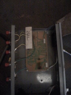

Your photo's of the innards were blurry, but you seemed to have shown a cooked resistor (probably the load sense resistor) and some blurry diodes, and a cooked relay.
Could you get a pic of the whole board and innards, maybe Gordon will recognise the topology and we can move forward from there.

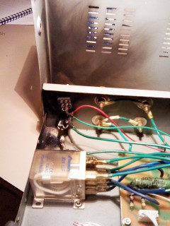

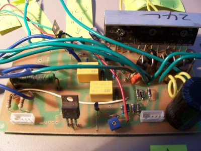

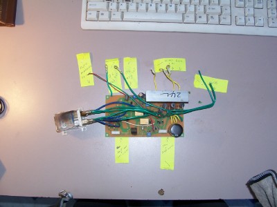

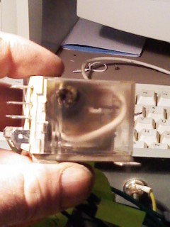

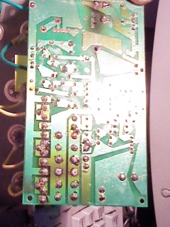

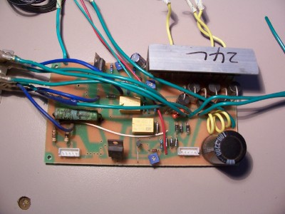

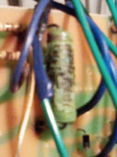

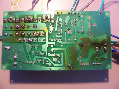

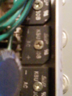

Hi Oztules and Gordon, here is a few clearer (I hope ) photos. I had a look at the Oatley ones and I think I could put one of them together... at a pinch..
the mill had " FD500" on the side of it
the square yellow things are "hrs1h-s-dc24v 1a 120vac 1a 24vdc"
the big cap is "100v 2200uf(m)"
the six round things are"6A10 hch"
the small blue cap at the back is"35v 220 uf"
the three rectifirers are"kbu808"
the three transistors are" 2n 5551 b998" the front one has had it's face blown off
the orange resistor is" 1uf j 63mkt"
the front 3 leled thing is " .013 AN7824"
the other 3 leged thing at the rear left is" nec 2p4m p92"
I can't read anything on the large green resistor
the relay is " asiaon jqx-12f 30A-AC power relay" and has dc24v on the coil inside
if you need to know colors of resistors etc let me know.

The board if fixable. So far it looks to be a voltage regulator, perhaps some diodes (6a10's have been hot) a 160v npn tranny and damaged/dead load resistor that provides the power to the voltage regulator.
There are no exotic parts on this thing.
I would have a better idea how it worked if I could read those carefully done tags that show where the wires come and go to, but never mind.
I would probably go for 2 or 3 of the big 35A rectifiers rather than the oatley 3 ph rectifier. Bit expensive for my taste. Like I say, you are only rectifying small currents (comparatively).
If the bridges in the unit are ok, you can use them as is. Just get rid of the 6A10's, and you can hook up to the dc there to the batteries. (perhaps cut the track to the yellow 24v relay to isolate the whole lot... but new 35A 350-400v ones would still be better.

I did what you said, and took out the yellow relay, and while the iron was hot, took the rest of the stuff off too,What should I have left in?
As is, it put out 30v and with a little more wind, went to 53v, no load. I will do some more testing tomorrow,
""Murphy's law No 231543, when you want to test a wind gen the wind will drop to nothing after the first test, just so you know it is working, but do not how good or bad the output is ""

Looks like you have a functioning bridge to drive the batteries. The batteries will pull it's voltage down to 24-30v depending on the state of charge.
It will operate no differently than before until it gets up to a certain power level, before it probably tried to limit it, now it will go toward charging the batts and later to be dumped in your soon to be built dump load if over 29? volts... depends on your operating parameters you set on the Ghurd controller.
At least you can put some amps into the batteries (if you manually look after them.) When charged up, short the mill in a lull in the breeze to kill it...until you decide to fire it up again... h
Hopefully the Ghurds controller will turn up quickly.
It will give you time to fashion a dump load anyway.
The second Ghurd controller could probably be fashioned to make the generator start up at some per-determined voltage. and the dump load could turn it off.
Possibly the intervening time could be used to get the furling to work properly and early enough to make this a reliable system.
........oztulesEdited by oztules 2008-08-13

Thanks for all the help oztules, where would I solder the dinkey little amp and volt meters onto the board so I can get some idea what is going on?

Grolly,
Trying to look at your board, I have a suspicion that the amp meter has a shunt across it in the form of that yellow loop of wire. So, the dc pos going to the battery needs to be cut, and the meter put in series with this line with the yellow shunt directly "shorting" across the meter. The meter will read the tiny voltage drop across the yellow shunt (coil).
At least that is how it appears. The volt meter just goes in parallel with the battery lines ie across the b+ b- .
Will draw a diagram if this is not clear. An off the shelf amp meter would likely not need the shunt.
Do not put your amp meter in series without the shunt as it will cook it in seconds... if it works as I suspect.
Looking at the pics again, the skinny wires support this theory.
