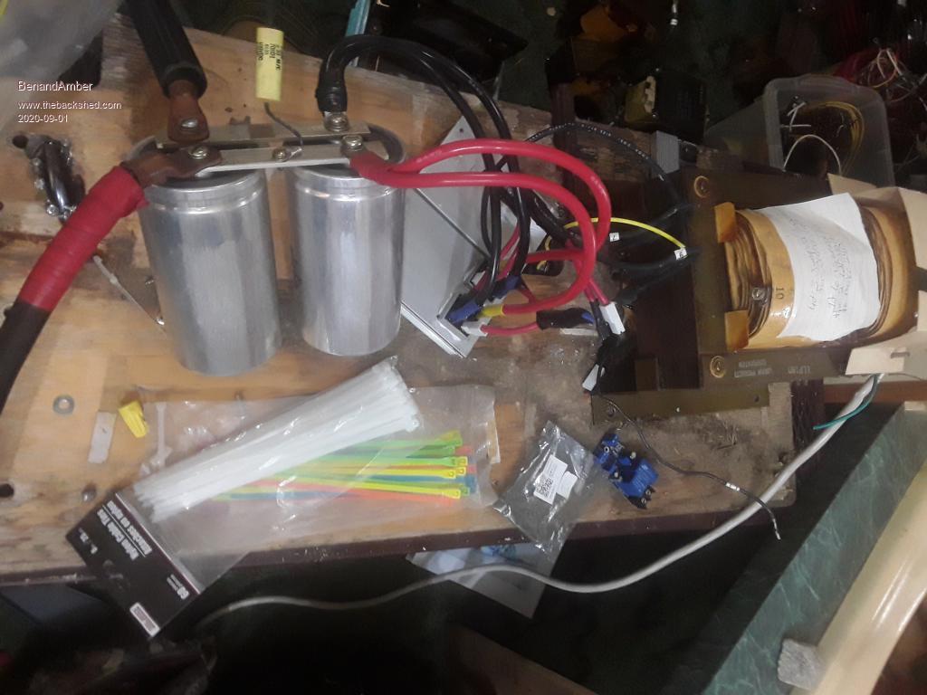

I have also wound another Transformer after the farm inverter Transformer
It is a very ugly experimental Transformer
It is 120/240 volt secondary 32/64 volt primary
The core is close the size as a power Jack as4
I have used alot bigger wire than the as4
I was told by Sid that most of the heat in the power Jack tranformer was in the wire
So big wire on smaller core I will be testing the pefomance of it very soon
I have a gut filling a few of the people on this form can tell the results before testing
It would be nice to know what to expect

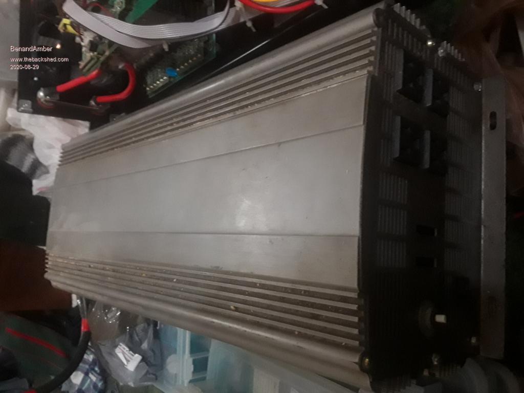

Had to clean the dust and wood chips out off the first inverter
Its idle current is 0.29 on the 48 volt battery side
I am really happy with it

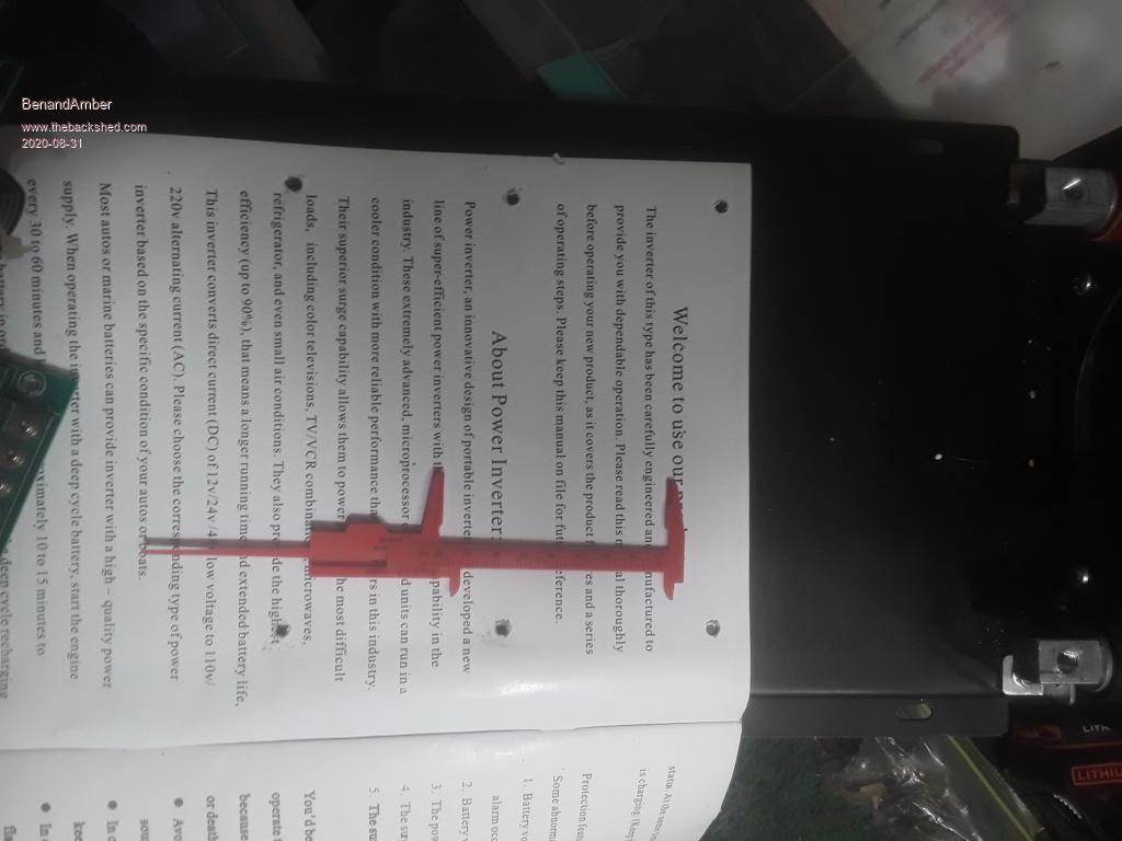

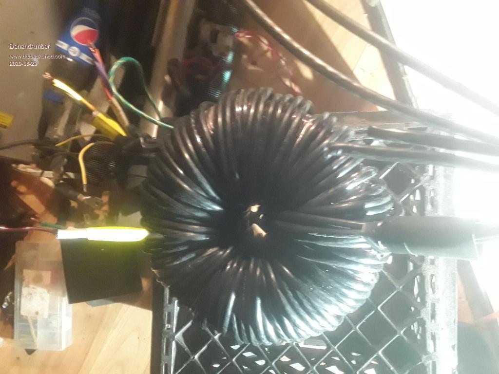

I bet I am the first person to find a use for a power Jack manual
My experimental Transformer primary wires
I put the current toroid there so when I solder leads on the secondary I won't forget to slide it on
I am going to have to put hood scoops on both sides the tranny is a little to be

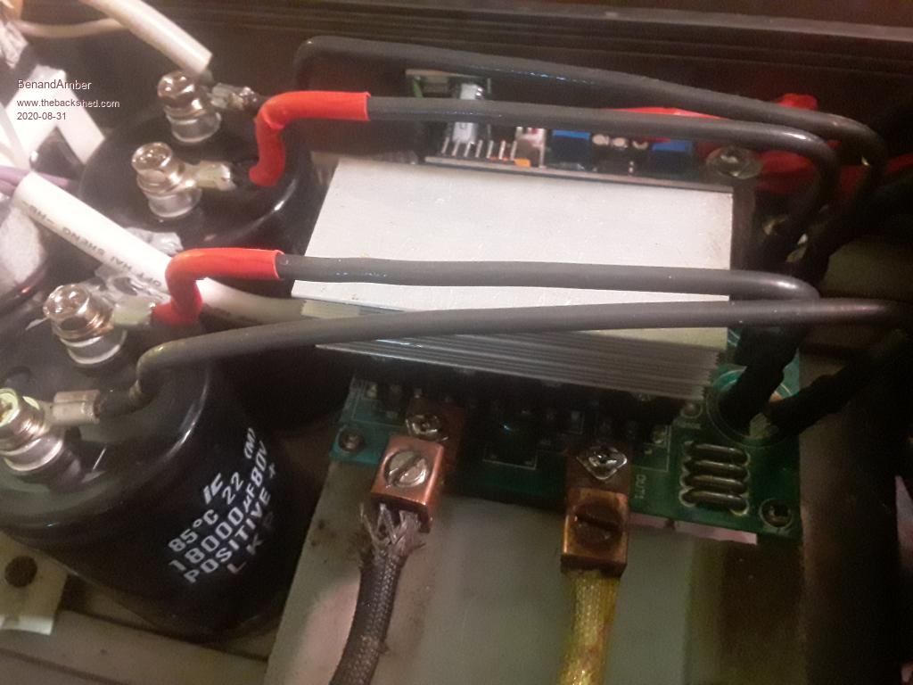

Joined: 31/12/2016
Posts: 1309
Posted: 12:07pm 31 Aug 2020

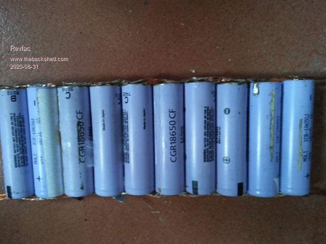

This is a set of 10, there would be 13 sets like this, I did them this way so I could stack them up depending on how many are available.
They should have wire strip spot welded joining them together, I soldered copper wire on to all of them and that apparently is a bad thing to do, I'm a dumb arse and Didn't know at the time, after doing this on over 2000 cells its never being any problem.

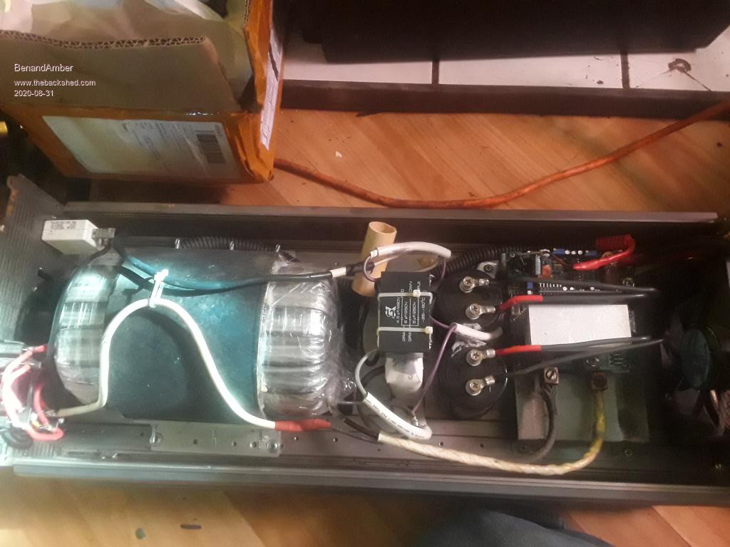

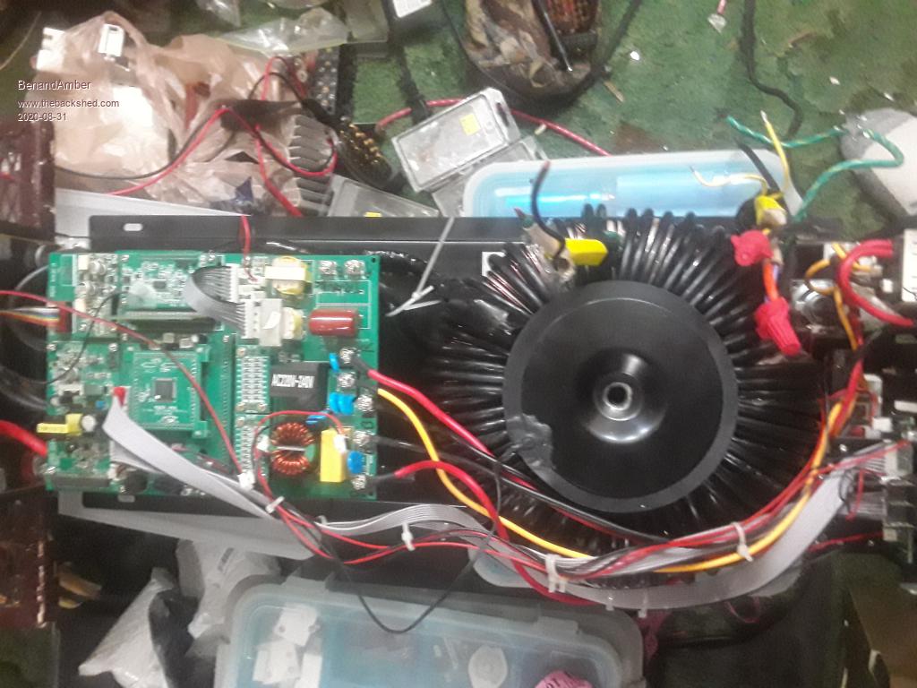

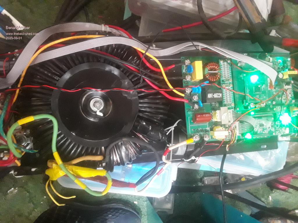

This is that power supply I made no box yet
It can be wired for 120 or 240 volts it can put out 40 or 50 amps on 240
I have a little adjustable turn off board
for it also to use it as battery charger
It breaks one side of circuit on the high side
Here it is powering the experimental tranny in the power Jack
I have to build a good choke idle current is over two and a half amps
