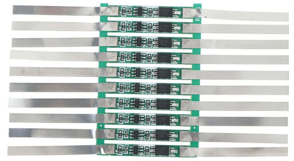

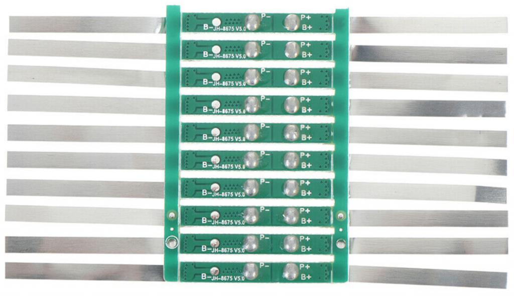

These are the protection strips I have
As you can see there are 2 nickel straps that go to the batteries one neg pole the other pos pole, one strip per battery,
I intend to fit one to each battery then link all the P- pads together and the B+ pads and use this as my bank so higher capacity but still nom. 3.7v.

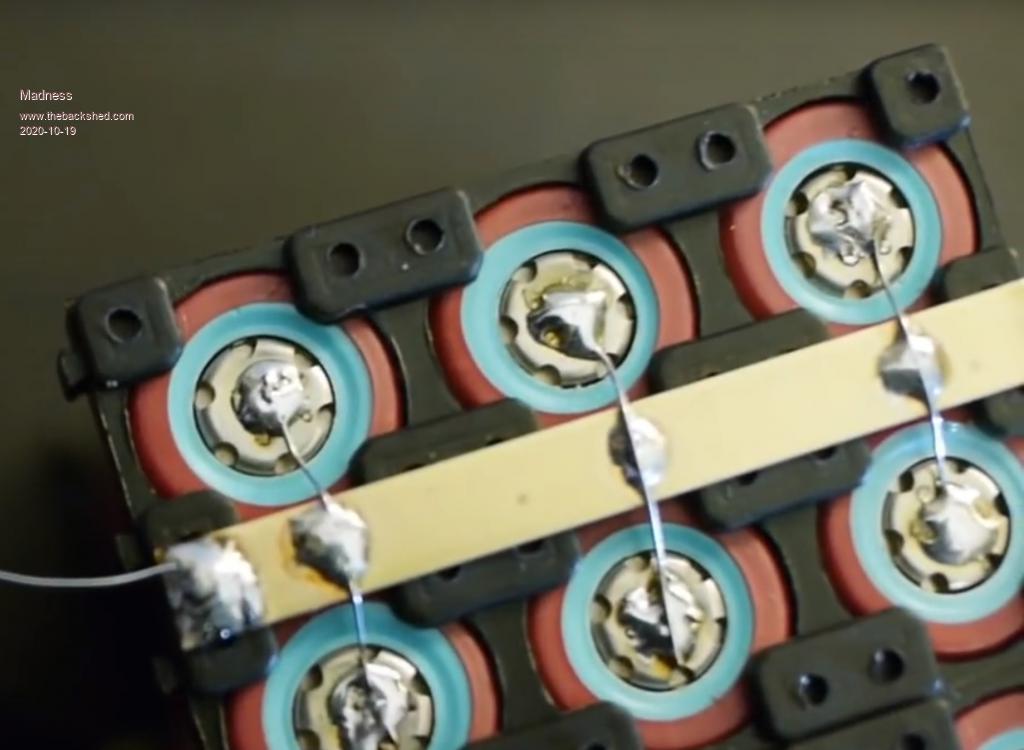

The way Tesla and many others are doing it is to fuse each cell, if one goes bad you don't have a fire risk.
