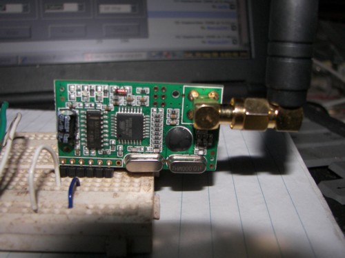

Having lots of fun playing with the new acquisitions. They are two data transceivers I bought for my current mill project. The mill is a little over complex and will need a lot of tuning. I don't fancy waiting for the wind to drop, raising and lowering the crank up tower just to reprogramme the picaxes only to wait for wind again. I've played with transmitters and receivers before (see old posts) but was one way data only. Enter the new kid on the block, Hope RF's HM-TR as distributed by MicroZed.
It transmits and receives, so now I can do the reprogramming without having to go outside. With that done, I then receive all masthead data for logging the effect of the changes. What a breeze!

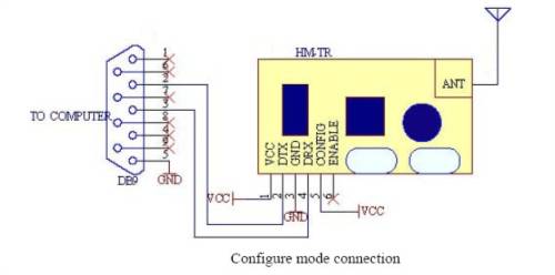

Unlike other RF gear, this one wires up direct to the RS232 and doesn't need a picaxe at the computer. No interfacing or special coding, what goes in, comes out.
Range is 300 odd meters and that's with some obstructions. I understand others have got much further. I suits all picaxe so is great for windmill experiments and data logging especially from above the slip rings.
At a bargin $45 it sure has solved a major concern for me, so thought to pass the word around about the latest and greatest.

Looks like a very nice module, and well priced considering
its specs. I can see myself getting a few of those.
I take it that in configure mode you install a bit of
software and configure the data settings. Should be a
mostly once off thing though I would expect.

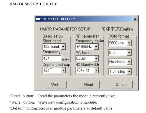

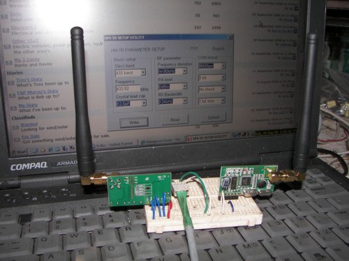

Yeh sPuDd, that's it.
Download the little .exe file from the Hope RF site, set the module to configure and run the software.
Here's a pic of the config utility for the type of settings to play with.
I just run default except baud rate @ 1200(picaxe output rate). No need to fix something that is working fine. Like you say, once setup there's no need for the utility again.

I had a few problems with my modules at first. I would turn them off and when I turned them on again no go.
Check them with the setup program and most times the baud rate had changed reset them and away they would go.
Have not come to any conclusions except I dont them turn off unless they are in an idle state.

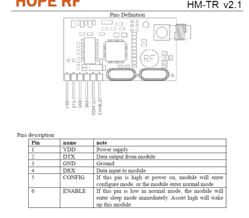

My first reaction was that you'd left the config pin floating instead of tying to 0v but I read in the picaxe forum where that was not the case. Certainly something to look out for. Let's hope it's a one off problem.

Yes, a lot of scope with these units, seemingly endless possabilities. The module has a MAX232 built in so even better. How about one day posting some HomeGrown PIC projects to inspire us?
