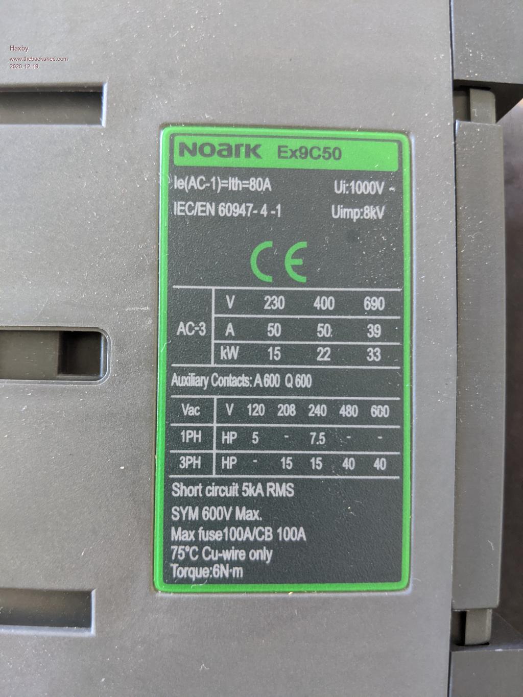

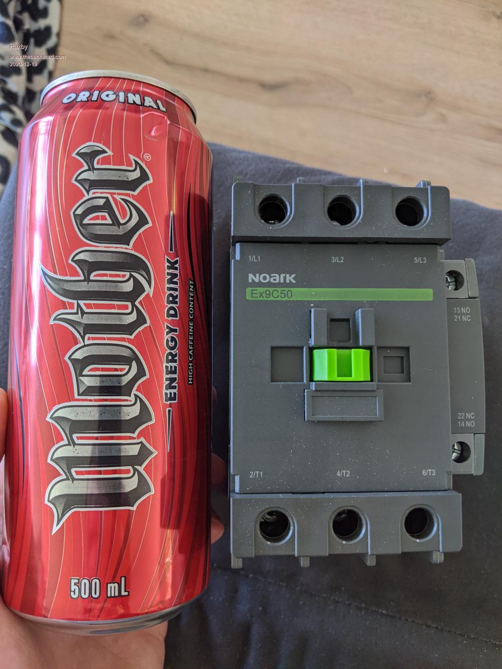

Hi all,
I bought a few of these beefy 3 phase contactors for peanuts when rockby electronics were liquidating them.
I don't have a specific purpose for them yet but was wondering if they would be ok to switch DC despite not being rated for DC.
I'd imagine the distance between the open contacts would be the deciding factor to work out a derated DC voltage rating. Any other thoughts?

I was taught the rule was a 240vac contactor was ok for 50vdc. It depends on the source and load. I've had 240vac rated relays vaporize the contacts when used on a 50v solar panel and a 50v water heater element. Closing the contacts isn't the problem, its opening them.
It depends on the voltage across the contacts when opened. If its a solar panel charging a 50v battery bank, the open circuit voltage of the panel may be 70 volts, so you only have 20v across the contacts, which would be fine. But the same panel on a water heater element will see 70v across the opened contacts, enough to establish a arc.

You could wire each of the 3 breaker lines in series and give it a whirl, then you have 3 times the gap and less likely for 3 arcs to start? I have seen a 30A 600VAC rated switch continue to pass current when it interrupted 10A at 120VDC (it would have been glowing in the dark) once the arc starts you have a little plasma fireball & they are hard to extinguish.

Have to agree with Glenn.  50v dc should be fine, as long as there are no big inrush currents when closing, and opening should be fine too as long as there is negligible series inductance.
It starts to get hairy around 100v, even with dc rated circuit breakers. If there is a big splat charging electrolytics on closing for example, welded contacts will almost certainly result. Maybe not the very first time, but it will happen.
Anything higher can be really terrifying with mechanical contacts.
Just bear in mind that continuous arc welders operate in the 15v to 45v range, dc and ac.

A general rule of thumb that has worked well for me over the years is that an AC switch can safely interrupt the rated switch current up to around 30 VDC. Beyond 30 volts, start de-rating. At 48 volts I'd trust a contact rated at 20 amps AC to handle 12 amps or so.
With a 3 pole contractor, putting the poles in series I would trust it to do the full amp rating. The arc voltage will be 1/3, which puts each arc lower than the original rule of thumb voltage of 30 VDC. External RC snubbers also help a ton.
