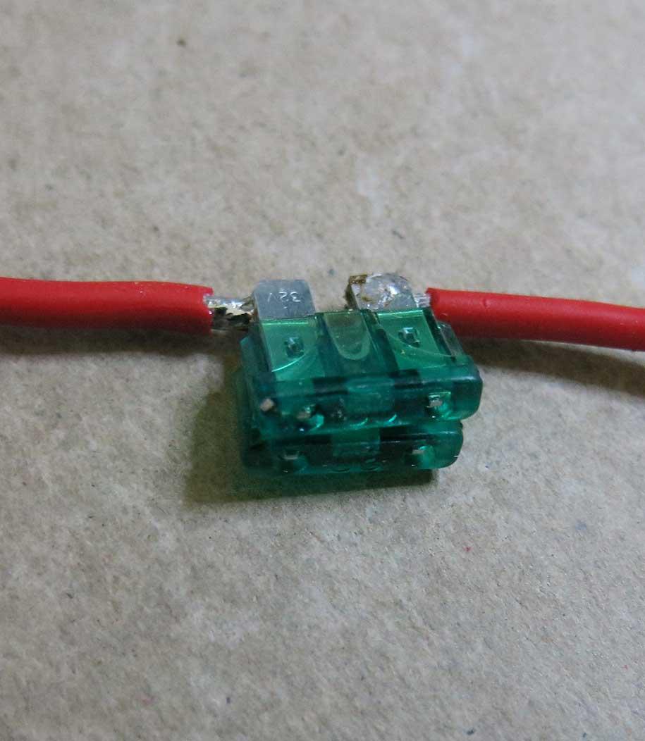

With the building of the mppt controller, I needed an easy to make 60A fuse
to be placed on the output or battery connection.
The fuse is to protect and isolate things should the mppt MOSFETs used as
diodes and/or the MOSFET switches fail and go short circuit.
This is what it looks like.
I should use some prepackaged solution but I like DIY.
I suppose I should be using one of these holders with a 60A version of this fuse
I like to use what I have got already at hand if possible.
2 x 30A fuses
two of these for $2.20 a pair
I tested it, shorted directly via 4.5mm2 cable from my
spare battery bank (4 x 12V 200Ah in series, charged to about 56V)
link to the video of the test
https://youtu.be/1DI3nSb-BqQ
It was quite loud when I made contact.
It stayed open and did not continue to arc.
This is all I want.
I do not think I need to protect short circuit on the input. The panels can handle
short circuit for long periods and if the battery is hooked up direct to the panels
via failed MOSFETs then no problem? The panels I have use diodes that prevent reverse current flow. Overcharged battery is then a problem though.

I love it. Could have used female spade terminals to make them swappable. As these are rated at 32 volts, they might fail catastrophically at 48+ V. Maybe use four in a series/parallel setup just in case?

Rev, lots of the little fuse holders get hot as they don't seem to connect very well with the fuse, sometimes they work ok if you crimp them down so they grab a little harder.
In the past I even paired up some small auto ones, but they still melt, fk'n useless.
I gave up with the little holders, they always melt.
I switched to the maxi type fuse holder, they are about 4 times the size and never get hot and melt plastic all over, also no fire hazard.
link
That's what I use in the battery box in the ute.
On the fixed system at home I use the ANL type, they don't cost much from foo man shoo, they are all made there anyway.
link
But your one Poida will be just fine with a bit of tape around it.

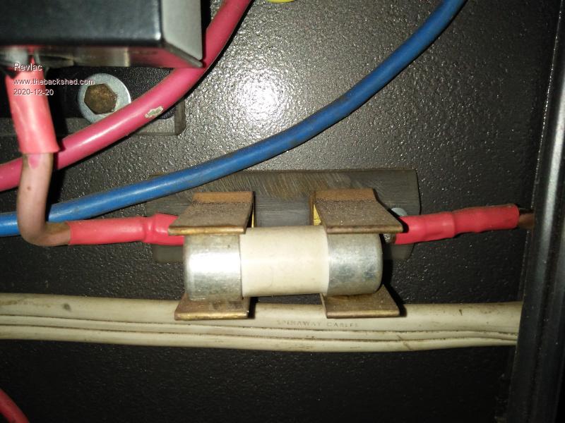

Another DIY option we might have around, This was an old 100A Bakelite fuse holder, taken apart as it was broken.
It had brass contacts that happen to be the correct size to push in descent size fuse, mounted on 20mm perspex.
This is connected to the output of the old 60A MPPT controller 80A fuse, never notices any heat, still not a cheap fuse.
Must be many of these and ceramic ones around.
Had an electrician tell us all the old ceramic fuse holders should be removed because they could start a fire?
All now replaced with plastic breakers in a plastic box......uh. more $$$ I think.
