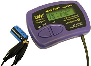

Another way would be to measure the phase and amplitude difference between the applied voltage, and the resultant current. Then with some vector number crunching come up with a resultant R and L worked out by some clever software.
This is more commonly done to measure the equivalent series resistance (ESR) of a capacitor, but a similar measurement method could separate out inductance and resistance of a lossy winding.
