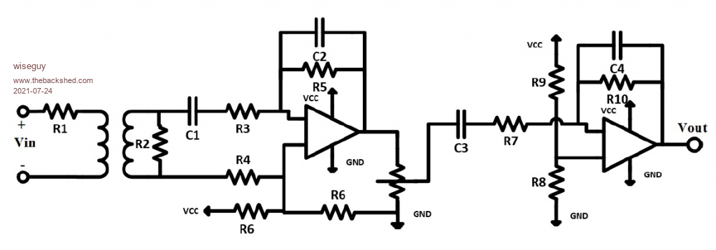

Agree Tony, also trying to incorporate the small but very efficient 2mA to 2mA output voltage sense transformers into the design should remove a few more watts of idle power depending on what iron cored monstrosity it is replacing.
At 230VAC in they are typically using just ~ 250mW.

  wiseguy said  Agree Tony, also trying to incorporate the small but very efficient 2mA to 2mA output voltage sense transformers into the design should remove a few more watts of idle power depending on what iron cored monstrosity it is replacing.
Can you please supply more details (where from, part #?) for these voltage sense transformers.

The Parts I used are here they are roughly $1 each.
Sorry for invading your post a bit further FF.
They will need a small bit of circuitry to rectify and amplify (lift) the lowish level to around the 3.5V(?) required by the nano.  You could fit this onto a sub board similar to your current setup and still feed the DC back to your nano - Ill contact you with a bit more info about this soon.

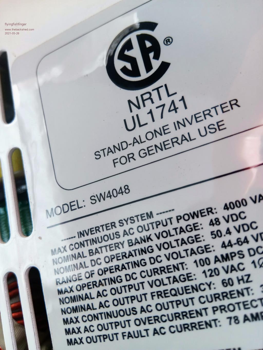

flyingfishfinger
Joined: 12/09/2020
Posts: 120
Posted: 04:43pm 19 May 2021
  wiseguy said
Its worth the $60 from a learning/fun perspective and if you go to pick it up you can have a closer look at all those toroids he has lying around whilst your there, maybe you will strike gold !
Apparently they're all the same.
  wiseguy said
I should also add and clarify that our inverters have mostly (all?) used toroids. In that respect you will be a bit of a pioneer.
Too bad, would have been nice to be a "pioneer" :) I think you mistook the first set of pictures. He's out of "rectangular" transformers, only has toroids left:
I was able to find a datasheet to go with it as well, attached. How much of this could I use as-is?
