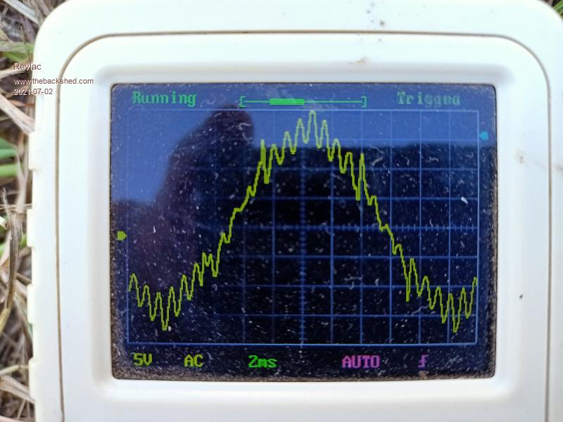

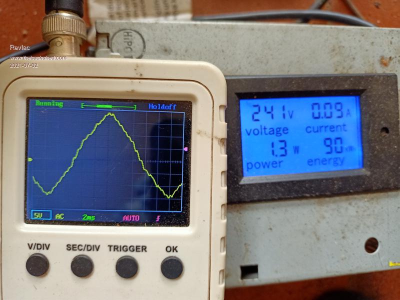

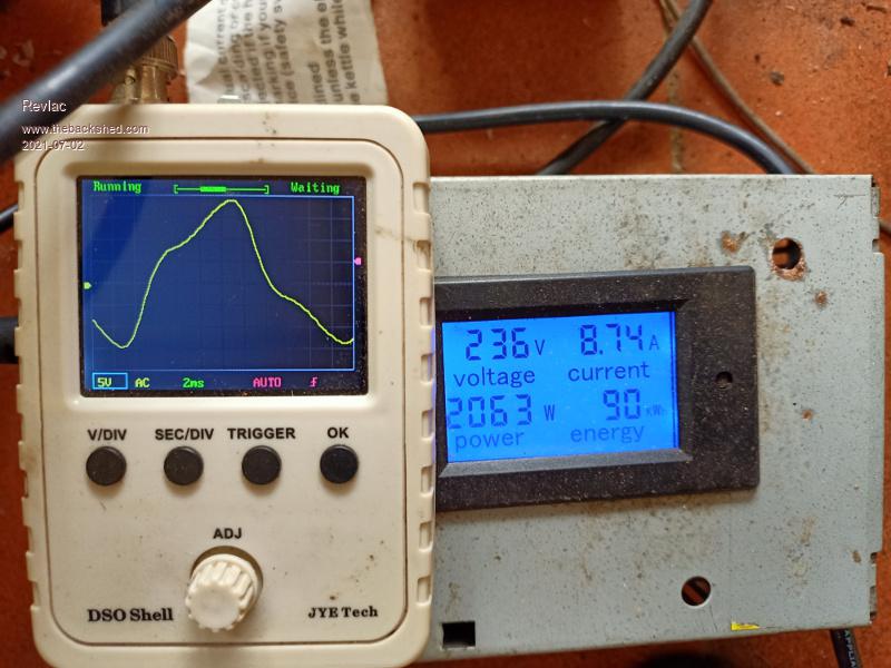

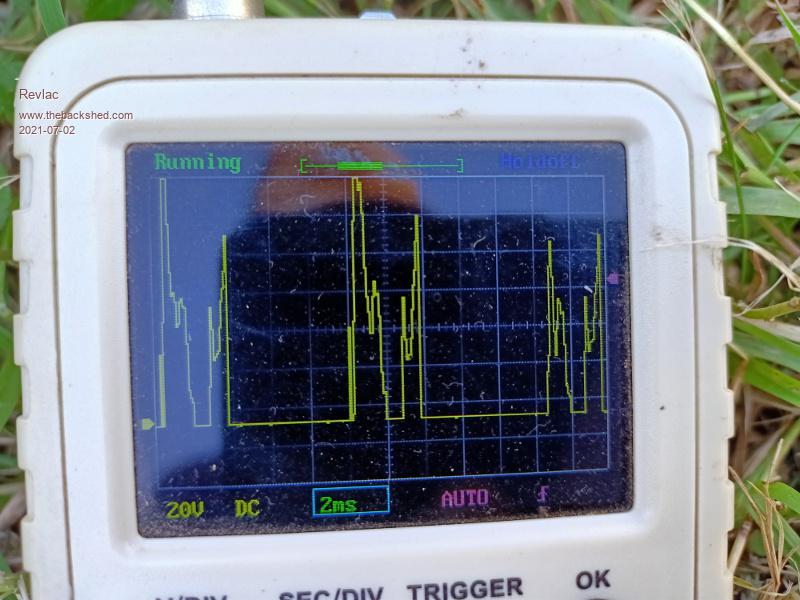

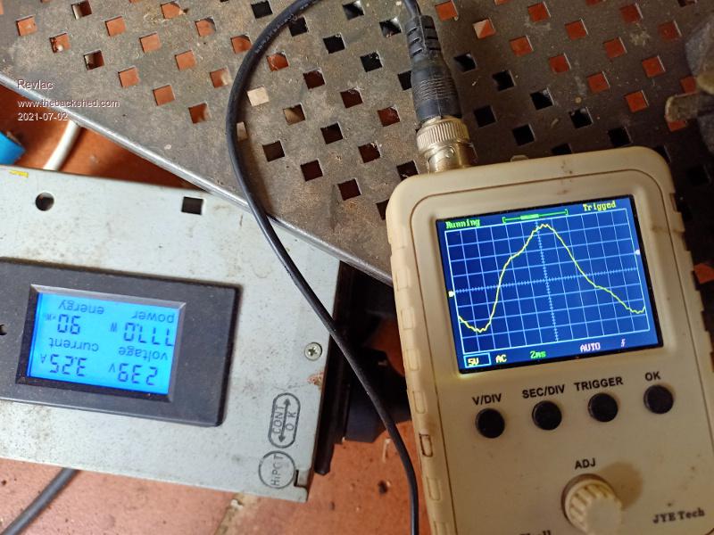

Revlac![]() Guru Joined: 31/12/2016 Location: AustraliaPosts: 1309 |
Hi Pete, I might have to rewind a generator one day so I might have some questions, I guess some small generators might not be worth the effort of rewinding, but the larger 20Kva ones are worth rewinding as its to many $$$ to buy another. It would be the stator that needs rewinding, don't think it would be too difficult to work out. A smaller 6kva stator also needs fixing but it would be a pita as its hard to get at in the frame/housing, someone put big magnets in the rotor to help excite it, just creates some horrible spikes on the sine wave. I could check the sine wave on a common 2200w aldi geny if you like. Cheers Aaron Off The Grid |
