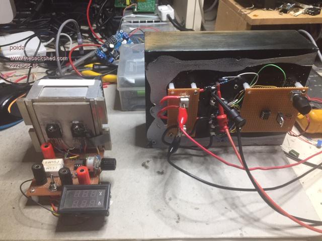

I was chatting with Wiseguy a while back when discussing a DC load for a KW sized
Lithium battery at 3.7V (250 Amps) when I wondered about linear mode MOSFETs.
I made a nice little DC load using the NEC K3304, 2 FETs driven in parallel.
It has proven to be a ripper unit, so useful with playing with dc-dc converters, testing various situations etc.
The NEC K3304 were not chosen by any selection process.
I had 3 of them from ripping an old plasma TV to bits.
Since I had them, I used them in the DC load.
I did not have even one clue about safe operating areas and thermal run-away
at that time. It has been bullet-proof. Talk about beginner's luck.
here it is on the left. The new one is on the right.
The little load can take about 30V at 6 Amps forever, no problems.
This is 120 Watts
The new one uses some modern Ixys L2 linear MOSFETS.
In particular, the IXTK200N10L2 which are 100V 200 Amp devices meant for linear
applications. They cost $50 each. I must have been drunk at the time so I bought
2 of them. Blame it on the home-brew vodka.

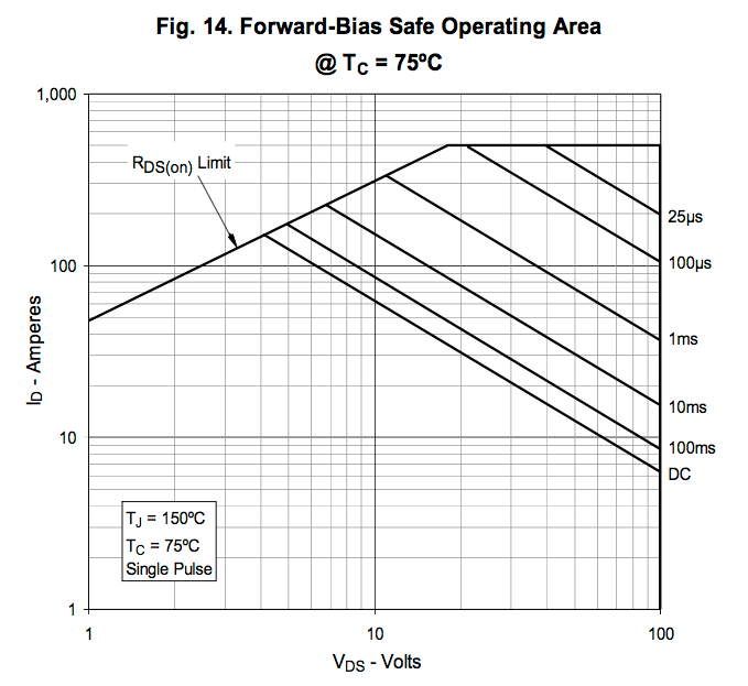

The guaranteed safe operating area is shown in the specs for a CASE temperature of
75 Deg C and that is what I will use as the limit. I can measure case temps
with a finger or a temp probe etc.
Below in the IXTK200N10L2 specs we can see the max power is 600W at 75 C.

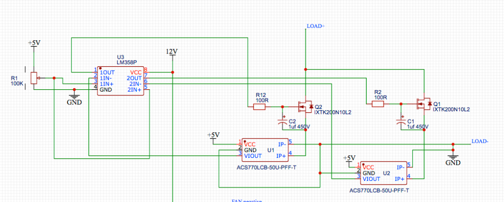

I have two IXTK200N10L2 FETs, driven with individual current sense op-amp outputs
so that means up to 1200W if I watch the case temp closely.
20 Amps at 30V, 60 Amps at 10V etc.
I wanted to make a bigger DC load and one that had a much lower resistance.
(the little one is 1 Ohm.) The new one is 4 milli-ohms
Much better. With 1 Ohm you can only draw 3.7 Amps from a 3.7V Lithium battery.
Now it's like 900 Amps not that I want to do that.
The circuit is so simple
Using a LM358 as a comparitor, take the 0 - 5V signal from a current sensor as -ve input, a 0 - 5V output from a potentiometer as the +ve input and the output goes to
the FET Gate, via a 100R resistor and 1uF cap filter (to stop oscillations)
I soldered the current sensor onto the FET source pin. Using 2mm house 240V
cable I have a very short and low resistance DC load path.
It works well. Twist the pot and dial up the Amps from 0 to 50 Amps

Anyway, it was a fun Monday to build this. I can now heat up the big heatsink
quite quickly. This is 1/2 of a 1.5kW Aerosharp HS.
