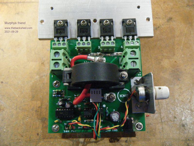

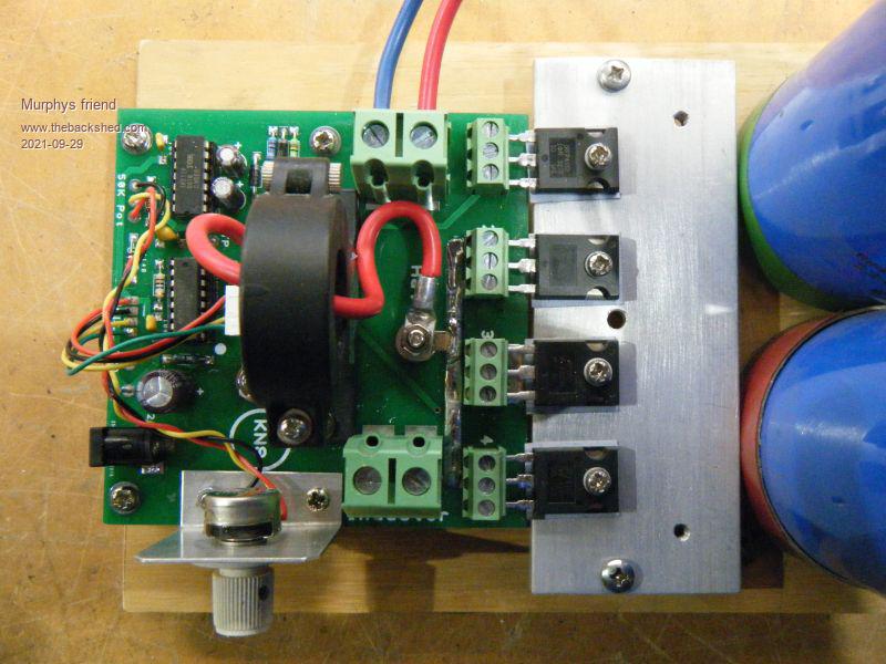

Quite some time ago warpspeed published a very clever saturation tester here which I built. It worked very well but it was cobbled together from some home etched PCB's and bits & pieces, not the easdiest kit to use.

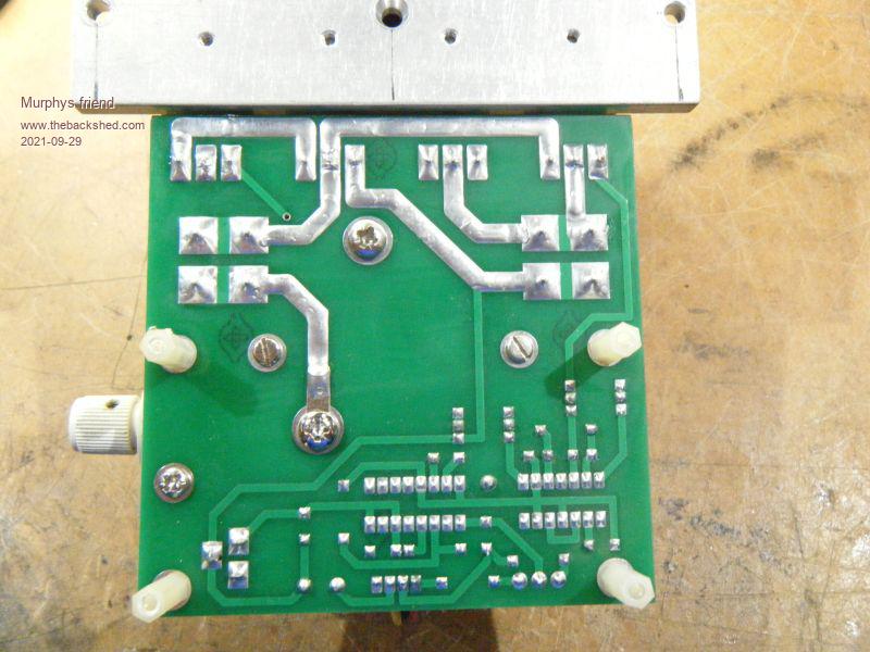

So, having time on my hands I re did the PCB to fit the cheap 100x100mm Chinese boards.
this is what it looks like:
As this is only a 1 oz PCB I made provision to boost the power tracks with solder:

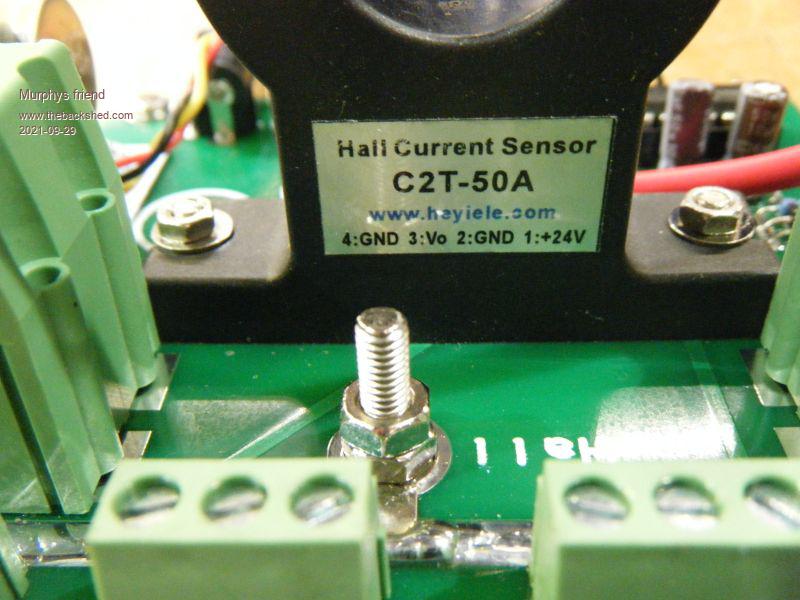

A HAll sensor is required, I used this one:

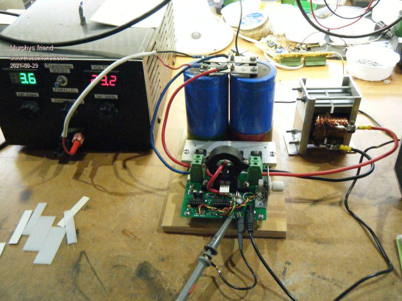

Here I am testing a choke for my (not yey finished) MPPT project:
The wave form just before saturation (hand held camera ):

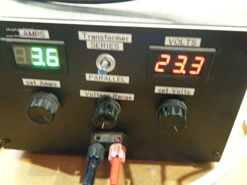

The power drawn from my power supply to get this wave form:

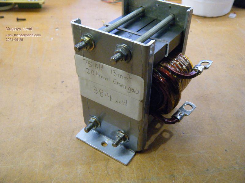

Details of the choke:

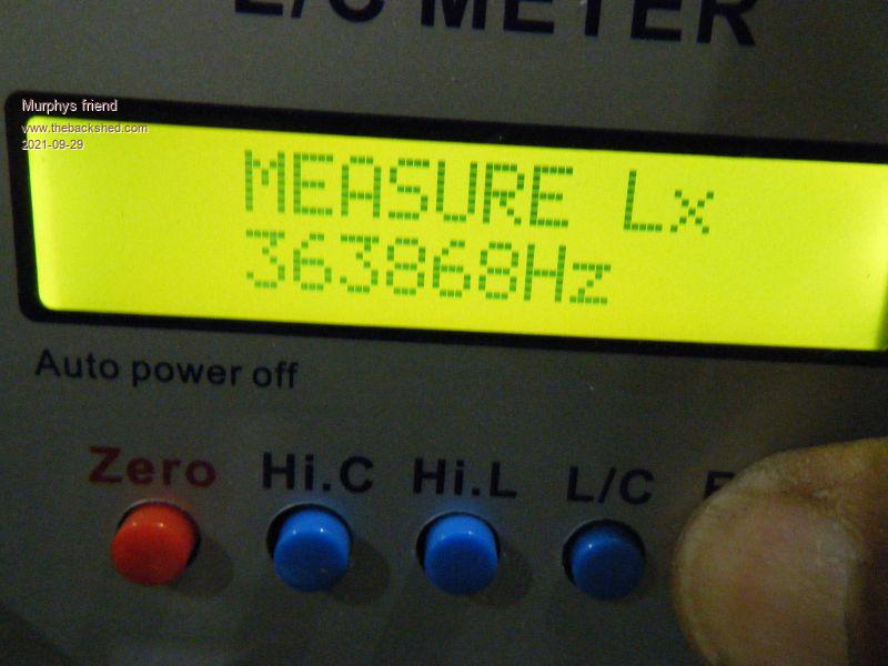

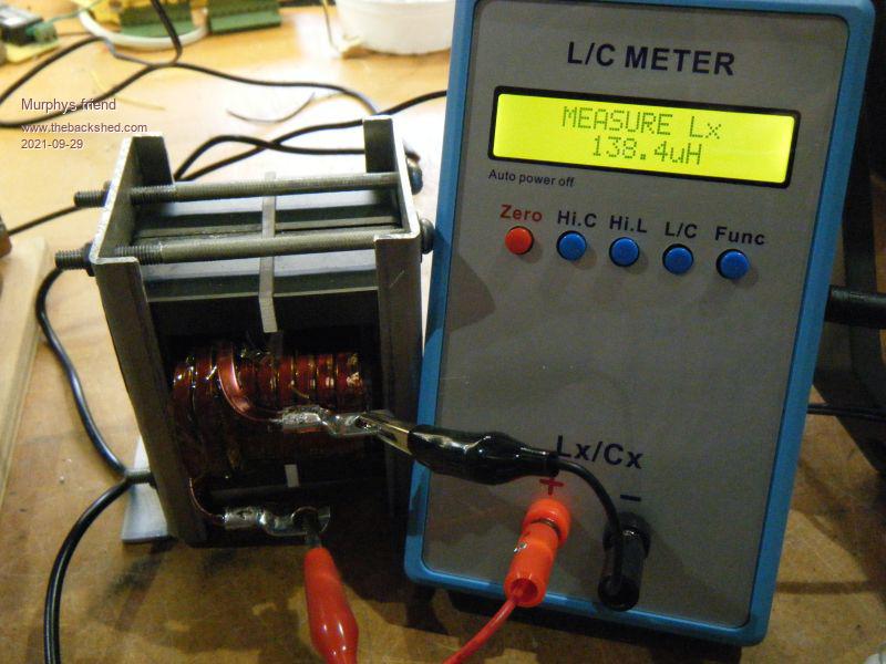

Measured at that frequency (not sure about that):
A close up of my  choke. Its a dual E65 core with a 6mm gap. I gapped all 3 legs with 3mm perspex, doing it that way is a lot easier than grinding of the center leg. Its also much easier to change the gap to get the saturation point just right.
Lastly, another pic of the tester:
I have two spare PCB's here, if anybody wants them they can be yours for the price of postage (Australia only).

It appears the voltage applied to the inductor is 23.3V

so 140 uH = 23.3 x (rise time)/Amps
Let's say Amps was (75/20) (from the label you put on the choke)

I like very much how well you built it too.

That Hall sensor returns 40mv/Amp.

I find it easier to use an inductance meter . I have that little one many others on this forum use as well but it refuses to switch from C to L now. That blue one shown above is a little more expensive but can measure much bigger L & C values.
