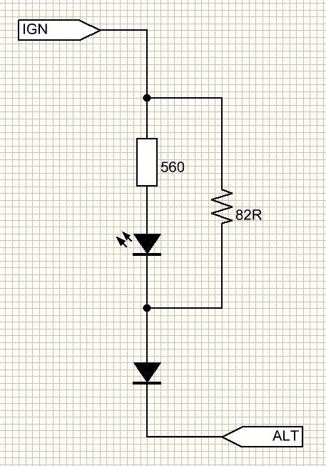

So, I decided to LED-ify the dash, replacing all the bulbs with 10mm White LED's instead, as I have heaps of those here.
All the replacements will work and look find through the dash colour filters for the various things, but the one I have tripped up on, is the alternator charge light.
The circuit is so simple, I am not even going to draw it, as you can describe it:
IGNITION---->CHG BULB---->ALTERNATOR
When you turn on the ignition, there is a circuit to ground via the alternator charge light terminal, so the CHG light on the dash lights up.  When you start the engine, the CHG light terminal on the alternator floats high, turning off the bulb.
Or so I thought.
When I tested this with a LED, it lights fine with ignition on, but once you start the engine, the LED remains lit.
I SUSPECT that this is cos the alternator, which is expecting a bulb and therefore at least a few hundred milliamps of current to flow, is simply not lifting the CHG light terminal with only 20mA or so of LED current.  The alternator needs to see more current flow in the CHG light line before it will float high when spinning, in other words.
I am thinking perhaps I need a shunt resistor across the LED and its resistor - thoughts?

Old style alternators - IGNITION---->CHG BULB---->ALTERNATOR = small current flowing in the field coil, required to bias the magnetic field slightly so the main coil will produce an output once it starts spinning, increase in voltage makes the light go out.
You will need a resistor = hot resistance of the bulb in parallel with the led, may also require a series diode so the led cannot be reverse biased and blow up.

Yes, a shunt resistor is the answer. 75 to 120 ohms 2W is usual. Current through the lamp or shunt provides B+ for initial excitation of the alternator. The LED stays on, as you thought, because the current is too low to get the alternator started. Once started the field diodes (D+) takeover the supply of excitation current and the light goes out as it now has 14V on both sides.
PS You can sometimes get the alternator to excite with just a LED if you rev the engine hard enough.
On some recent cars the main ECU drives the lamp and controls the alternator voltage.

Posts: 10071
Posted: 04:37am 15 Nov 2021
This is what I have now, and it is working fine, so I will design this in so the dash is fully LED, and I should never need to change a blown bulb ever again for the life of the car.
If anyone sees anything fundamentally wrong with this arrangement, please let me know before I glue it all to the back of the dash!
Posts: 3412
Posted: 06:12am 15 Nov 2021
That would be perfect. On Bosch alternators your ALT goes to D+, for Lucas it's IND.
