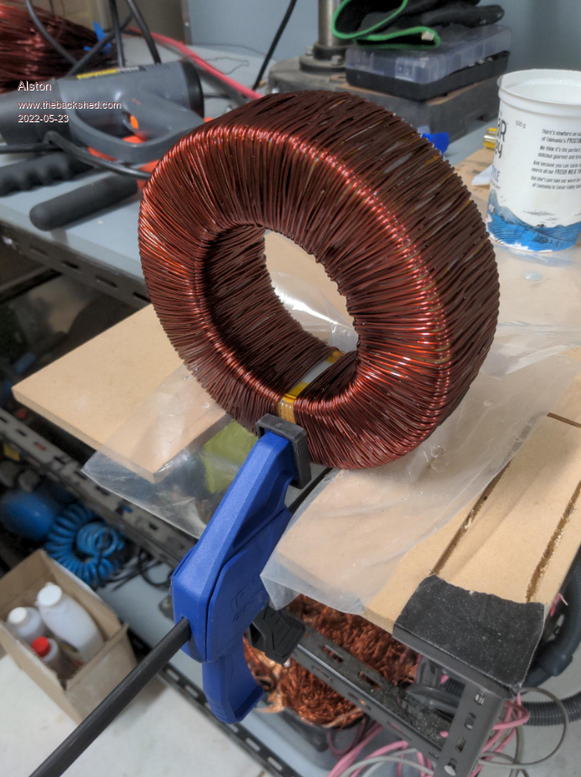

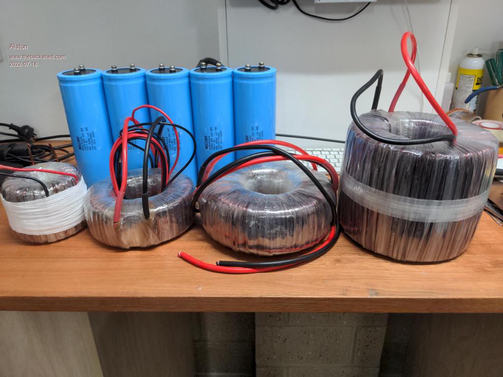

So since I have unwound my number 2 transformer and have my core, so I thought I would start with that one. I am planning a 5kw 4 transformers setup and will be using a 48V nominal battery voltage. The step voltage I worked out are 229.068v (3375watts), 76.356v (1125watts),25.452(375watts),8.484(125watts) for a total step voltage of 339.36.
Transformer 1 will be a 3kw AeroSharp core. The SMA Sunny Boy core is for tranformer number 2 and has an OD of 192mm, ID of 91mm, a height of 52mm and 1 turn is 205mm. The area I calcualted of the core is 26.26 cm2. The rule of thumb for working out how much power the core is rated to I found was the square root of the power. But this would mean a core of this size is only good for about 700watts? I assume since a torodial transformer is more efficient there is a different formula to work this out?
Tony I read in another post of yours to wind all transformers as if they were for 50hz. So with that in mind 42/26.26 = 1.59 turns per volt, 1.59x48v = 76.32 turns for the primary and needs to carry 23.43 amps at 48 volts. The secondary is 1.59x75= 121.4 turns and I assume the secondary of each transformers needs to carry 21amps (5000w/240v).
Aside from the obvious current carrying what consideration do I need to take into account when selecting the wire guage?
When and why would you use multiple turns of smaller gauge wire?
Do I calculate my primary with the lowest expected battery voltage instead of the nominal voltage?
It seems like transformer design is largely a balancing act, with that said what are some rules of thumb I should follow? Searching around there seems to be more info for EI but not so much toroidal transformers online.

A few rules of thumb about winding toroidal cores.
1. you cannot have a fractional turn, one pass through the hole equals one turn.
2. use the 4 Amps per sq mmm wire area for your current rating.
3. we use smaller gauge wire with turns in parallel because we salvaged the wire and smaller gauge is *much* easier to wind by hand.
4. Yes use the lowest expected battery voltage for your calculations (I used 50V for a lithium battery bank), its less for LA batteries.
5. with warpinverter toroidal cores you will most likely run into trouble with the smallest core. Remember that the secondary must be rated for the full output current so, if the hole is too small it simply will not fit. I ended up using a core much larger than for the expected power rating for that reason.
6. you cannot wind by hand as tight as a machine can so the theoretical number of turns you can fit around the circumference of the hole can be up to 10% less.
Lastly, your total step voltage is quite high, I would aim for 230V.

  Quote  Do I calculate my primary with the lowest expected battery voltage instead of the nominal voltage?
Yes, depending on battery chemistry, the lowest voltage the inverter will ever see is your transformer design starting point.
The voltage regulation built into the Warpverter can only decrease the inverter output voltage, it cannot increase the output voltage beyond what the transformer turns ratios were originally designed for. So somewhere around 40v to 44v worst case input might be about right.
Forty volts sounds pretty extreme, but its better to have a bit extra down at the low voltage  end rather than have the output voltage dip under extreme short term surge loads when the battery is down a bit in voltage, which can produce light flicker.
The inverter final sine wave output voltages is nominal, anywhere in the 230v to 240v output range will work fine, as the exact output voltage can be tweaked with a potentiometer once its all running.
Whole volts are much easier to work with when designing the transformer windings, so the suggested secondary design voltages are 225v, 75v, 25v, and 8.33v.  That all adds up to 333.33v which is the peak voltage reached when all four inverters switch on together in the same direction.
For a 333.33v peak sine wave the rms will be 235.69v  which falls neatly into our desired output voltage range.
For 5Kw all the secondaries carry the same current which will be in the region of 21 amps rms.  A good design current density for all of the windings will be 4 amps per mm square copper.  So around roughly 5mm sq copper would be about right for all of the secondaries.
Now the trick is to see if your largest toroid is big enough to fit enough wire on it to satisfy the 5mm sq requirement, with sufficient turns, without using up too much of the hole to do it.
If the starting diameter of the hole is 100%, that should shrink to no less than 70.71mm (root two).  If the secondary will fit fine, if the secondary uses up too much of the hole, you need to go to thinner wire.
Say for example you are forced to use only 4mm sq copper on the secondary to meet the 70% minimum hole requirement. 4mm x 4amps = 16 amp rated secondary, and your inverter will be 3.76Kw not 5Kw.
Its how much copper you can fit onto the toroid that determines power capability.  Bigger toroid equals higher power rating.

Thanks Tony. I have been back over your previous post and come up with the following. So for my core of OD of 192mm, ID of 91mm, a height of 52mm the area I calcualted of the core is 26.26 cm2. I have changed my voltages to 40v and the step up voltage to your recomendations and my transformers would be 3375W,1125W,375W and 125W. So to get 1 Tesla of flux density I would need 128 turns (for TX 2 at 75 volts) which works out to be 69 for the primary and 129 turns for the secondary. Does this sound right? I would need 28amps on the primary and 21 amps on the secondary. Since winding thinner wire is obviously much easier by hand as Klaus pointed out what would be recomended in terms of what would fit and be able to be wound? I think I might need some help with working out how much will fit and so on. You mentioned in that previous post that 1.6mm wire is good to 8 amps but the AWG guide says 5.9?
As for driver boards I haven't worked that side out yet but I very much like the elegance of your hardware based approach. Writing software isn't an issue for me but I may still buy one of your driver boards as a good starting point.
Posted: 07:57am 31 Dec 2021
Yup, core cross section 26.26 cm sq
Primary voltage 40v, secondary voltage 75v,  turns ratio x1.875 step up.
And 129 secondary turns comes up with 9,972 Gauss (0.9972 Teslas)
129 x 40v/75v turns = 68.8 primary turns.
69 primary turns with 40v dc would produce 40 x 129/69 74.78 volts which is fine.
Now assuming we are going to use several 129 turn secondaries layered one on top of the other.  The last layer to go on will have to have a minimum diameter roughly 70.71% of the hole diameter.
So assume the diameter of the last secondary layer is 70% of 91mm = 63.7mm diameter.
The circumference will be very close to 200mm.  The biggest wire that will fit 129 turns around that last layer circumference is theoretical 1.55mm diameter. 1.5mm diameter wire should just fit, remembering that the layers underneath all have increasing circumferences.
1.5mm diameter wire is 1.77 mm sq, and at 4 amps/mm sq is good for 7amps per layer.
Now the difference between our final layer (63.7mm diameter) and our first layer (91mm diameter) is 27.36mm.  In a perfect world 18 layers should be possible !!
But we only need three 7 amp 1.5mm layers to reach out required 21 amps.
So there is going to be HEAPS of room on that core.
Much thicker wire will be possible, but with slightly greater physical effort to wind.
1.9mm wire would be 2.84mm sq and at 4 amps/mm sq 11.3 amps. only two layers would be required.
Our core diameter is 91mm or 285mm circumference. In theory 150 turns should fit. The second layer will only fit 6 turns less theoretical or 144 turns.
Two 129 layers of 1.9mm wire should also be possible.
So two choices, two layers of 1.9mm, or three layers of 1.5mm  with 129 turns per layer.
That toriod is pretty big for inverter number two, and its going to look a bit empty. But it will be a very easy wind, and will work very well.
Edited 2021-12-31 18:04 by Warpspeed
Posted: 08:12am 31 Dec 2021
If you decide on two layers, 1.9mm is the biggest wire that will fit.
If three layers, 1.5mm is all you need for the current, but there will be plenty of space for larger sized wire than 1.5mm .
