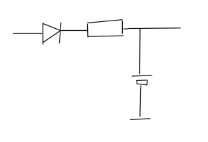

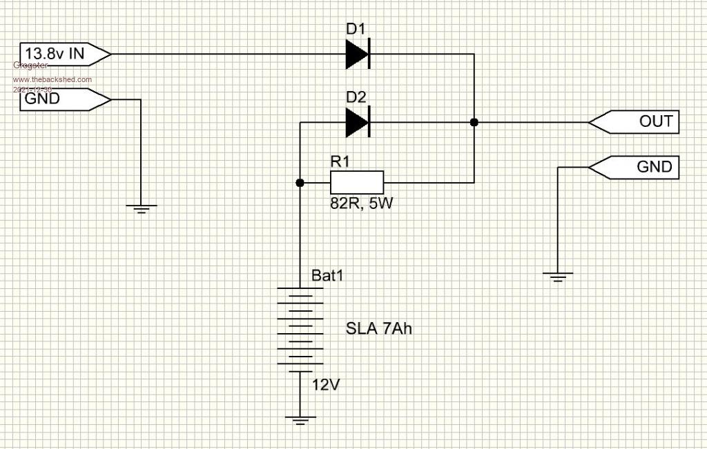

I want to include a SLA battery charger in my latest project.
Basically, I want to use a float-charger, but current-limited to protect both the battery and the PSU.
The normal way I have done this in the past, is a simple series resistor, and a diode gate:
The switchmode PSU has a rating of 1A, so I would like the resistor to limit the current to about 250mA or so.  An 82R 5W resistor across a 13.8v supply gives a current of about 170mA, which would be fine, but when I connect this in series with a 12v 7Ah battery, the charge current is zero.
I suspect that the battery internal resistance is something I need to consider when choosing the resistor, but I'm not sure how.  When I used this R+D charging arrangement before, it was for 9v NiCd batteries with a very small charge current of 17-20mA or so(so I used 330R for R1), but I need more grunt for an SLA so it does not take forever to recharge.
What puzzles me, is that with an 82R 5W resistor in series, the charge current is zero.  If I bypass the resistor, the charge current is 3A or so.
Can someone suggest what I am doing wrong?
Device will be powered 24/7, so a simple float-charger is all I really need, but why isn't it working?  It worked with the 9v NiCd batteries....

As the battery voltage rises, the current will fall. Current will reach zero when the battery is the same voltage as the charger.

I would only use barrier diodes like above if the battery was not rechargeable (like an RTC coin cell and the barrier would be a BAT54C). In your case, you don't care that the shore-supply and battery get together (it is needed). What is your thinking on the blocking, what am I missing?
Quick check, no insult intended - You are using Schottky diodes right? something like 1N5819 would probably be a good fit, 40V 1A. Vf will rise with If, with 1N400x this could already be knocking you down to close to 13V. If you have a good battery it could be that Vcc-Vf is close to Vbat - in which case there would be no current flow. Dunno about the bypassing thing, 3A is way above what you say the mains supply will give... more info?
As a quick test, consider taking out D2 and dropping R1 so you get what juice you need to charge the battery under load. The circuit will then be "running from the battery" all the time with the mains supply acting as supplemental/charge. I would only use the below for LA (and did for my aquarium controller years ago, pre-mite days... tiddly little 12V SLA motorbike battery, very cute)

@ CaptainBoing - thanks, yes, using 1N5819's.  The diode gate is so that the battery can be charged with the PSU, but if the mains fails, the battery takes over.  Fully automatic.  The diodes simply prevent the battery voltage from trying to go back into the output of the PSU if the mains fails.  3A was with a bench PSU when testing, but the PSU I will be using, is current-limited to 1A.  Removing D2 is a good idea.  I just copied what I had with the 9v setup, but the resistor used there was 330R, so the diode was there to bypass the charging resistor when the mains failed, otherwise there would be too much voltage drop across the 330R resistor to power the rest of the circuit.  But with a SLA battery, the charge current can be much higher, so a much lower value resistor such as 82R or so, probably won't affect the operation of the rest of the circuit due to the low value.  And thanks for the link to the IR calculator.
I will play about some more.

Yep, nice gentle charge but loads of grunt courtesy of D2 when needed. Maybe the precise inheritance of the original circuit is moot with LA.
Re-arranging how to think about it; if using the battery as primary power, the mains PSU  becomes primarily charging - straight onto the battery via R1 with supplemental capability when fully charged.
<obvious>Don't forget to fuse the the battery. LA is scary powerful... </obvious> I melted a  spanner across the terminals of a car battery (deliberately) as an idiot 18yr-old. "Youth is wasted on the young" - G.B.Shaw (varies)
In your boots, I would play on the bench and drop R1 down to around 18R, or maybe even 15R if you trust D1 (bit hard on it though), it'll get you nearer to the 1A capability of the mains PSU, good strong charge and more supplemental power when running "normally".
Lowering R1 does mean you'll probably break your 50mm2 space limit though, going from 3W to 15W (ish) - unless R1 is mounted on the chassis for heat dissipation in which case it won't matter.

The SLA I plan to use is either a 2.3Ah or a 1.2Ah.  I had a 2.3Ah one sitting on the bench, so I played with that one.  I discharged it to about 8v by putting a 6A load on the battery in the form of a radiator fan.  I am aware that you never allow SLA's terminal voltage to fall below about 7v.
With the battery now at least partly discharged, the resistor I ended up with was 22R 5W, to give a charging current of about 150mA float/trickle, which I think will work fine.  It does not need to be a fast-charge, and a gentle current-limited float charge is probably better for the battery long term, then fast-charging.  I will do a few more tests on the bench before I put it on the PCB layout.
Yes, I will in-line fuse the SLA.  Yes, a short-circuit LA can pass some SERIOUS current, so we don't want any kind of fault condition setting fire to the box!
You'd be surprised how much short-circuit current you can get out of even the small SLA batteries.  It usually kills the battery, but while in that state, those small SLA's can still pass serious current in a short-circuit condition.
I've also seen those SLA's swell up and bulge in a very unhealthy looking way, if you don't at least current-limit them while charging.  One battery I replaced in a panel, was just wired DIRECTLY across the output of a power-supply capable of 5A or so, and I was called in cos the staff said there was a horrible smell coming from the panel.  Opened it up, battery so swollen and bulging I'm surprised it had not cracked open.  Was hot enough to fry an egg on, and if you put your ear to it, you could hear it sizzling internally.
That is NOT how you charge a SLA, but I digress!
