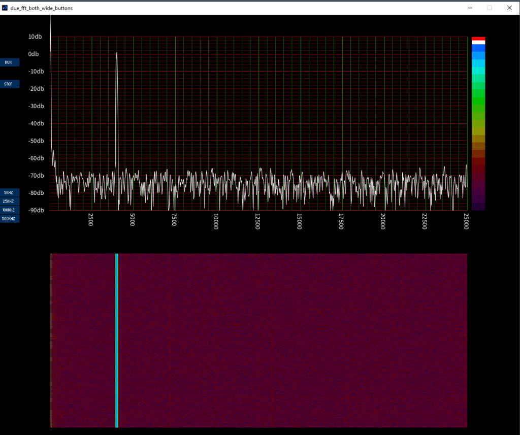

I always wanted a better display of the frequency spectrum of things
compared with what I can get from the Rigol DSOs I have.
Finally got the urge to write some code, to use what I have at hand
so no extra cost. And all open source tools.
The program shows the freq spectrum of a signal in two ways.
One is what it is right now, with a vertical scale in dbV
(20 dbV = 10x difference)
and horizontal scale being the frequency.
The other is the spectrogram waterfall, with colours representing voltage.
This shows how the spectrum changes over time.
this is what it looks like
Bits you need:
a PC running Win10 or something. I had it working on the iMac running OS 10.9 too.
one Arduino Due (about $12 on ebay)
Results and specs:
Input voltage range 0.0 to 3.0V DC with respect to the Due's ground
0.0db = 1.0V signal, peak to peak.
4 K sample window
about 70 db signal to noise ratio
4 frequency ranges (5kHz, 25, 100 and 500kHz)
very decent update rate (see video here    )
14 Hz at 25kHz setting rising to 30 Hz at 100kHz
and then it's about 40Hz update with the 500kHz setting
(5kHz frequency range is very slow since it takes a long time
to get 4K samples at a 10kHz sample rate)
The Due has a 12 bit ADC and that means a signal to noise ratio of about 74 db
is the best you can hope for (the famous 6.02 x Nbits + 1.74db equation)
When the input gets near 3V p/p a bit of distortion appears, usually 2x and 3x
the main peak but this is only at -60db or about 1/1000th the peak's value.
It was huge fun to program and I am amazed how well it works.
Two programs to download and install. Processing4 and the Arduino IDE.
The spectrum program  is
due_fft_both_wide_buttons.zip
and the code for the Due is
high_speed_adc_due_buffer_handshake2.zip
If anyone tries to use this, you will need to alter the COM port name in the main
program to suit what it is on your computer.

poida
Joined: 02/02/2017
Posts: 1497
Posted: 02:09am 29 Jan 2022
Hi Angelo (good to hear from you)
the applications are mainly educational.
I have had to learn from scratch about FFT, sampling theory,
frequency domain verses time domain, digital filtering
and lots more.
The above thing is good for exploring all of the subjects.
I thought maybe someone here might find this program interesting.
for example, make a circuit to produce a sine wave.
It's likely the output will not be very pure and have small amounts
of other frequencies present. How measure this?
With the above program.
How good is that cheap function generator from aliexpress?
Is the sine wave clean? Is the output linear over frequency.
The FY6900 I bought has an output that falls rapidly after 1Mhz
but it cost $90 so you get what you get.
I am also still looking at the inverter design, in particular
the LC circuit that is the primary winding. We tune the LC to about 50Hz or more
for stable running.
Still there are harmonics present on the output.
The above program can show these harmonics and how they increase and decay
in time during the soft start. (paging Wiseguy! this might be useful for you
with that "grunt" sound issue)
The 50 and 100Hz peaks are not that easy to see but we want to see the changes over time and the absolute values when looking at the LC resonance and the toroid's remenant magnetic flux.
You can use this to see in a qualitative sense the EMI radiation
of the inverter. placing the input wire 5 cm near conductors will pick up
a lot of the 20kHz plus harmonics of the PWM.
We can learn what might reduce it, what happens if you put it in a metal box, etc.

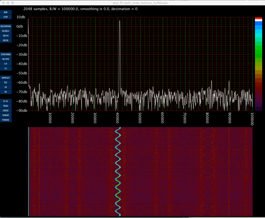

The program has become more advanced after further work.
Now you can choose the sample size (512, 2K and 8K)
and also smooth the spectrum over time to squash the noise.
I also want to make it work with the STM32F103 based  "Blue Pill" microcontroller
This will take a fair bit of time learning that ADC hardware and it's DMA controller.
A Blue Pill costs about $4 and probably can sample data faster than the Due
