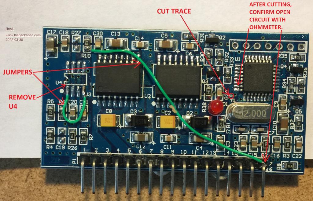

If you are getting a chinese 8010 based board there are a couple of modifications that help make them blow up proof.
I am not sure where they are on the site but they involve stopping the over current circuit from working. The boards have two different overcurrent protection circuits that can fight each other and cause them to blow up.
The easiest way I know of is to bend pin 1 of the 8010 board out so it does not make a connection at all.
Otherwise there are a couple of resistors and a small chip (LM393 I think) to remove.
Hopefully someone more knowledgeable will let you know more.

don't touch the eg8010's pins, oztules rigorously tested it and it works fantastic... you will need to jump pins 7 to 8 and 1 to 4 on the 393 op amp.. also put a 18v tvs diode on the gates of the mosfets,  at least 1 on each " bank " of mosfets..

tinyt
Joined: 12/11/2017
Posts: 564
Posted: 08:55pm 29 Mar 2022
Dug up picture of my EGS002 mod.
noneyabussiness
Joined: 31/07/2017
Posts: 527
Posted: 05:23am 30 Mar 2022
seems unnecessarily difficult.. seriously,  jumping  pins  1 to 4 and 7 to 8  on " U4 " will do the same thing... but in addition,  the original " instant " current control of the eg8010 will continue to work if need be... why we had to remove the lm393 in the first place,  it would " fight " the eg's current control and you would cause spurious drive signal to mosfets causing instantaneous combustion..
