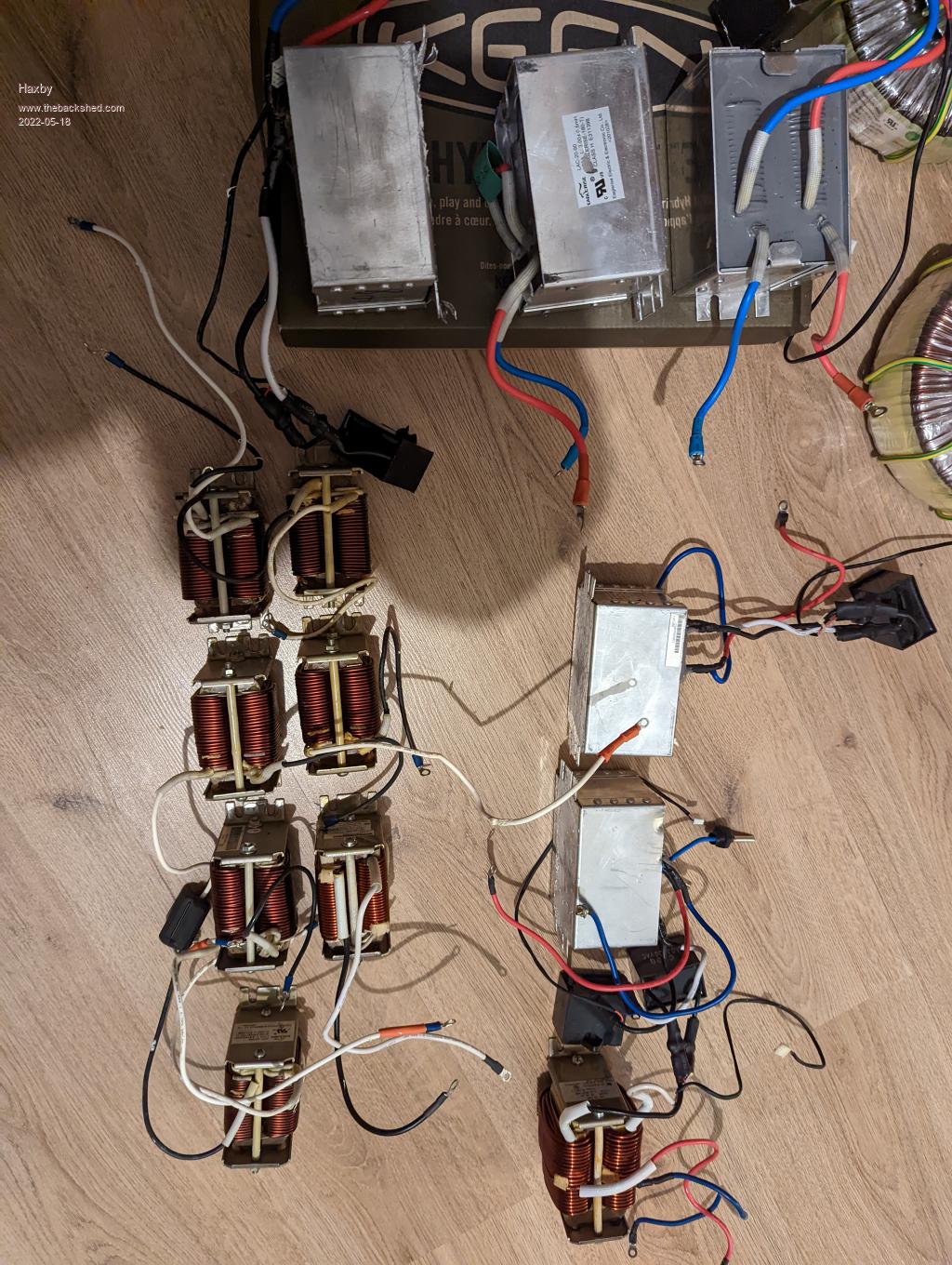

I'll be playing with a few EG8010 boards that have been gathering dust over the next week or so. Just tinkering really.
So the 48v portable pack that i built in the other thread is working great. It's using a smaller choke from an aerosharp inverter. I unwound all of the turns on one side, and half of the turns on the other side. I also increased the gap by a couple of mm. The label on it said 2.67 mH so to get down to 4.7uH I knew I had to remove a lot of windings.
Without a choke tester, I just winged it. It's about half the size of the 500va transformer I'm using, so it's a bit too big, but hopefully that will come in handy when starting up stubborn loads. In any case, the sine wave looks great and the standby power is fine.
Now I'm wondering how the commonly recommended 4.7uH figure was calculated. Or is it a rule of thumb that just seems to work?
Is it mathematically tied in with the 23khz switching of the EG8010? Or is it due to some characteristics of the transformer size? Let's say I wanted to build a 200vdc input inverter with the same topology. Would 4.7uH still be the aim?

the 23kHz switching freq is not important in respect to the LC filter design.
I have experimented with all sorts of PWM switch freqs using the same LC filter
and not a lot changes. (apart from the PWM freq and the wobbles in the AC voltage output, all minor "issues" but excellent for thinking about)
The PWM input into the transformer is a very strong squarewave.
Lotsa current and lotsa harmonics (3x,5x, 7x etc of the PWM freq)
We need to smooth this crap out.
And so we use the LC filter on the primary winding.
I have found for 20kHz or so PWM and moderate power levels, such as up to 3kW
something like 40 or 50uH is good for the choke.
But what is vital, is that the choke does not saturate at peak power levels
so that means we need to test them to see the current levels that cause
saturation. (Saturation of the choke will have it no longer being a 50uH
choke, it now is far less than that.)
The core of the choke needs to work at these high freqs too, including
the harmonics. I like ferrite cores but we have had a lot of success with the
Aerosharp fine layered Iron laminate cores too.
You have to test them to prove they are OK.
The L in the LC filter is the choke plus stray inductance of the toroid
which is usually small, of the order of 5uH or so.
The C is the capacitor across the inverter board's outputs.
This can be placed across the primary or it can be put across the secondary winding
where you get the turns ratio magnification of the capacitance.
We usually put it across the secondary.
I have found I blow inverters with a 10uF on the secondary. This had a self resonance of about 17Hz. This is far too low a self res freq.
I use something like 2.2uF now and the self res is about 40Hz.
Only after you try some combinations will you see what the self res freq of the LC + toroid combination is for you.
It might be that only 1uF is needed to get the freq above 50Hz.
Some people here insist that you aim for 75Hz.
I have not done this and no inverters have died with self res freq of 40-50 Hz
in my builds.

One thing I haven't seen any discussion on is the emphasis on the placement of the inductor on the SPWM side of the inverter.
What I mean is that one side of the transformer is driven by a 50hz square wave, while the other side is doing the (far shorter) pulse widths of forming the sine wave.
It's easy to think that it doesn't matter what side of the transformer the choke is on, but the transformer has capacitance to the core and to the secondary, so I think it's important to wire the choke as physically close to the SPWM side as possible.
I'd imagine it would decrease EMI and RFI too.
Thoughts on this?

Pete, I'm talking about what side of the primary winding the choke should be on.
Put another way: There are two screw terminals for the transformer on my Sunyima inverter board. You would think there is no polarity as such, but one screw terminal outputs a 50 hz square wave, while the other outputs the variable pulse width modulation.
I'm suggesting strongly that the choke should be directly connected to the SPWM output. Get what I mean?
So the transformer will see something closer to a sine wave after the choke.

Generally the choke was mounted between the high side (high frequency side) of the inverter power board and the transformer primary, most of us built these inverters with the transformer quite close to the power board, about 300mm give or take, and fitted the choke within that space, uni polar needs one choke as was indicated in the manual.
This was talked about a lot in the past, but is buried deep in the forum notes.

EG8010 based boards that follow the recommend circuit will have one terminal output 50hz square wave, while the other terminal will be SPWM for both the high and low side of the sine wave.
Putting the choke on the SPWM side, as close as possible to the fets, will decrease EMI and decrease the capacitive coupling issues in the transformer.
It's a shame they are not labelled. Anyone buying these boards would need a scope to see which is which.
On a side note, the fets that do SPWM will likely run hotter than the others, due to higher switching losses. So a highly optimised design will have more cooling on that side of the circuit.
