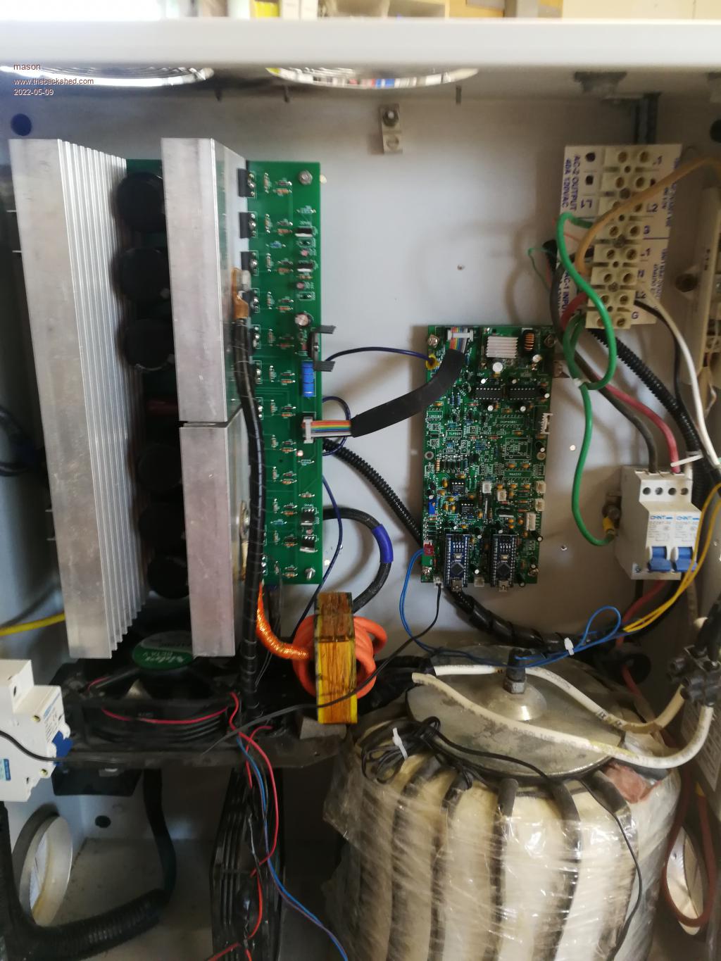

Hi Poida, just wondering if you could point me in the right direction, I've made your power board and the nano control card, when I fire it up with a low amp power supply no toroid it seems to work, when I put my battery bank and the toriod on it and then fire it up alls that happens is the light on the nano just flickers.
I was going to try using a different nano card.

I made a few errors with the power board in my first PCB attempt.
Did I send you one of these boards?
OR did you make the PCB from the gerber file?
It seems that you got some boards made.
(I deleted the instructions to fix errors with my first version power board)
You have an oscilloscope? it will be handy.
disconnect the nanoverter
apply 50V to the power board
check if about 17V is across C9 and C10

maybe I should just order the pico control card less parts to check lol, I had a nano hooked up to a mad power board last year and everything was working fine, shut it down for 6 months fired it back up yesterday and it poped 12 fets so I had your power board on the shelf put that in and changed the nano control card. I have both types of switches on it , so I turned the power switch on and the nano light just flickered shut that switch off and hit the momentary switch and a couple seconds later fried 6 fets , 80 amp breaker triped..

I assume you have a minimal build here without
thermistors for heatsink and toroid, no DC current sensor, no AC current sensor
It should run fine just as long as you have
the AC voltage feedback in place.
I would check the AC feedback voltage and prove it's about 2.5V AC
when the feedback transformer is fed your desired output voltage.
Is it 120V or 240V?
I would disable all the cutoff reasons
from H to L inclusive
It appears you have no thermistors connected to the two inputs.
These may be giving high "temperatures" from EMI
and then the high temp cutoff code triggers..
These are enabled at the moment
IF you do not want to use the thermistors, put a 10K resistor across each
of the inputs. They will then read 25 C and not let EMI in via those pins.
It would be good to calibrate the DC volts for a start
power the board but don't let the inverter run and measure voltage
choose 1 from menu and tell it the voltage
Finally, I found the inverter run/stop input to be effected by EMI.
I put a 1uF cap across the pins and it settled down well.

Hi Poida, I tried those settings on two of the three cards I made
The third card I never tried at first but I thought what the heck ill try it,
Turns out this card worked the only thing that doesn't work is the stop run switch had to use the momentary switch, and the only thing different about this card is that the Nanos are soldered directly to the board.

so you have a working inverter now?
Maybe there is a problem with component(s) on the other boards.
mason
Joined: 07/11/2015
Posts: 86
Posted: 11:48pm 12 May 2022
Yes it's working now thanks a lot for your help.
Yeah I think it's maybe the 21844 ICs.
