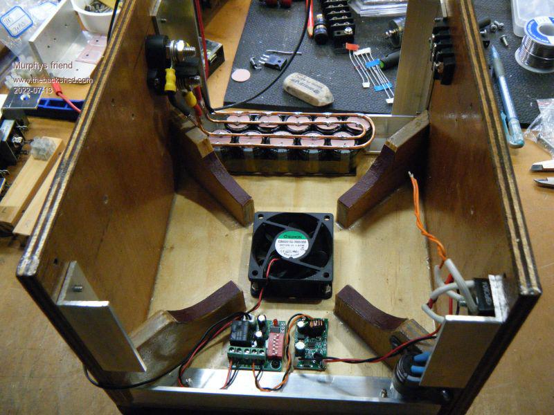

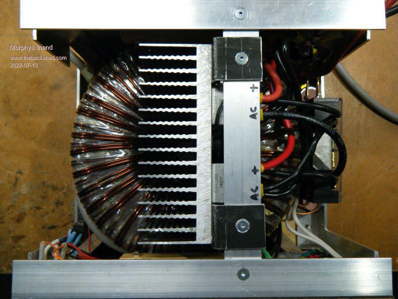

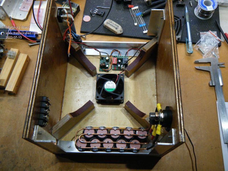

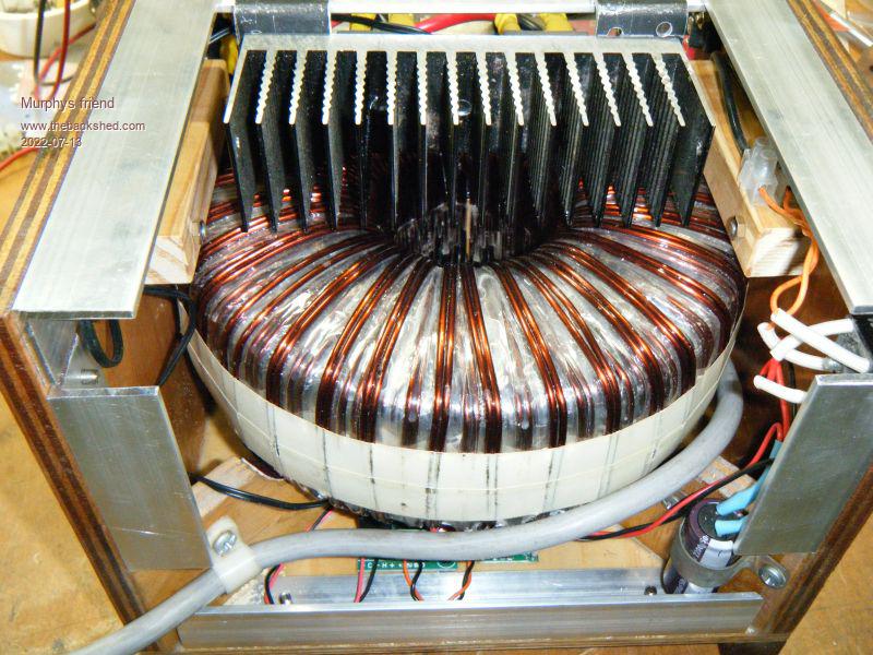

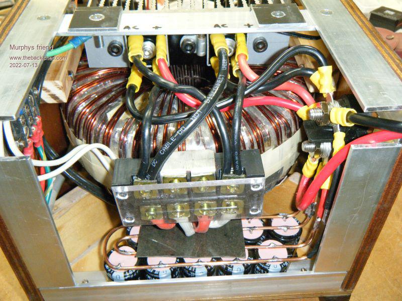

What I needed was to transform the 1.8KW 240V AC output to a suitable lower voltage which, when rectified, is acceptable to my spare 60A MPPT controller.
Having already a 2KW wound toroidal transformer from an early inverter project sitting neglected on a shelf I realised I had most of the parts required for this project on hand.
The biggest challenge with such a project is to find a suitable enclosure for it, one that does not cost an arm and a leg.
It needed to be compact to be portable but also robust enough for the quite heavy transformer.
I decided to make my own, a plywood and aluminium composite as shown on the following pictures.

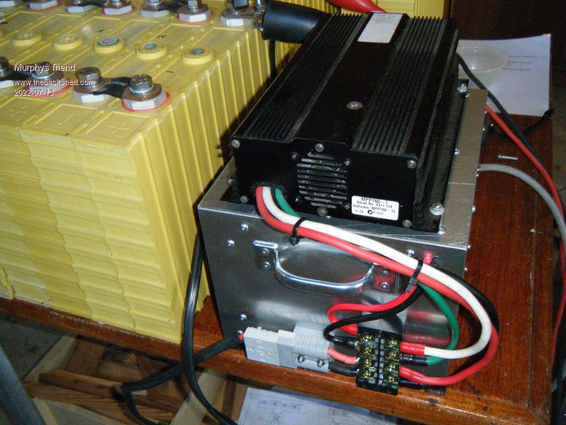

And this is the finished charger:
So, does it work? Much to my surprise, yes. I was worried the rather high ripple current I saw when I loaded the rectified secondary up might upset the MPPT input.
Apparently not so. I was running the generator to charge my spare 48V battery bank via this charger. With 1KW charging power I saw around 7V ripple at the input to the MPPT. I will test this again to the full generator output on the next rainy day, when I'll try to charge the house battery bank with a big load on it.
The nice thing with this MPPT is its auto battery voltage adjusting, so it can charge 12V, 24V & 48V batteries without having to switch anything.
Nice for my caravan battery too, it has a 24V lithium battery.
