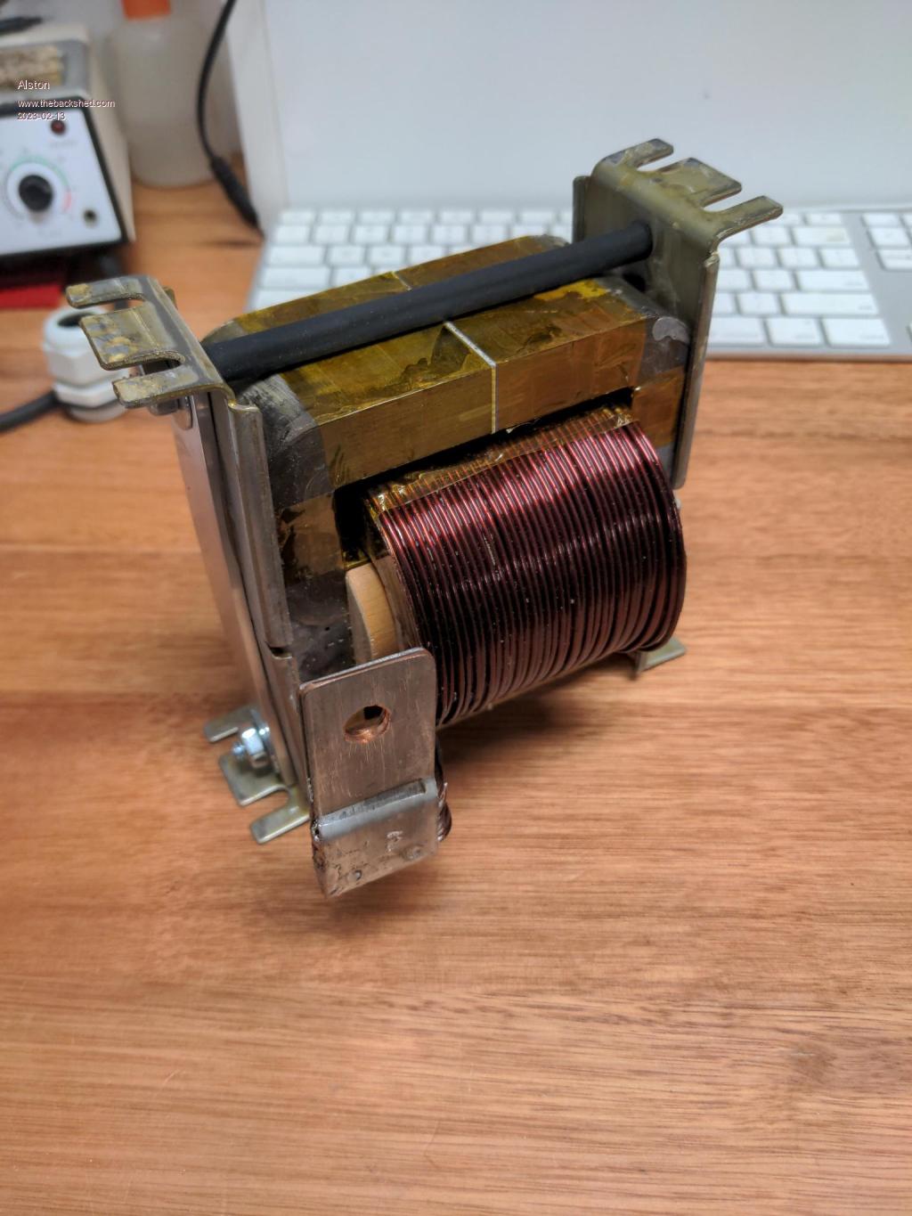

After a lot of work the transformers for my Warpinverter are all finished. After discussion with Warpspeed (Tony) he was confident in using IGBTs at 48v so I decided to do down that route (and Mosfets for the smaller stages). Looking at the curves of the IGBTS they exhibit much smaller voltage drop if you operate them well below their rates current and Tony said his experience with them has shown him they actually perform better than theory would lead to you to believe. Mosfets (if using the HY4008 at least) are cheaper but I managed to find IGBTs at electronic surplus supplier (who seem to sell ex mining equipment stock), so they were only around $45 each. I did find one seller on eBay who said they were genuine but once I received my order I could tell they were either counterfeit or second hand (the terminal look to have been sanded and there was glue ozzing out from the casing) so I sent them back and got my money back, the moral of the story being it takes some careful shopping. I also managed to find some muRata DC-DC converters from a surplus place in the UK and they are happy to operate down to about 30v so that is what I am using for my isolated supplies. I designed some PCBs similar to Warps and my layout will be similar to his. Here is my progress so far:

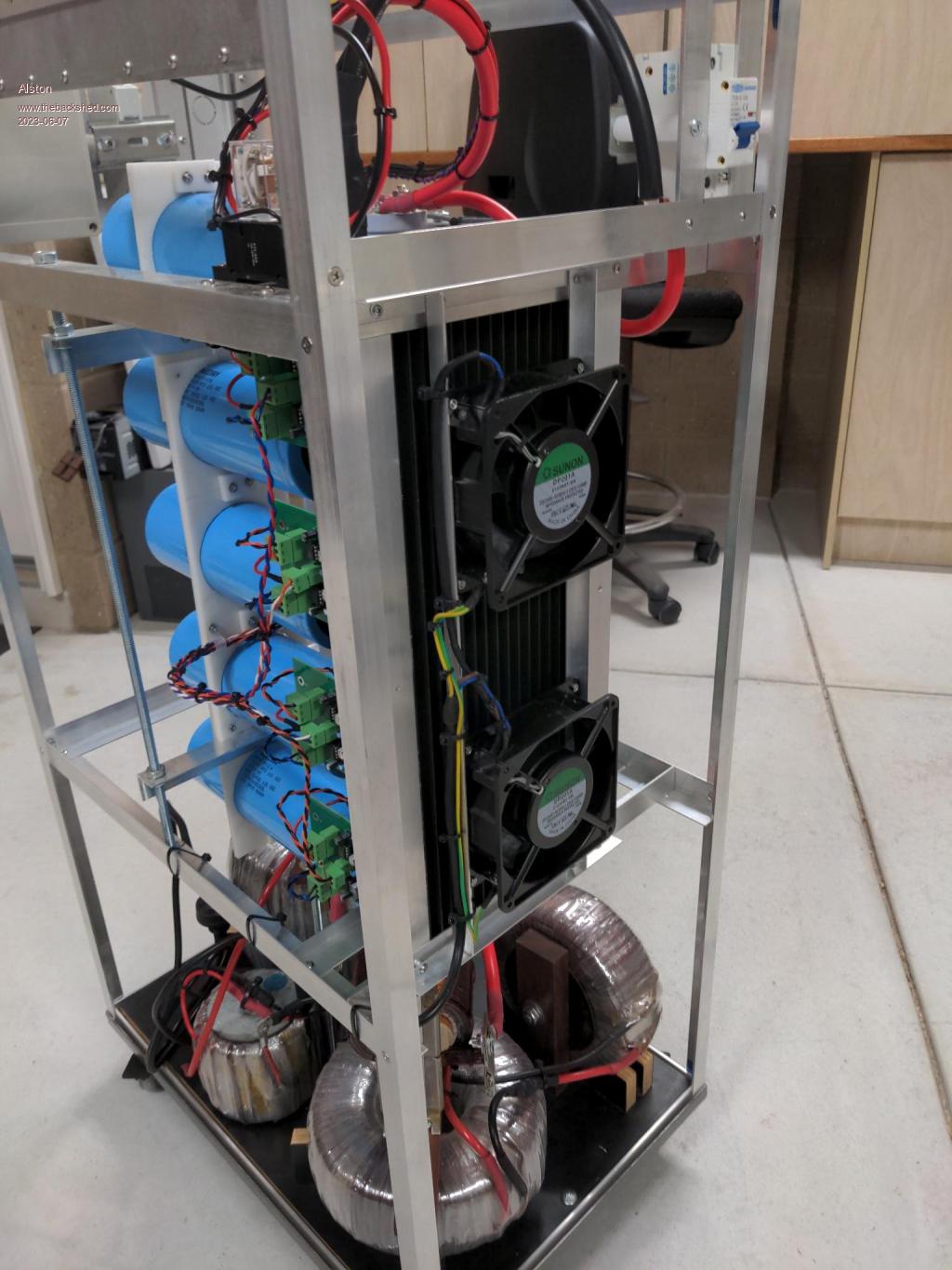

I have started on the enclosure and have gone down a similar path to Tinker/Murphy's Friend of using the lids from the Aerosharp enclosures to make the top and bottom panels. Here are the photos of the transformer mounting. There are 2 air intakes on the bottom of the unit that will bring air up through the centre of the 2 bigger transformers, as you might be able to see I have fitted fly screen on them. I have epoxied some rubber to the transformer mounts to cushion the wire from the clamps.
Alston
Joined: 04/04/2021
Posts: 63
Posted: 01:15pm 05 Dec 2022
The enclosure so far. My original plan was to mount the heatsink facing down with the caps standing up but that wouldn't sit into the footprint of the Aerosharp lid so I had to turn it sideways. This gave me the challenge of how to mounts the capacitors. I used threaded rod and aluminum angle to mount to the plastic support to which takes the weight of the caps.
Can anyone point me in the direction of the DC breakers they have?
Edited 2022-12-05 23:19 by Alston

Those big caps do make a challenging mounting, I like your solution.
Did my old eyes spot that you used 3off, 25 x 3mm flat bars in parallel for the cap bus bars? I have used a thin smear of "Alminox" at all contact surfaces of alu busbars to prevent future oxidation and thus loss of contact area.
I also used M8 bolts to attach the power cable lugs to these bus bars.
Just a minor point but that alu angle at the top of the heat sink (fin side) would allow more convection heat moving up if it was flipped over so its horizontal part faces away from the fins.

Your eyes are close, its 4 of 10x3mm flat bar. I have never heard of Alminox before but have done a search and found it. I will need to order some of that. I had considered the issue of convection but wasn't really sure how much of an issues it will be. I plan on mount 3x 120mm fans to suck air through the heatsink and vent out the side cover. From what you have said about yours heating isn't really an issue.
