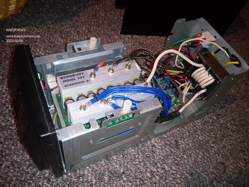

its hard to find large toroid trans in the US, but i did found these, only 500VA but cheap. i run two in parallel, handles 1500W with cooling, my loads dont go over that
https://www.antekinc.com/an-5415-500va-15v-transformer/

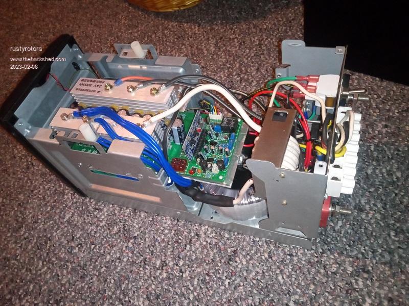

i used an aliexpress sunyima 3kw egs002 inverter board, which quickly blew up all its caps and most of the fets on its first test load. thats when i discovered posts on here about the egs002 over current protection bugs. I removed U4, shorted C19 and C24 to completely disable overcurrent protection. also increased the deadtime to 500ns, the idle current seemed to be a bit lower than the default of 300ns. I replaced the 1000uF caps with biggest i could fit on the board 4700uF. the only current protection now is 15A breakers on each 115v output legs

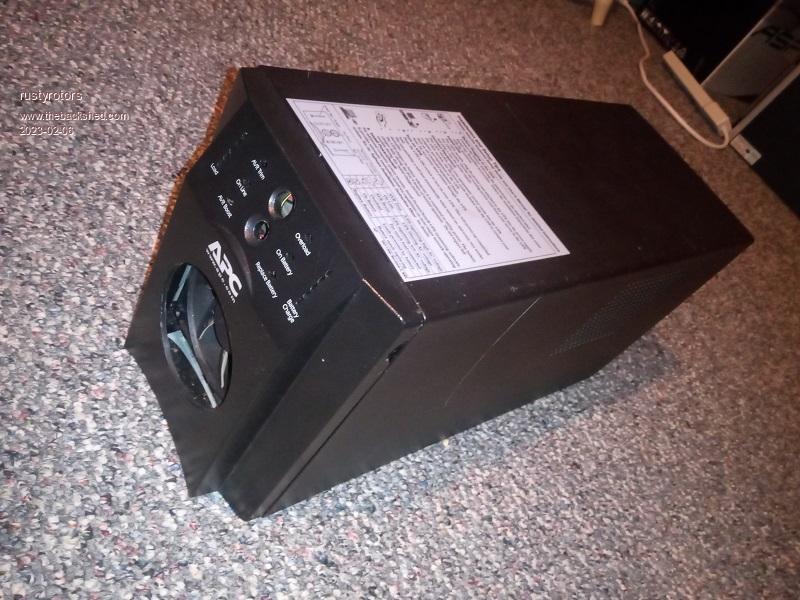

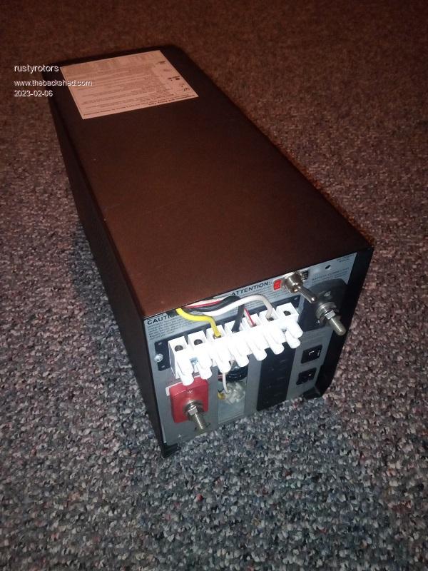

the choke is a E65/32/27-3C94 core with 1mm gap and 6.5 turns. more turns would drop idle current another watt or so, but also seemed to add wiggles to the sine output, so left it at 6.5T. i measured a little over 100A sat current and about 30uH. it resonates around 90hz with a 2.2uF output cap, idles at 14W with the fan running. i used an old APC ups case. it has been running my house for about 6months now no issues, very reliable, and cheap! all in only cost me about $350 in parts
i read a few others had issues with a wiggly sine output. I noticed a potential cause is a buzzing choke, i got rid of the buzz by adding tape as pad around the choke where it sits in its clamp, and wiggles went away
i have a question about fet gate resistance.. i noticed on the sunyima board, they have a single 4R7 resistor in parallel with a reverse diode, a 10k pull down, then branches to 6 mosfets. I understand the 4R7 resistor limits current from the gate driver and slows turn-on time, and the diode speeds up turn-off time, helping prevent  ringing and shoot through. But does the diode not overload the IR2110 gate driver when gate switches off, since current not going through a resistor? or does the IR2110 internally limit current? what about using something like a TLP350 driver, which is rated for 2.5A max, would a reverse parallel diode overload it? my old aims board uses TLP350 and has 47R on each fet gate, but with no reverse diodes

I like use of the APC UPS, re-housing the inverter, it turned out quite neat and compact.
