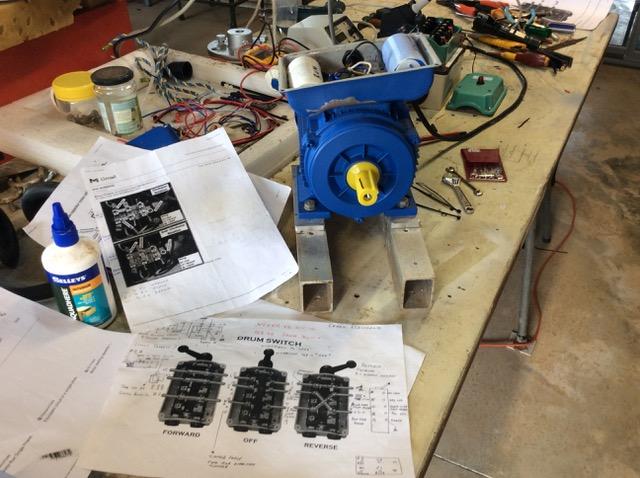

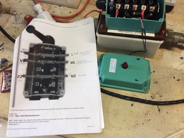

This is the Drum switch and some idea of connecting it to the terminations on the motor . The motor requires a cross-over of active and neutral , so this arrangement ,plus a couple of extra links , are required on this drum switch top termination hardware- There being ,in my case, raise - off. - lower .   I added a neon to show Power is on ., on the lid cover ,the green cover.
Here I show the new motor , a Vevor VS  802-4  ,
The Drum switch is a QS 60 , ( on the internet), most of my stuff is sourced from the searching the internet. The motor came from aliexpress. Plus the drum switch - unfortunately,
I did not realise no circuits ,drawings, information at all , came with switch and motor,  sad.

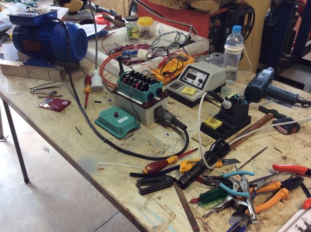

Pic showing my 1 mtr length of 7 conductor trailer lighting cable to a couple of waterproof cannon military plugs to disconnect the switch unit from the motor for storage ,when wind generator tower is up or down and in use or stored for maintenance.

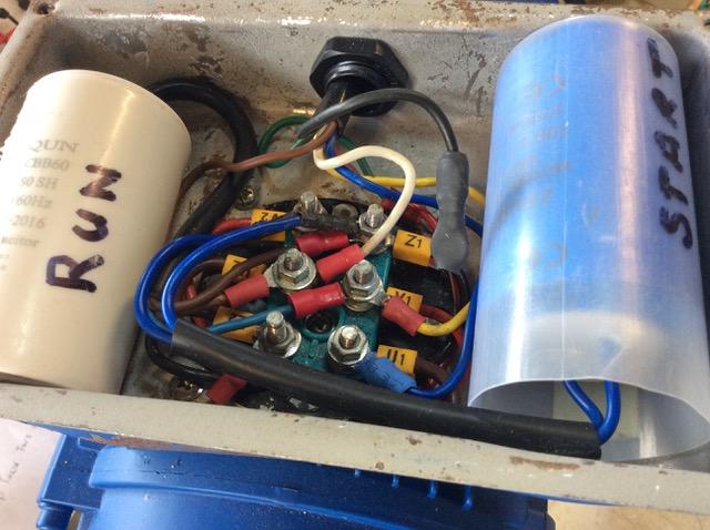

This pic is of the Capacitors ,start and run , and how they can be wired to this motor, they were wired from factory, plus links to run motor clockwise.  I have searched the internet and think I have it running clock and anti-clock with no discernible noise coming from the running.
In the end, through frustration, and after trying many many combinations of connections , I broke my law and used a live power probe to get it running . Some very gentle touching of the active probe , prevented tripped breakers in my workshop. 50 years does teach you CARE.

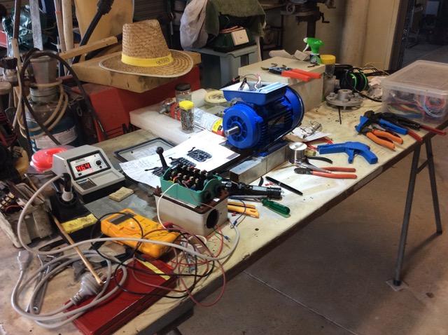

This was a pic of when I first started on the project, things have been moved around a bit . I take a long time to get things done.

Been busy with things, had a look at a roller door motor and it is reversible by a pair of relays on a circuit board (and some other electronics) but has a run capacitor only.
Bruce,  The diagram Godoh posted, page 8 should be mostly the same as your motor with the start and run capacitors, should only need the wires for the start winding switched?
If the motor is running rough, it might be the run capacitor not connected or working properly.....just a guess.

The basics of a single phase cap start cap run motor are.
The capacitors are in series with the starting winding, there is a starting switch that turns the starting capacitor off when the motor gets up to speed, leaving the run capacitor in circuit.
To reverse the motor the easiest way is to find the run winding and change the two leads over. Leaving the start winding as it is.
The switch will just change the relationship between the start and run winding. If the current flows one way through the winding it will rotate one direction, if you change the direction of current in the run winding leaving the start winding the same then the motor will run the other way.
Basically your are making the start winding either lead or lag behind the run winding. The position of the windings and the capacitors cause the windings to simulate a rotating magnetic field. If one winding leads the other then the motor will turn, if the same winding lags the other winding then it turns the other way.
