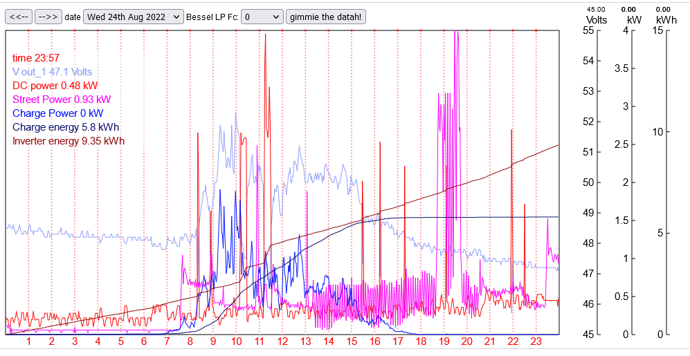

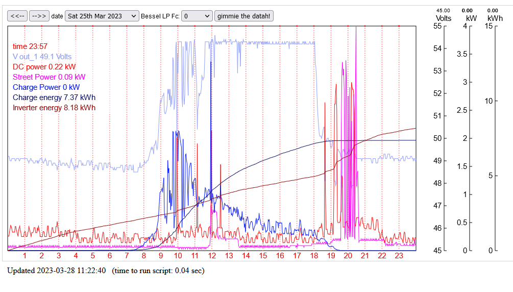

here is a typical sort of sunny day. cloudy in the morning.
8.1kW.hr was used by the inverter for that 24 hours  (Brown line)
7.4kW.hr was got from the panels and mppt controller (Dark Blue line)
We can see the battery spent from 12 until 6pm
in absorb mode, where there was more than enough solar
power to keep it there.

Where I live we have a lot of cloudy days. That means peak panel power
will never occur.
here is a cloudy day:
there was not enough sun to even get the battery to absorb voltage.
The inverter used 9.3 kW.hr
only 5.8kW.hr could be got from the sun
No point in having 200Amp capable wiring and controllers when the
power is not there.
But, it's very good to have as many panels you can get
helping with the charge since they are all running at
a small fraction of rated peak power.
