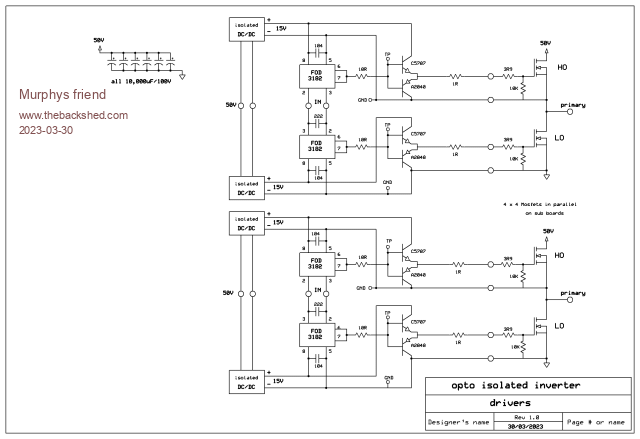

Mike, as you know I built my nano inverter to your design, using opto isolated half drivers & half bridge PCB's.
People here, smarter than me ,  keep mentioning with regard to chokes to put them into the high side input to the primary.
Now, looking at my built and schematics I see perfectly (electrical) symmetrical output PCB's and for the life of me cannot see which side of the primary is the HIGH side.
Remember, this is for an OPTO isolated driver, not poida's design.
Reason for asking (my inverter works fine with one big choke BTW) is that keepit mentions adding a powdered iron choke at the HIGH side improves performance and I would like to try that.
So, if you know of an easy test to figure out which is the high side (without blowing things up ) I'm all ears.

just in case the above is not clear, here is the driver's schematic:

The choke can be put on either end of the primary output.
I tested both sides, with a current sensor and the DSO to see if there
was any difference. There was no difference in the current.
I saw no difference in output waveform or idle power.
I think you might have a misconception with the high side and low side
being one or the other primary winding outputs.
in one 1/2 cycle one output will be ground (I call it V1) and the other (called V2)
will output a 1/2 sine wave from PWM pulses of the DC input voltage.
Then, for the other 1/2 of the cycle, the outputs are reversed.
This means V2 will be pulled to ground and V1 will output PWM pulses.
There is no way to define either V1 or V2 as "high side"
They alternate being high voltage and ground at 100 Hz.

Thanks Poida. You are right, I likely confused the workings of your nano inverter with that of the inverters we built before that.
My reason for more experimenting with a choke at each side of the primary (2 chokes) is to stop the loud growl when I'm back charging via GTI input to my mini grid. One can definitely hear it when up to 2KW of AC power flow from the GTI. Otherwise this inverter is quiet.
