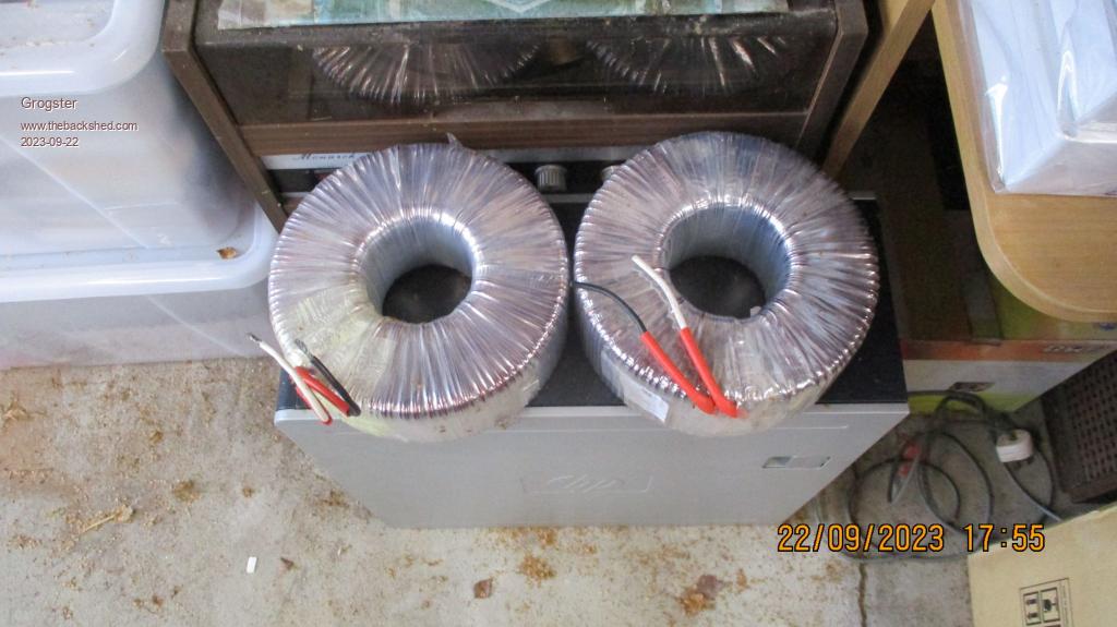

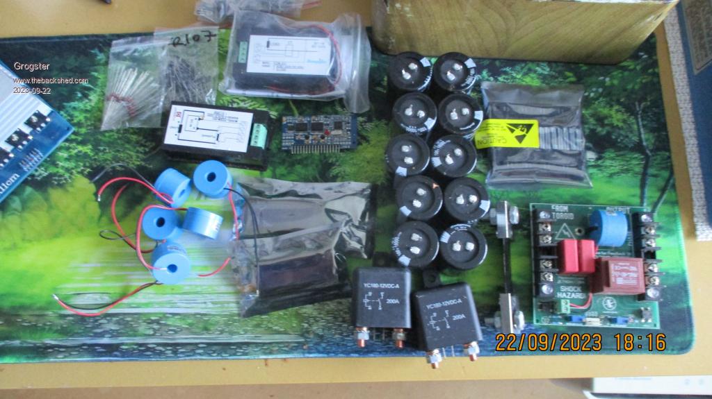

Hello everyone.
Here are the photos of what I have - I had more then I thought, actually.

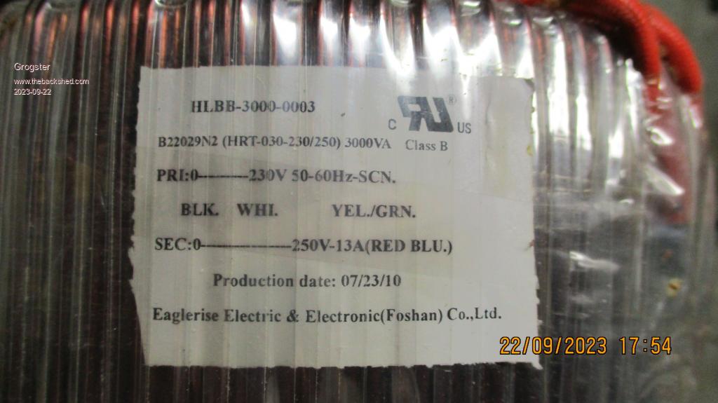

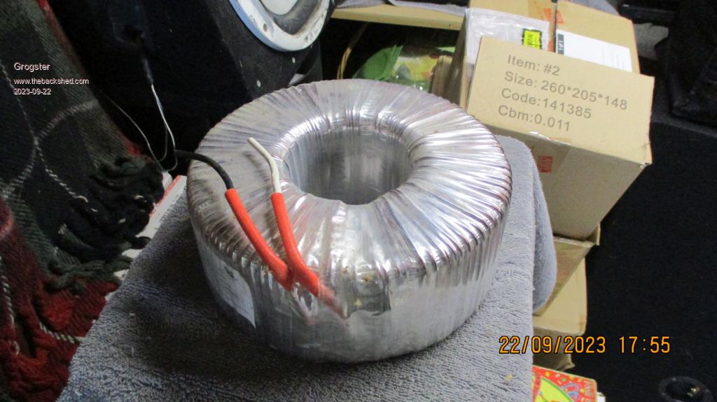

2x Toroids:
These only have ONE winding on them, so they seem to have had one winding removed already, and look to be ready to accept the chunky LV winding directly - I think.
3kW units, so good for up to 16A surge I would imagine - please comment.

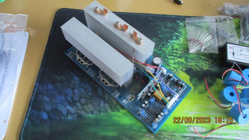

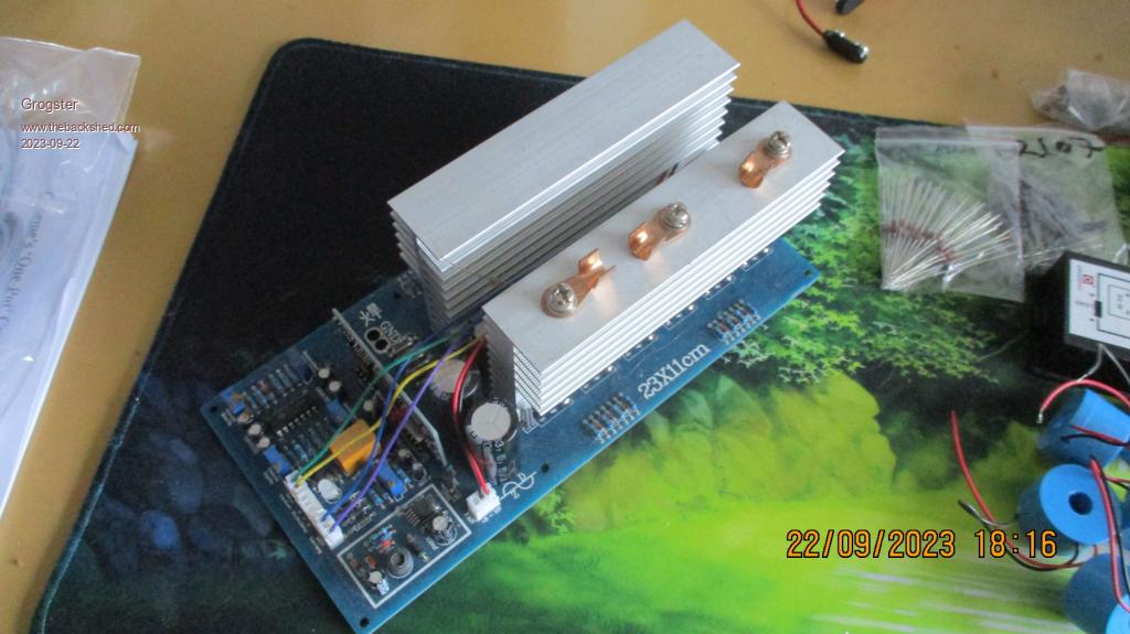

Pre-assembled inverter board:
As I understand things, as of NOW, this board is no longer a good choice, mainly due to lack of robust MOSFET gate drivers, and so the MOSFET's can pop without too much abuse on these boards.  I am currently researching the "Picoinverter" controller paired with a Madness power board as suggested in the other thread I was linked to.
Other bits:
Diodes, couple of LED panel meters, LCD panel meters, CT's, 200A relays, 10,000uF 100v electrolytic's, fusible-link, my attempt at a current and voltage feedback module, and a bag of twenty HY4008 MOSFET's.
The mission-critical thing is the toroid's, and so with those, I am hopeful I can try to build something that works for the modest power requirements I plan to have.
Any and all comments welcomed.

Posted: 07:25am 22 Sep 2023
  Quote  3kW units, so good for up to 16A surge I would imagine -
One Toroid will easily do that , with forced cooling you could get 5kva out of one
peek current would be more like 50A for 30>60 sec , its just dependent on the FETS in the inverter and battery assuming you do a 48v version.
There is nothing wrong in running a transformer worm especially in a cold damp environment.

Posted: 08:47am 22 Sep 2023
I don't see any choke core amongst the parts in the photo's.
Cheers Aaron

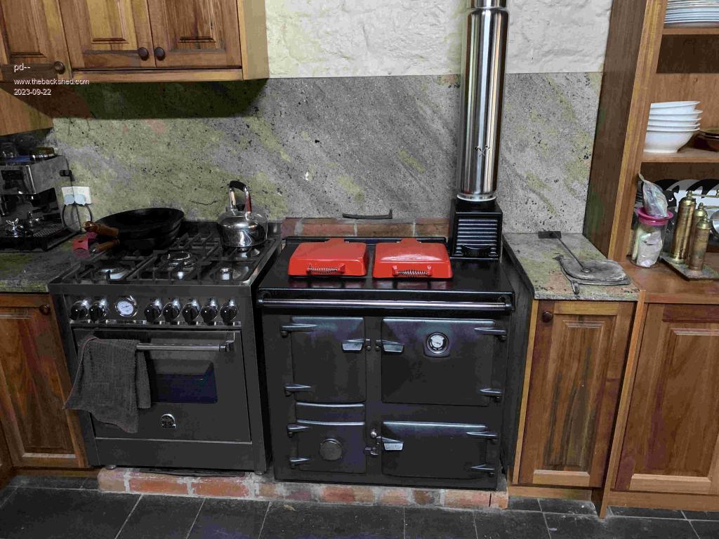

  Quote  I have not decided on the wetback thing yet
Long ago had a Rayburn stove / oven with a wetback. In that the wetback was the back of the firebox.
When it rusted out found a replacement way too expensive so replaced it with a slab of firebrick. Wood consumption dropped dramatically. In summer the hot water power bill also dropped.
It turns out this type cools the fire before combustion is complete so much of the wood was going up the flue as unburnt gasses and soot. When the fire isn't burning the thermosyphon continues, taking heat from the HW tank, wasting power.
The type to get is a pipe grid that sits between the top of the firebox and the hotplate. Instead of thermosyphon use a small circulating pump and check-valve to prevent reverse flow when the pump isn't running.
Another option is a flue heat exchanger. Can be added to any wood heater. Use circ. pump as above.
The electronics connection is the thermostat to stop - start the pump.

  Revlac said  I don't see any choke core amongst the parts in the photo's.
You don't.
Cos I don't have one.
I would welcome suggestions.

Posted: 10:38am 22 Sep 2023
A flue heat exchanger works a treat
Hear is a pic of our Rayburn with a axeman fireflue the HWS is behind the wall and above the stove.
