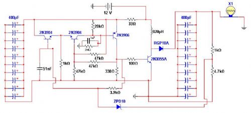

Just manipulating a general schematic for a charge pump capacitor taken from the web.
Charge pump capacitors generally increase voltage on the output side.
I am wanting to control the rate of capacitor energy discharge.
I changed a few things around to have roughly the same amount of volts coming in through the battery and the same coming out. Reality is, I loose 0.4 volts out of the 12 volts on the output side.
The main aim here is to increase the amps on the output side, using the caps as a sort of reservoir for energy while keeping voltage levels on the output close to the input levels.
The amps raised are insane, so I am going to have to change some components to suit.
Currently adding some noise filters and working on a dump for excess, so this really is a work in progress.

I really don't see what you are trying to achieve here. The 33ohm resistor serves what purpose? The 2N3055 has relatively low gain and requires significant drive current that does not get to the load. I see many low value resistors and this is not normally good. What sort of power does X1 require. [is this a fillament lamp?]
I am guessing that this is going to be some sort of dump load controller. The 4800uF @12V is not a lot of energy.
What would you consider insane amps?

...as for the rest, may I suggest you look up what is a charge capacitor, read my description above for voltage output levels for X1, including other details where I mention the need to change some components to compensate for the increased power levels and brush up on your schematic symbols at least of all things...cheers

Now that I am off my nasty pills , the 2N3055 transistor is indeed archaic and in need of replacement. Even the 2N3904/6's are miles too small to handle anything decent. I did mention earlier a need to improve capacity of some components.
The values of the resisters appear small, but are necessary in my view for the gates. I may need to strengthen them with some good ceramics or run a few in parallel during bench testing.
Basic concept here is using the schmidt transistor arrangement as a switch type trigger to move power from the source to the outlet...while increasing energy potential instead of increasing voltage output as is the norm.
The 33 ohm resistor in my view is misplaced by original author and more likely be moved to the 2N3904 input out of the direct circuit to the capacitors. Well picked up.
Capacitors on both sides act like a filling and emptying bucket scenario...one bucket (capacitor bank) fills, while the other empties. Both are neither completely full or empty at any stage.
I am open to any constructive criticism, thoughts and experiences regards to similar.

OK, I'll try! That left bank of caps. I can only see that they will hold up the supply voltage on the low power side of the circuit. Any charge they hold would only effect the drive to the 2N3055 via the 100 Ohm resistor.
Maybe it would provide some benefit at very low switching frequencies.

  CraziestOzzy said  ...as for the rest, may I suggest you look up what is a charge capacitor, read my description above for voltage output levels for X1
The use of X is normally associated with a crystal. The image you have associated with this appears to be a lamp. You have made no attempt to clarify this.
The normal way of controlling the charging/discharging of capacitors is with a constant current source/sink cct.
The cct you have posted above, is basically a voltage stabilised oscillator on the left. The output voltage sensed is used to control the oscilator to give duty cycle control to the 2N3055 switching transistor. This is a flyback voltage boost cct.
The fact that the voltage you measure is 0.4V lower than the battery indicates that the load is greater than the switching cct can sustain.

Gordon, I think you're missing the point here <grin>
Input at 12V, low amps. Output at 12V HIGH amps.
Clearly this is a major technological innovation. The author should be out getting a patent rather than publishing his OU device here!

I had read that aspect, but had decided this was not what it was about. I was thinking of trickle charging for a long time period with short burst discharges. I am still wondering about the insane amps and what X1 is.
I think that if over unity was being proposed that Gizmo would have stepped in.
