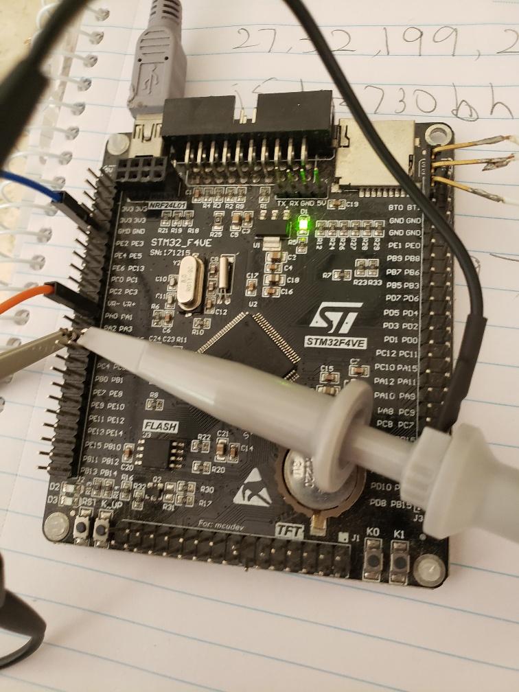

The board looks like this:
The code permits:
sample sizes from 256 to 4096
time averaging of the trace 8 and 32 scans
sample rates from  200Hz to 500kHz, resulting is FFT widths of 100 to 250kHz
sample averaging from 1 to 64 samples per recorded data sample (v. good to kill noise)
Linear, 10dbV/division and 20dbV/division vertical scale
A range of windows to choose from, I usually use "Flat Top"
see here to learn what window functions do
