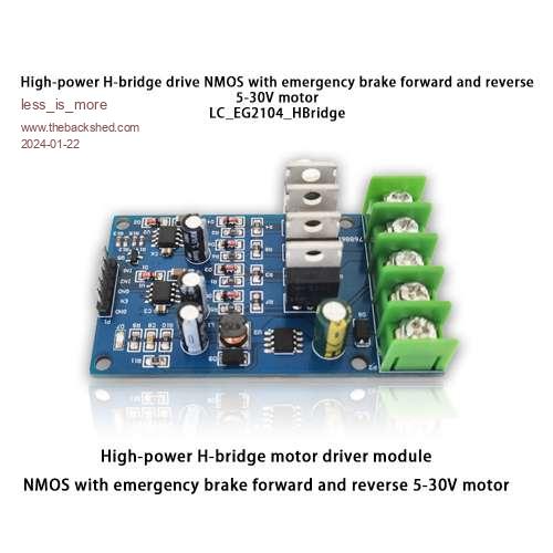

Looking for a ready to use power board, I found this on ali:
It has 2 half bridges with 3205 mosfets (80A max), and their respective 2104 drivers, a switching input for each half bridge, and a common enable input. Also found on the board is a XL7005 switching regulator, which  outputs 12V for the 2104 drivers.
Cost of the board was less than 10€ with shipping.
Only one half bridge would have been sufficient BUT has a very high current ripple. Two half bridges driven at 180º phase difference reduce this ripple dramatically. Furthermore, if the inductors of the 2 half bridges are coupled, you can decrease their size.

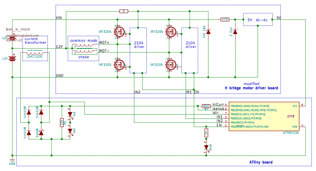

I ended finally with this simplified schematic
There are only 11 components on the additional attiny board, including the microcontroller.
      - 4 diodes to rectify the current transformer signal, one of them is a shottky, put on the direction signal to avoid it to dive below -0.5V
      - 2 resistors as current transformer burden. 10k to set the starting (Imin) level, the other one which can be disconnected sets the overcurrent shutdown (Imax) level.
      - Parallel to the fixed burden are 2 red leds in serie, this limits the voltage value below the attiny Vcc=5V, but let the signal grow above the 0.6*Vcc= 3V to be able to detect a high level.
      - A blue led and its limiting resistor are tied on the ENable output. This shows charging, direction is given by the blinking sequence.

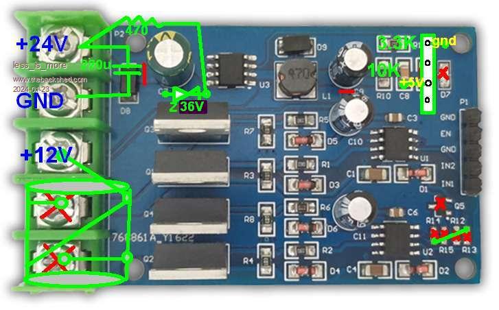

Footnote added 2024-01-23 22:06 by less_is_more
To be corrected on the circuit:
Zener diode on the 5V dc-dc is not 24V, but 36V

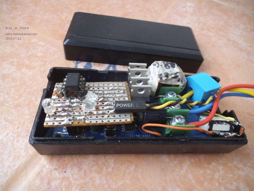

This is the resulting prototype.
It all holds in a 100*40*30mm volume. The plastic box is from a dead adaptator.
A little relay between 12V-24V has been added here, only for use on the car: this cuts the XL7005 supply when contact is off, shutting totally down the balancer.

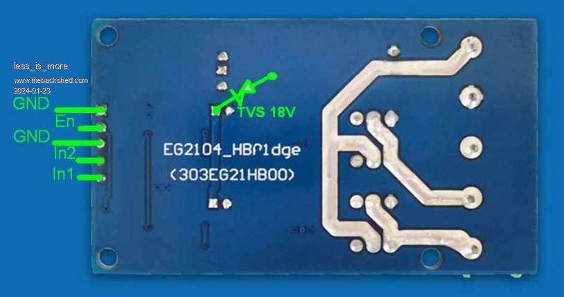

The powerboard has been a bit modified:
- a PNP transistor inverting the ENable signal and its resistors have been stripped to permit direct access to the 2104 shutdown pins.
- the 12V switching regulator has been modified to output 5V, its LED unsoldered to reduce consumption.
- the 2104 chips are now driven directly from the low side 12V battery.
- the MOT+ and MOT- screw PCB connectors are replaced by the common mode choke connected in differential mode to the 12V connector
      measured choke inductance is: 8mH , 33uH leakage
- added TVS/Zener protections on the 2104 driver supply and XL7005 supply
- added connector on the XL7005 unit to pass the 5V supply onto the attiny board
- added 220uF capacitor on 24V

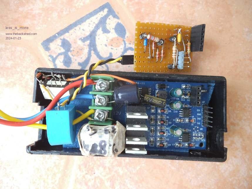

The control board is realized on a stripboard which holds on 2 powerboard connectors. Another little plug brings the current transformer signal.
The attiny has to be DIP8 on a socket. You need to remove it for programming, to do on a HVSP programmer because the reset pin is also used.
(the programmer can be made with a nano on a breadboard with few components)
This mounting did'nt give any problem mounted on the car, but is well maintained in the box.

First of all, I found some more errors in the circuit, here is the corrected one:
balancer_circuit_V1.pdf
