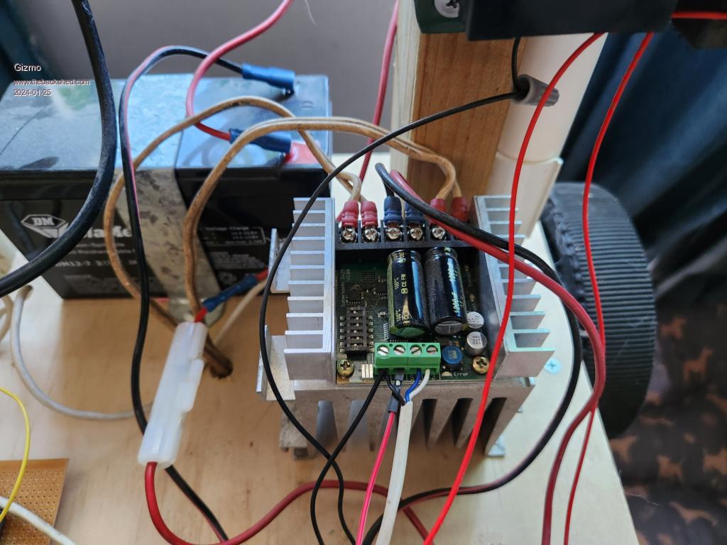

Well I blew up my motor controller for my rover/lawn mower project. And I was just at the point of testing the rover with its new flight computer. Bummer.
In short, I accidentally shorted the main 12V power feed, blew the fuse, but seams the motor controller chip didn't like it and now it wont respond. It was a Sabertooth 2X25 module, not cheap!
This was on my test rover. I did contact the manufacturer, they offered to fix it, but they are in the USA and it would take weeks.
After doing some research, I've decided to build my own. Here is what it needs to do.
Receive two RC signals from a flight computer.
Drive two wheel motors. Its basically skid steer, the two wheels do the drive and steering, a caster wheel goes for the ride.
I have a few spare ESP8266 D1 Mini modules, lets write some code, with a little assistance from ChatGPT. I find ChatGPT basically writes code that doesn't work most times, but it plants ideas in your head and gets you started in the right direction.
To drive the motors I could use a H bridge, as each motor needs to go in forward and reverse. H bridges are a pain, you need high side drivers, and I wanted something I could throw together this weekend. The rover spends 99% of its time going forward, so I'll just use a PWM driven MOSFET output stage and a DPDT relay to reverse the motor when needed. Its simple.

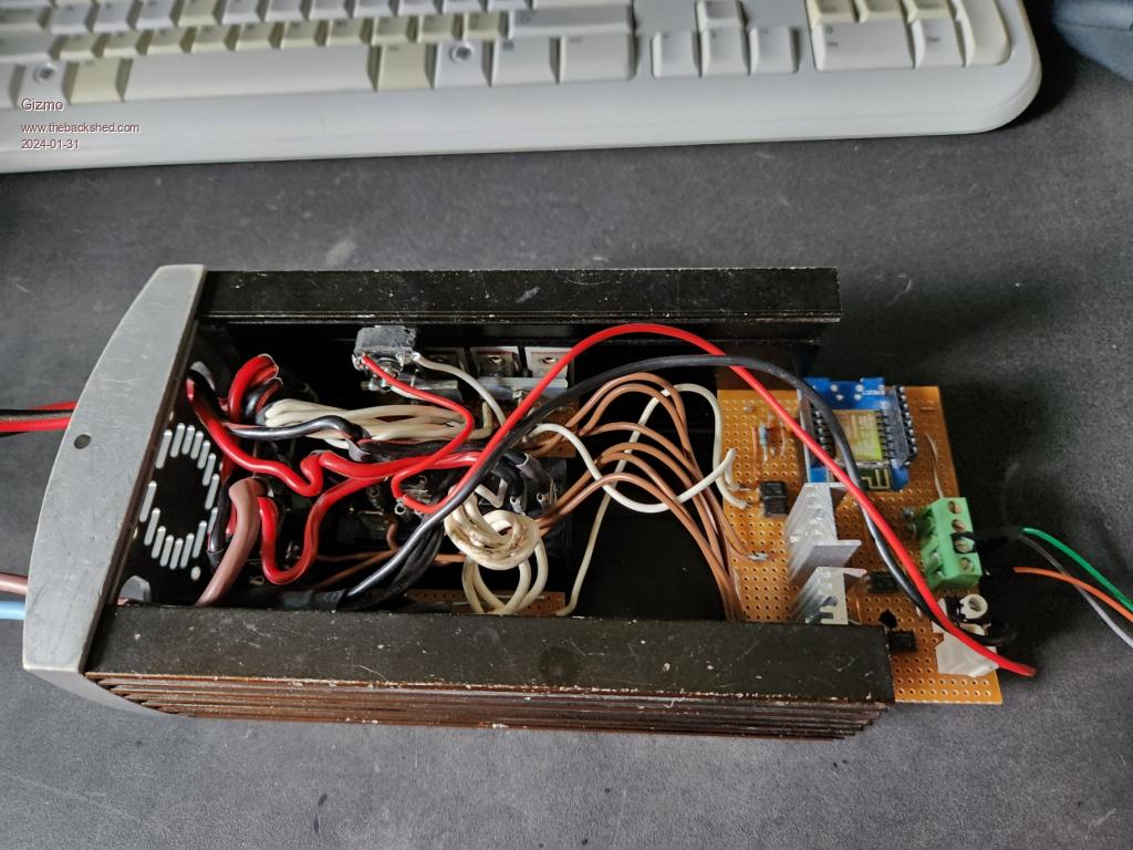

Posted: 10:51pm 30 Jan 2024
Built the electronics into a old battery charger case. In hindsight, I wish I had used a bigger box, its a bit cramped in there.
I'm using 4 MOSFETS in parallel for each channel, and 2 SPDT automotive relays per channel to do the motor reversing. I chose the auto relays because they are common and I can easily change the motor controller from 12V to 24V by wiring the coils in parallel or series.
I've added a web interface to the controller, so it creates its own wifi hotspot and I can use my phone to open a web page and change the settings of the controller. I'm going to add a switch to enable this feature only when its needed, no need to broadcast a wifi signal when its not needed.
More to come.
