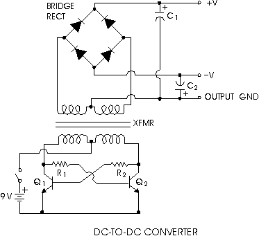

Good day,
|Well this morning I received 2 of the above meters. They
had a wraper round them saying that the supply voltage had to be isolated from the measured voltage/amps. Well as there was nothing in the advert about this I didnt think it applied. So I have read the gentlemans reference to this on this web and his way of getting round it. Unfortunatly I dont have a board with the requiered chip on it.I wonder if or how its possible to generate an isolated power for these things? Any assistance greatfully received. Arthur

Arthur
A simple multivibrator circuit like this could use the little driver transformer from an at or atx power supply, and a much simpler output bridge..... don't get much simpler than that.
Picture from above link
.........oztules

Arthur
Joined: 05/03/2009
Posts: 28
Posted: 01:50am 03 Apr 2009
Many thanks to you on Flanders Island, I had googled and found papers and circuitry that filled a double A4 pages, not what I was hoping for!!! I beleived you used a chip off an ethercard which I read some time ago but no card in my junk box. you have saved the day agein many thanks from the othe island.

Posted: 05:42pm 05 Apr 2009
You can make one as Oztules said. The transformer can be scrounged from almost anything, or just by a mini audio transformer from the local electronics shop.
Build the cct on vero board and drive each transformer till you find one that produces the results you want. The power levels are so low you would have trouble causing smoke.

Arthur
Joined: 05/03/2009
Posts: 28
Posted: 07:40pm 05 Apr 2009
Thank you have sourced a couple of snall transformers from
a p.c. psu which as Oztules should do the job, thanks, Arthur
