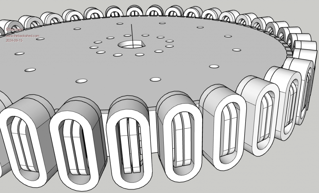

I'm just getting into and learning about microhydro and seen various generator types used, one of them led me here obviously but one other, I think a russian was sharing, it had all the same principles as the included image, except the two smaller coils I put inside the larger ones...
Would this work? I was thinking the extra coil configurations could be wired up to a multi input inverter..
Or would there be too much interference from the generation in the large coils?

I don't know much about these, the wind turbine guys would know better, where are they these days?
I think the small coils inside the other coils in that orientation wont be cutting through the magnetic field properly.
Is there any iron core?

I wasn't planning on using iron cores no.
Acrylic disk, n52's and thick guage wires.
I just think, even if the charge is smaller it can still be used and its an awfulwaste of space otherwise.
