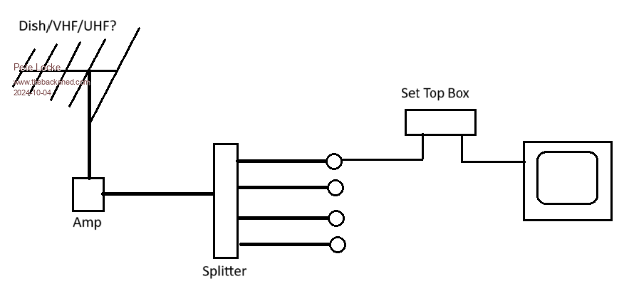

So your setup looks like this?
Where in the system are you seeing signal with your meter. I'm picking at the outlets?
You mention there is a set top box so digital TV signal?, is there one at each outlet as per the picture, or one common unit feeding all outlets?.
Has the system ever worked, or is it a new system that hasn't worked from the start?
If it's the latter, most common problem is the s/t box hasn't been set for the correct LNB (if it's dish fed) of correct for terrestrial.
If you can fill in some of the blanks, maybe able to suggest a few things to try.

Pretty much as per your pic Pete, all free to air so no LNBs etc.
Existing system that was working in the past, it's a fairly new house less than 5 years. TV reception would intermittently drop out, then went completely.
An electrician has replaced the amplifier and the customer replaced the antenna himself then called me in when that didn't work.
There are multiple TVs in the house not getting channels plugged straight into the socket. The set top box was a spare I had in my office that was pre-tuned to the local channels, tried it just in case the TVs were faulty. Set top box didn't get anything in the house, swapped the lead over to my signal meter / mini-tv and I'm watching TV with a 57% strength and 99% quality rating. ( I realise that percent isn't an actual unit, but point is it was above marginal. ) Took the set top box home and it worked fine (same tower).
Usualy I would just fault find going from the antenna down with my signal meter, but problem is it is showing that everything works and getting a picture. Just the four other tuners (TVs and set top box) aren't, one of which I know 100% works.
My current best theory is there is some sort of cable damage which is not a complete short or OC which is changing the impedence enough to be out of spec for the TVs, but my signal meter has more tolerence.

  ryanm said  The amplifier / splitter setup is far enough from the manhole that I will have to take a packed lunch for the trip so I'm trying to at least get a working theory before I go up there.
That's the next step, just not looking forward to the climb. Amplifier and power supply are co-located in the ceiling space and have been replaced by the electrician. I get a stronger signal at the wall sockets than I do straight from the antenna on the roof so it's working.
