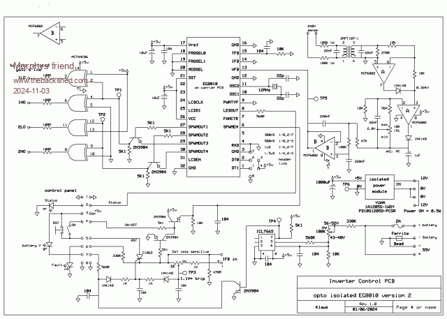

This is with my spare 6Kw inverter I am presently experimenting with.
When I spotted wiseguys neat AC voltage regulation idea I had to try that . That little 1:1 voltage transformer module would fit neatly directly onto my control board.
So I made two almost identical control boards, the difference being that one uses the EG8010 and the other Poida's Nano (with the 'no bessel' program).
These boards can easily be swapped about in this inverter.
Both boards give a very clean AC wave and the idle power is now only 19W for this 6KW toroid.
However, having the AC voltage adjusted to 235V at idle, as soon as I load the inverter the AC voltage drops progressively, as much as down to 210V with a 4KW load (heaters).
This voltage drop happens with the EG8010 *and* the Nano board.
Here is the EG8010 schematic, voltage feedback is located in the top right corner.
Any suggestions as to why that poor regulation are welcome.

Klaus try putting a 47p - 100p capacitor - with relatively short leads less than 10mm long between pins 5 & 6 of opamp A and retest. If problem is still present add another 47-100p between pins 2 & 3 of opamp A and retest. Hopefully one or both may do the trick. Did you use a ground-plane on the PCB ? Noise pick up on pin 6 & pin 3 of the A opamp is fairly sensitive to long traces or and no ground-plane. Good luck !
Cheers Mike

I would test the Vfb circuit to ensure that TP5 increases in DC voltage
as the AC voltage increases going into the small feedback transformer.
and
Maybe watch Vfb (with the volt meter, with the meter's ground connected to
the control board's ground) rise to about 2.5V as it outputs 235VAC, and then
as you apply large AC loads, note Vfb.
In the case of proper closed loop control, Vfb should remain stable
and be 2.5V at idle AND when under load.
(the 2.5V might be 2.7V or something else, no matter, it must remain stable)

I did try wiseguy's capacitor suggestion today, no joy, if anything it made the regulation worse (down to 195V with the same load).

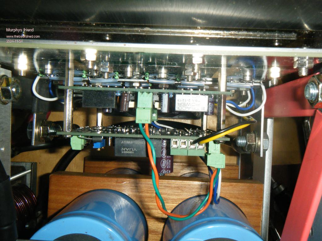

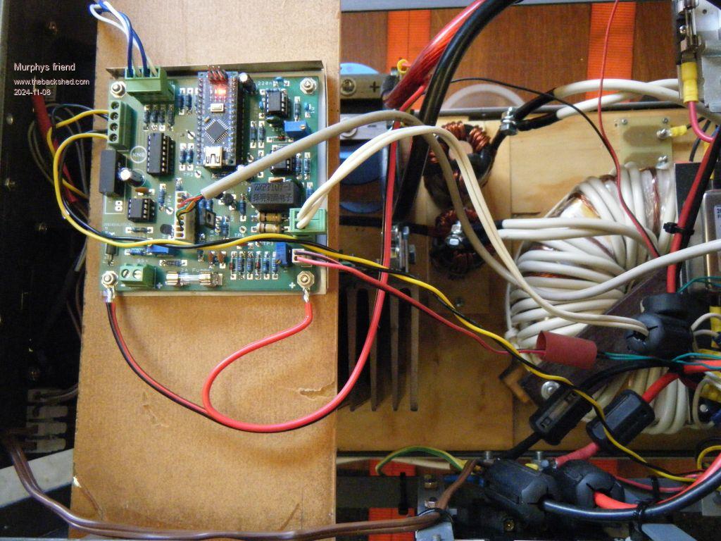

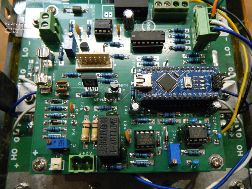

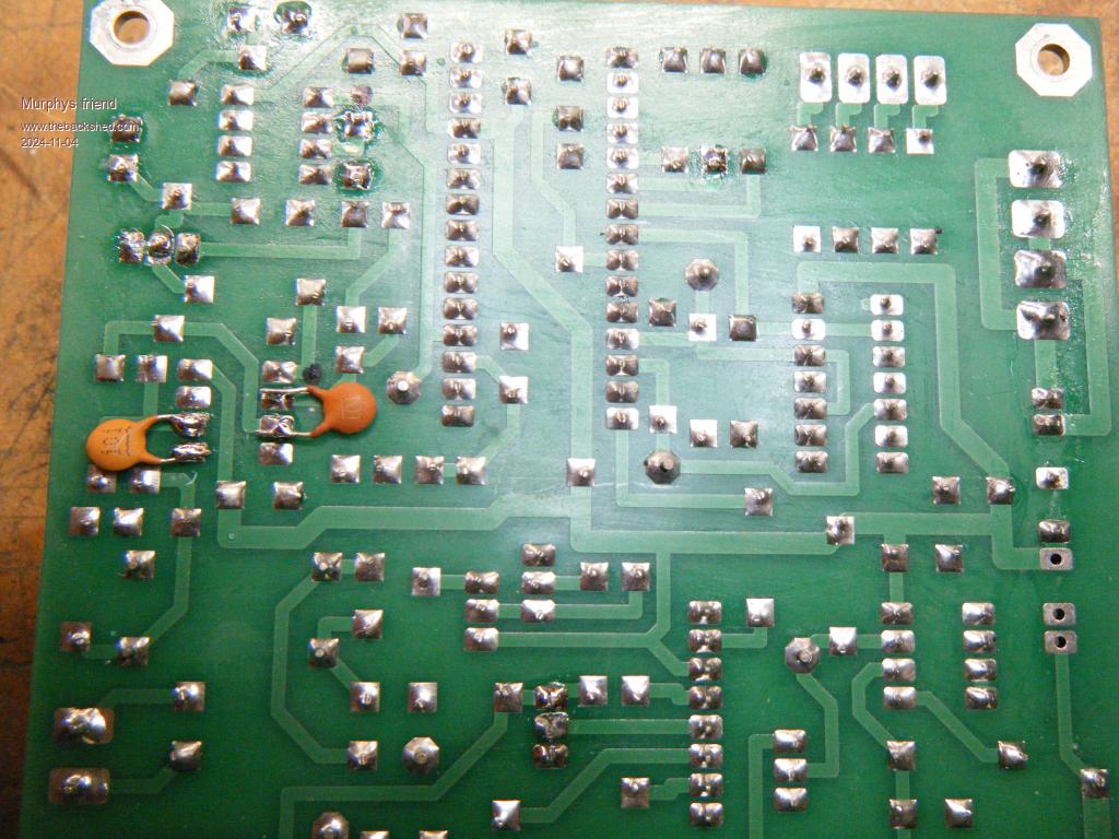

I shall try measuring the Vfb as poida suggested tomorrow. Meanwhile here are some more details:
The PCB has a ground plane on the component side. The AC voltage is sensed at the toroid winding connection, before any filtering.
A picture of the control board:
And the other side:
And here is how it is located:
Looking down into the inverter, on top of the picture is the heatsink with the power board attached. The driver board is piggy backed onto this with short spacers and the control board on top of that on longer spacers.

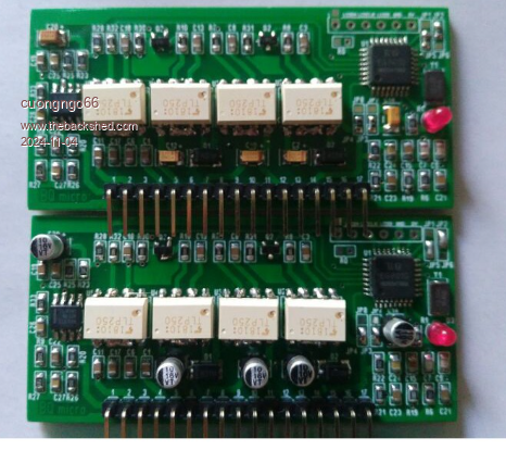

can you help me how to read peak - peak voltage like eg8010, i have read a lot of your posts and codes and followed on stm32, the sine wave generated from your code is very nice, i am having trouble in reading peak voltage for feedback

Hi Poida, thank you for replying me, currently my circuit is coding unipolar spwm method, for 4 outputs, I have 4 tlp250 opto, the output sine wave 25khz is very good but I still can't handle the feedback part, can you help me with a circuit using op-amp to measure and then put it into the microcontroller?
because i want to design my own circuit board like egs002 can be interchangeable

OK, just did this measurement, the Vfb is rock steady at 2.76V at the TP5 post for AC loads from 0W to 2910W.
Here is the AC voltage drop listed:
idle: 235V
135W: 234V
500W: 231V
1780W:223V
2440W:209V
2910W:196V
So, it's something else that's causing it, but what?
I did reconnect the AC voltage sensing to a filtered AC output.
Also. one choke connection which ran close past that little sensing transformer is now a fair distance away.
The dual stack transformer core came originally from my scrapped warp inverter which was wound for a 225V secondary. To this I added 20 turns to keep the flux density well under 1 Tesla at 235V.
The new primary to secondary ratio is 1:9
Any clues are much appreciated.

Could be the winding ratio, if the Nano code you are running had the code for %PWM display, that could tell you if it was a possible transformer winding issue.
You could try setting the AC output to 196V and then run the same load test, if the voltage stays close to 196v from idle to 2900W then it might also indicate a transformer ratio issue.

I suspect I may have had a 'senior moment' when calculating the transformer turns ratio . The calculated flux density is 0.96 Tesla.
Can somebody please confirm these measurements are correct for a 48V inverter:
Powering the output winding with 235V AC I measure 26V AC at the input winding.
Everything else was disconnected from the transformer for this test. The magnetising current was 136mA, this is about right for this 6KW toroidal core when compared to my other 6KW inverter.

  Quote  for a 48V inverter:... output winding with 235V AC I measure 26V AC at the input winding
= 9:1
  Godoh said  Mine are all 24 volt.... 13 volts Primary and 240 volt secondary.
= 18.46:1 So that appears to match ok.
Perhaps the PWM is constant, not responding to feedback at all. Can you check with a scope?
Un-plug the feedback op-amp and feed a voltage into TP5. Start at 3V and slowly decrease to 2.5V. AC output voltage should rise.

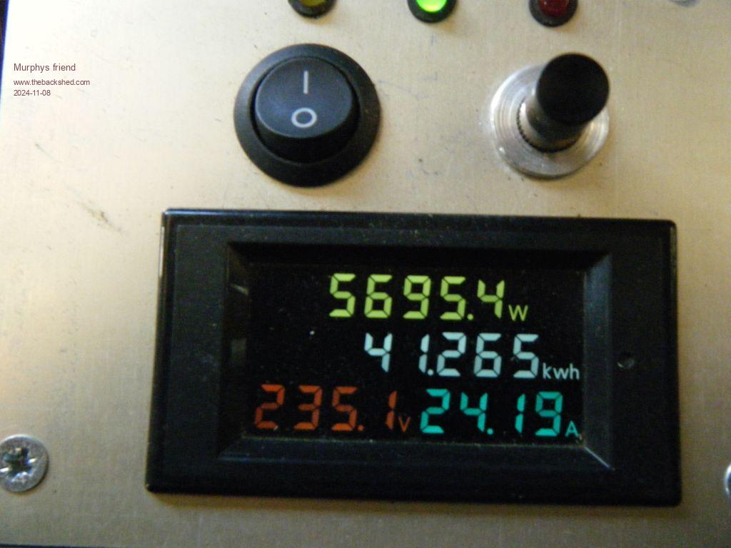

The only problem I perceive is as I described initially, noise pick upon your first "A" opamp.
  Murphy's friend said  I did try wiseguy's capacitor suggestion today, no joy, if anything it made the regulation worse (down to 195V with the same load)
To my mind this also reinforces that we are in the right area for the right reasons but with the wrong cure tried first, causing the issue to be worse.
I thought adding the capacitors might help, instead of having to add a faraday screen.
That is a piece of Aluminium plate between the Power drive board and the controller PCB/s. Dex had exactly the same issue with his inverter and it was solved 100% with the screen. The capacitor was an untested guess which should have helped for filtering fast witching spikes (in theory...). 4 more 10mm hex spacers and a metal plate is all thats needed.
I have looked at your schematic and I think there may be an issue with the link on the corner of the PCB with the ferrite bead, which appears to be the battery negative power supply return wire for the PCB. I normally connect the battery feed wire via a single connector pin direct to the ground plane. If you put a sheet metal screen plate under the PCB the Ferrite bead needs to go! The ground plane of the PCB must be solidly coupled to the metal screen plate, the bead places HF impedance between the two. If it has to remain as the battery connection just use a wire link without a bead. I would choose to place a 10nF MLCC capacitor instead of the link, and supply controller power via the -55V node shown on the schematic or other similar connection to the ground-plane.
The schematic shows what appears to be a +/- 55V source to something else which is for what ? Best practice is to power external stuff directly not via the PCB. I always have only the one DC coupled negative connection to the battery minus for the controller and that would be at the point that the Battery negative connects to the chassis or to the Power PCB negative point. Its only function is for the miniscule power the controller needs and as a return sense wire for the battery voltage measurement.
Another good thing to do with floating Cmos nodes in a dual opamp in a noisy environment is to tie them somewhere. I would tie pins 6 & 7 together on the unused "B" opamp and ground pin 5 so its function is as a voltage follower which is now referenced to ground.
The reason why your other inverters did not have this problem as I perceive it is because they did not use an active amplifier/rectifier in the feedback path, which does have some nodes that would be sensitive to noise. Some copper foil a bit bigger than a larger postage stamp and soldered to a couple of ground points covering the sensitive nodes & traces might sort the problem out without making a full metalwork shield. - I never envisaged that a controller board would be placed/bolted in such close proximity to the power section in a build.
The fact the feedback voltage is rock steady I submit means the feedback voltage & servo loop is operating perfectly. If the output volts are falling but the feedback is fine and rock steady at 2.76V that is because noise is being picked up by the Opamp "A" on your PCB and added to the feedback signal. As it is now artificially at 2.76 due to feedback + noise injection then the PWM reduced the output voltage so output voltage + noise was equal to 2.76V. Simple huh ?
  Murphy's friend said  Even if there was a display, my geriatric brain might find it difficult to fully grasp the meaning of % of PWM or idle duty cycle
Servo loops do play with your head a bit and cause you to question your sanity especially when trying to interpret what is cause and what is effect
I can't be of much further help as I have no idea of your physical implementation of the PCB track lengths etc. But a shield plate grounded to the PCB ground-plane under the controller should solve the issue. Mounting the controller a bit more distantly from the "noise" would assist, the opto drive signal cables can easily withstand longish runs.
With regard to AC voltage stability/accuracy the best place to connect the voltage sense transformer IMO is downstream from the toroid - as close as possible to the final AC output, that way most voltage drops through filters etc are compensated for. But definitely before any switches/relays etc that would remove the ACV sense wires from the Toroid AC output or that would lead to max uncontrolled AC voltage at 100% modulation - a really bad plan.
Edited 2024-11-08 10:02 by wiseguy
